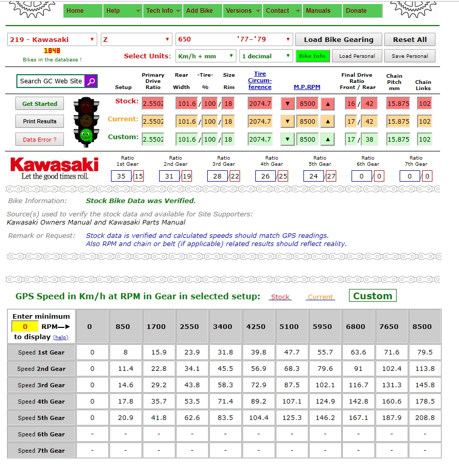

6K at 90KPH is way too high, change your gearing.
I made so much more power than stock with my 831cc bike that I had to change the gearing. Your probably about 10 HP down from what I have, I had to change gearing because I could not shift out of first fast enough.
I run a 17T front and a 38T rear, at 90KPH it revs at 4,000.
If you have enough HP it will pull strong in any gear.

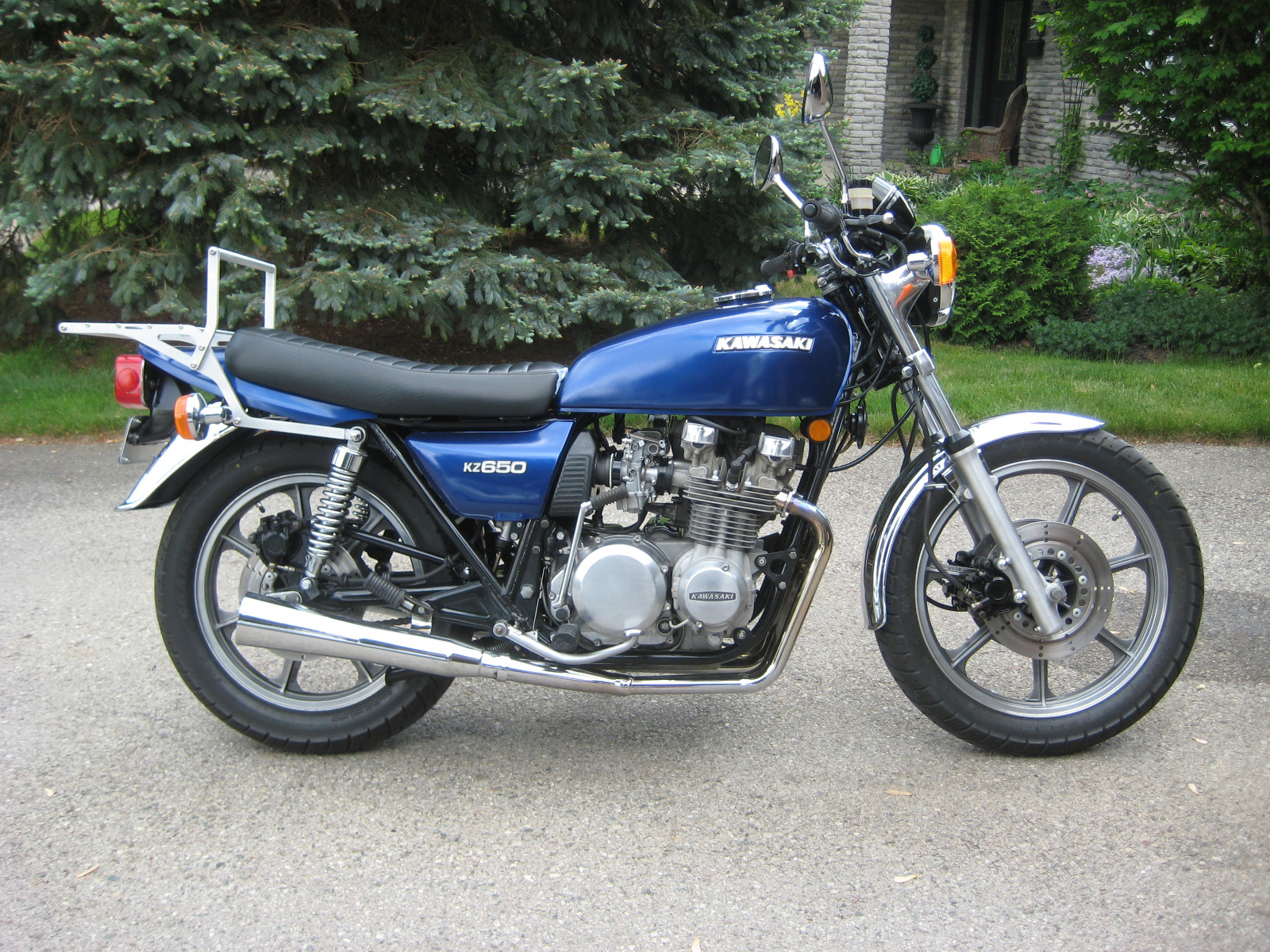

1978 KZ650B2 modified project

This is a useful site to work out sprocket ratios for your set up and wheel size
Gearing Commander - Motorcycle Speed and Drive Train Calculator v7
