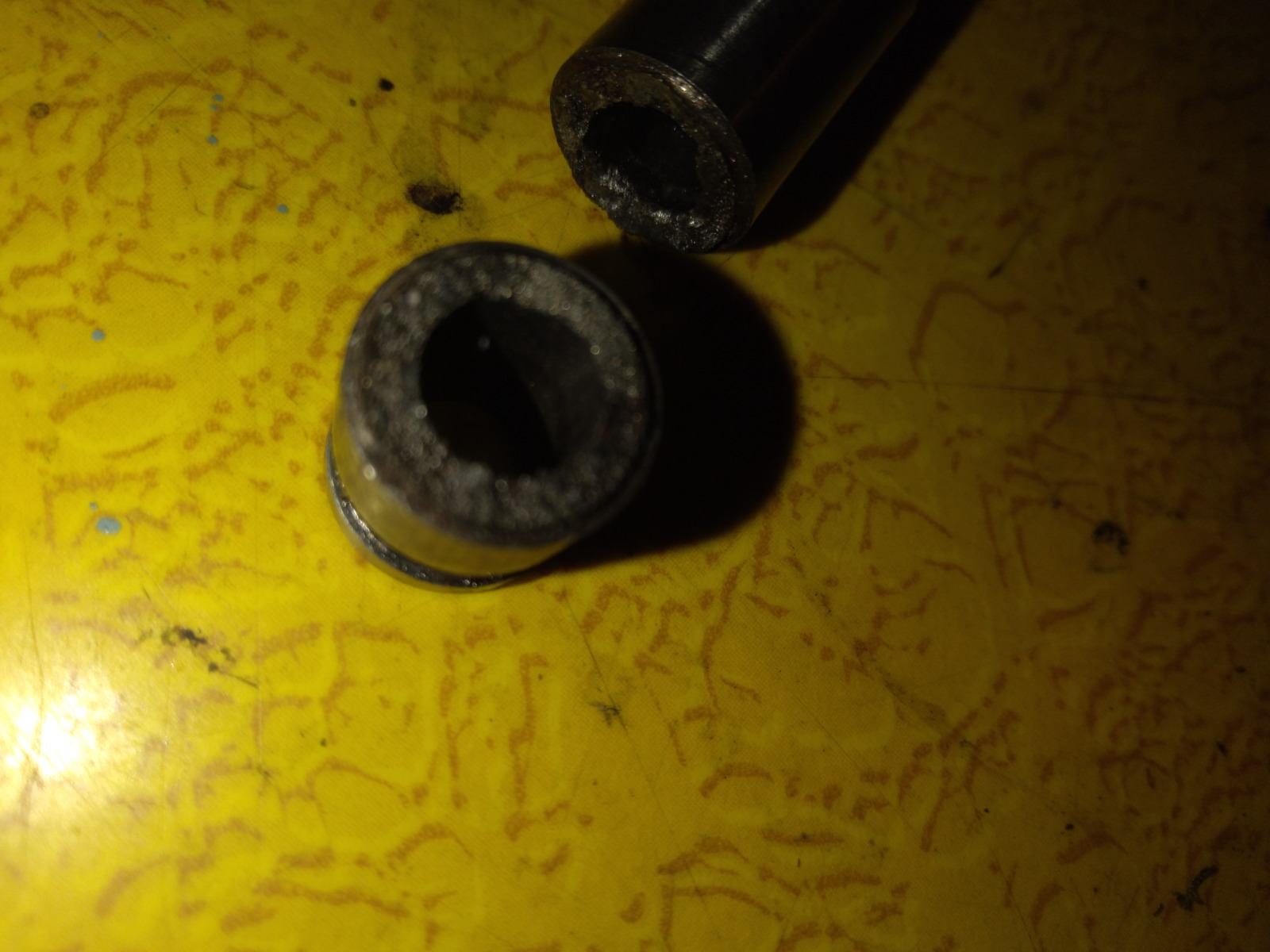

much time was invested simply learning as much as possible prior to jumping into anything
not blessed with $ and/or correct tooling, can hardly find $ to buy these parts
let alone having to order/buy the same part over and over again due to botched installs
made my own tool, lol integrating previous failed guide parts into the tool.
stem of tool goes entirely through guide but does not protrude
put new iron guide on ice in freezer and head into grill for 20 mins
tried to be well prepped so it wasn't a goose chase after taking head out of grill
did not go at it like a wild man wielding an axe
started in fine, and was going in fairly smoothly, only moderately but squarely rapping with hammer
rapped 3x and snapped right at circlip
feeling the agony of defeat at this point
however, i'm refusing to bend a knee here gonna order bronze guides and just hope for the best install ever
if these fail on install, I will respectfully just walk away and never return to that arena again lol
my neighbors must all think I have turrets syndrome or something lol from all my flippin' out, flying wrenches and cussing like a sailor! lmfao
are bronze guides as brittle? thanks for listening to my ranting, the struggles are real

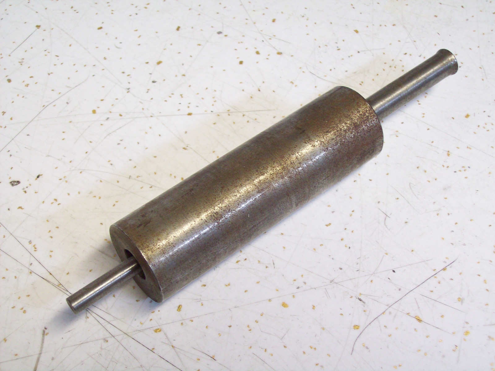

Here is the valve guide installing tool my machinist made up for me for my Kz1000 heads back in the '70's. The holder drops into the valve spring/bucket cavity then the driver is inserted down through the holder. That way you are always installing the guide perpendicular to the valve seat. I heat the head up to 250 degrees or more. Put the new frozen valve guide into place. Drop the holder into place over the guide. Put driver into place. Then tap with hammer to you hear the sound change. That means you have bottomed the guide up to the locating circlip. With the heated head, and the frozen guide it only takes a few taps with the hammer to get the new valve guide into place!!!!

25 Oct 2022 14:14Here is the valve guide installing tool my machinist made up for me for my Kz1000 heads back in the '70's. The holder drops into the valve spring/bucket cavity then the driver is inserted down through the holder. That way you are always installing the guide perpendicular to the valve seat. I heat the head up to 250 degrees or more. Put the new frozen valve guide into place. Drop the holder into place over the guide. Put driver into place. Then tap with hammer to you hear the sound change. That means you have bottomed the guide up to the locating circlip. With the heated head, and the frozen guide it only takes a few taps with the hammer to get the new valve guide into place!!!!
Haven't seen that sort of tool, but that looks like a brilliant fabrication and an effective one.
Rob (zed) also has a really cool fab'd tool for this as well. I certainly like the way yours doesn't mess with anything that's self centering on the seat area though.

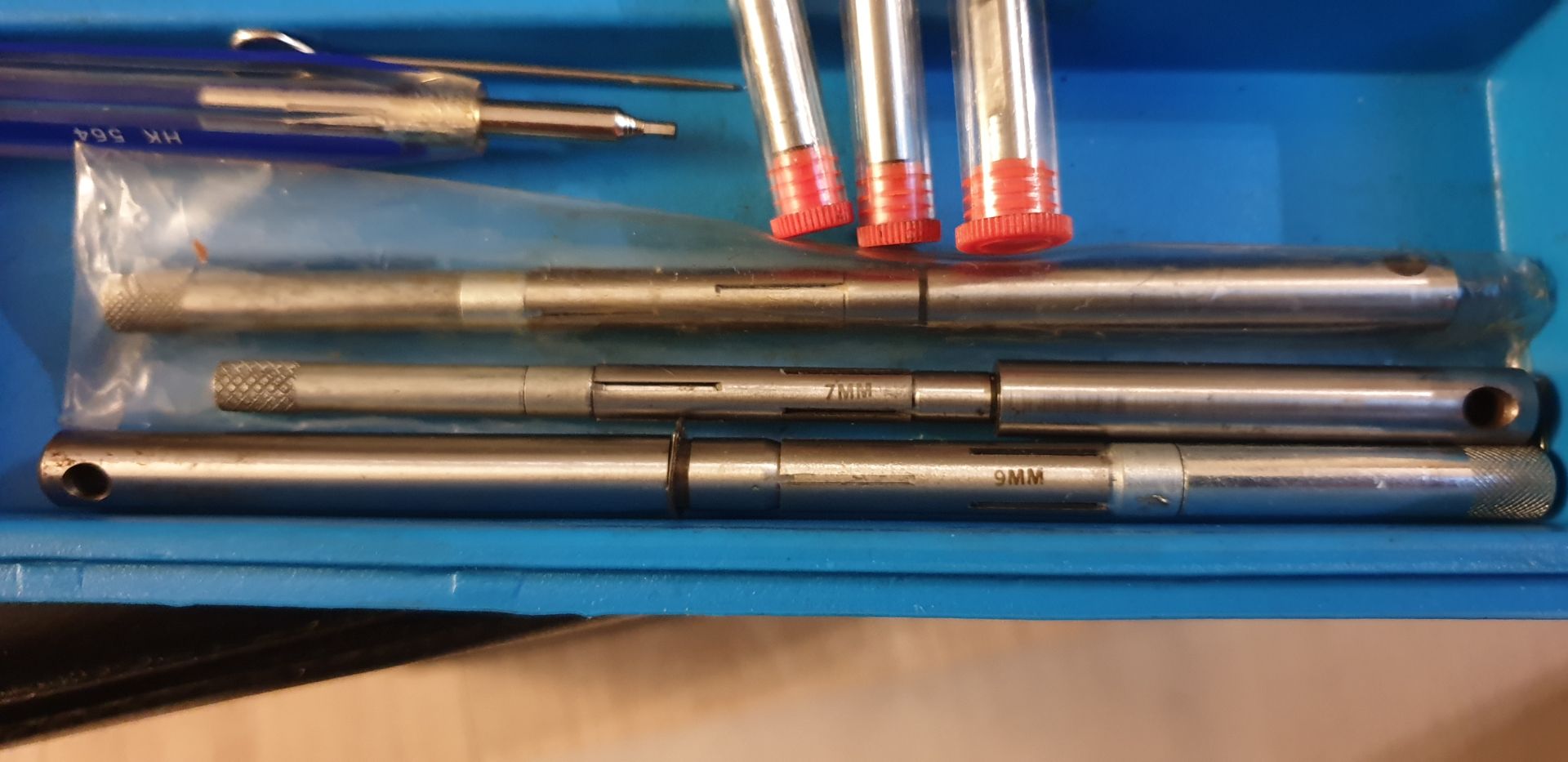

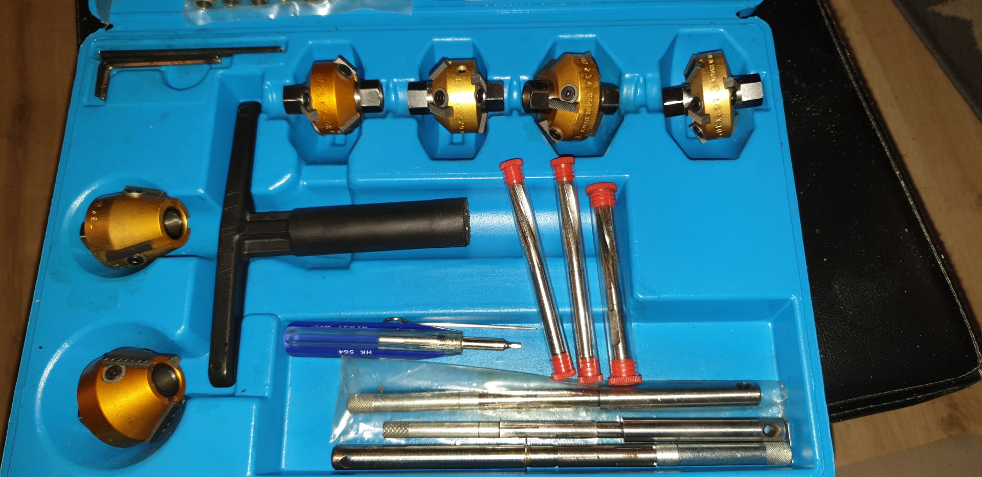

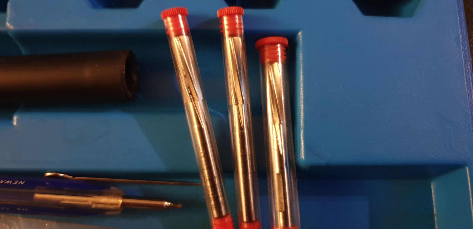

Wookie I have a newish 7mm Kibblewhite ball flex hone 240 grit and the guides were OE iron GUIDE,INLET VALVE
12013-009
Hey Dr. Gamma, if possible, I'd like to know the dimensions of the tool you'd posted. Looks like it wouldn't be very difficult to duplicate on a lathe. There's been a voice in my head all throughout this ordeal saying, "There's just got to be a better way!"
Thanks for all your responses!

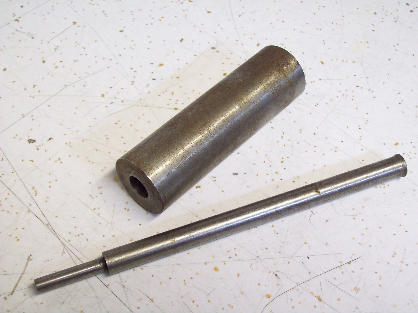

Here is a quick print of both parts of my tool for installing guides. All my mikes are metric, so most of the measurements are in metric. The overall measurements were done with a ruler. So those are in American. Hope you work in metric!!!
