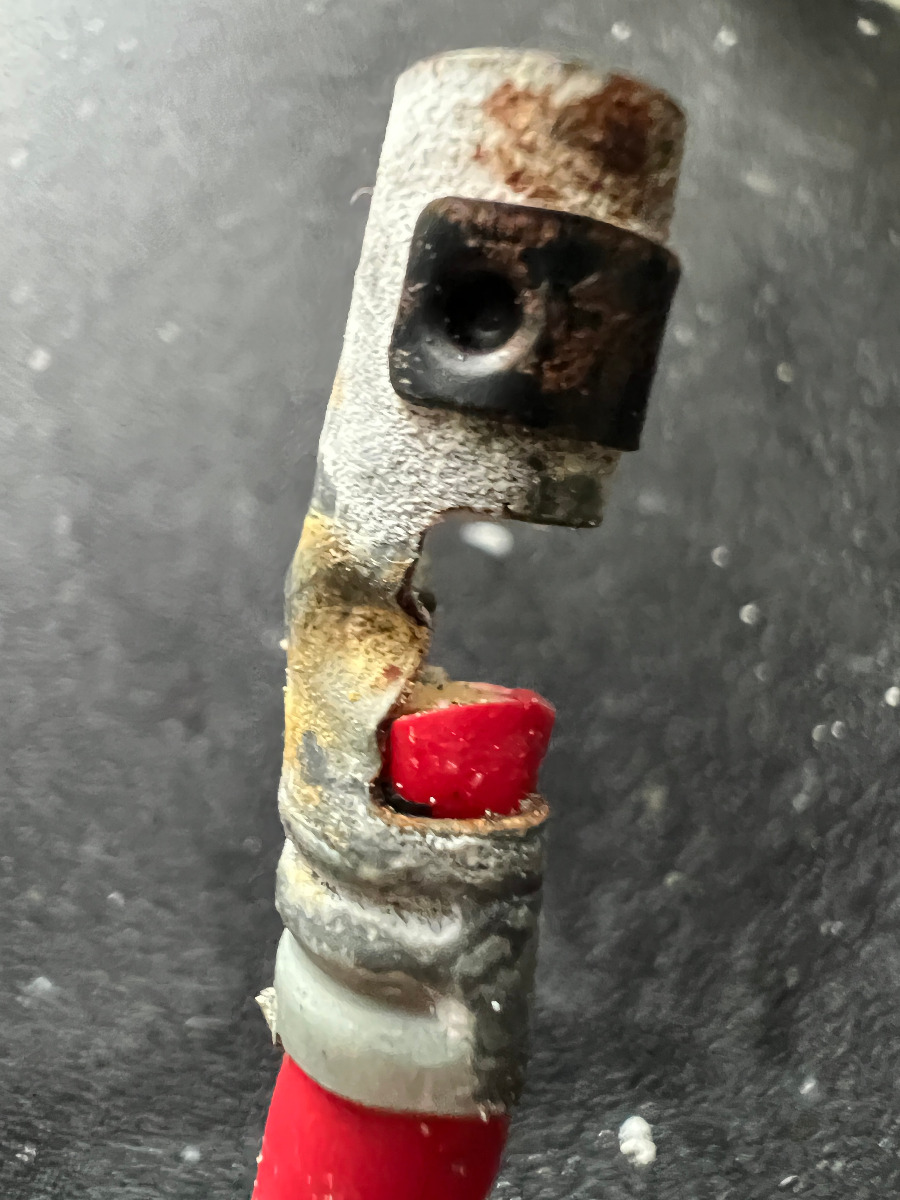

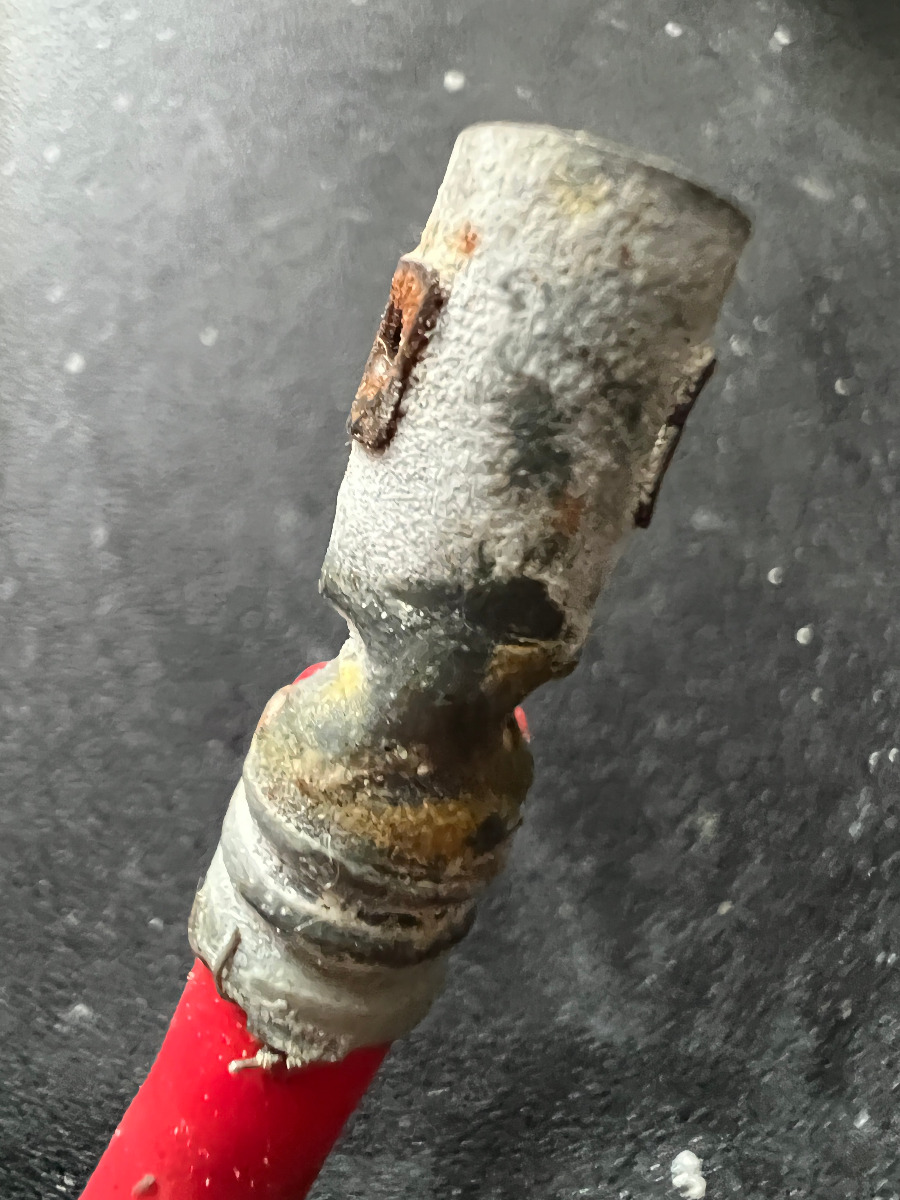

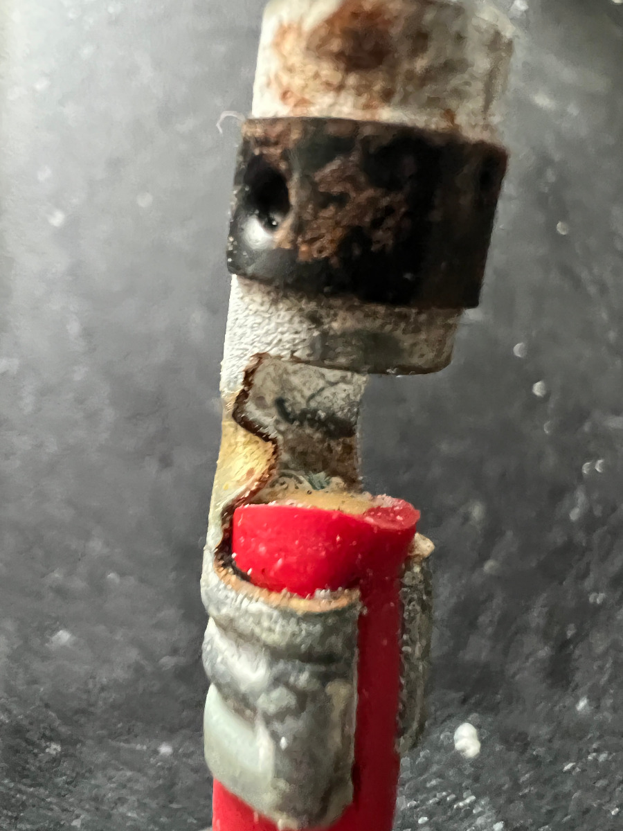

Thanks! I think I found the problem! have a look at this:

10 Oct 2022 09:38 - 10 Oct 2022 09:46Just got off the phone with a very nice guy at dynatek. he advised me to take the coil off and clean the terminal because the photo I posted is from where the wire plugs into the coil. Also, instead of buying a new wire, Im going to trim this wire and put a new connector on it.

What are those crimp ends made from? I hope they are tin plated brass. If zinc plated steel, that doesn't seem right.

10 Oct 2022 11:27What are those crimp ends made from? I hope they are tin plated brass. If zinc plated steel, that doesn't seem right.
No idea, but i just purchased new wires direct from Dynatek, which will arrive by the end of the week.

10 Oct 2022 12:28Makes sense, who knows how far that crud has travelled up the wires, you may have to cut them back a long way to be serviceable.
