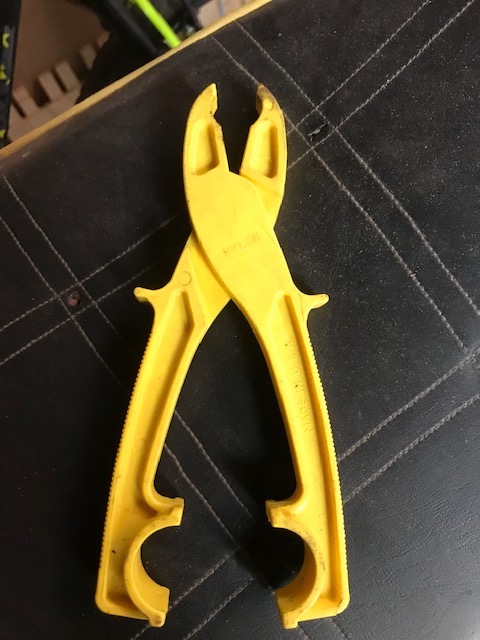

09 Oct 2022 22:54Snap On make these for that very purposeIve been researching since Ive posted. It seems that wires are NOT supposed to shock you when you pull them off the spark plug, and if they do, they are probably cracked and leaking. Im going to replace them.

Pulling leads with plastic pliers was the normal method of mis-fire diagnosis "back in the day" hence why Snap-On made a tool specifically for this. Even if you pulled a brand new lead on a running engine it is going to "bite you" (I have over 40 years experience !)

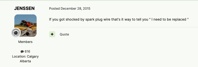

In the past, Ive pulled wires from the spark plug while a bike was running, and did NOT get a shock. As I mentioned, all my research says the wires are arching. I will be changing them and will post an update. I'll have to find wires that are compatible with the Dynatek DC1-1 coil that is on the bike. I will also take the coil off and test it.

PS: If you touch the leads and get shocked when they are connected to the plugs as normal then they are faulty
