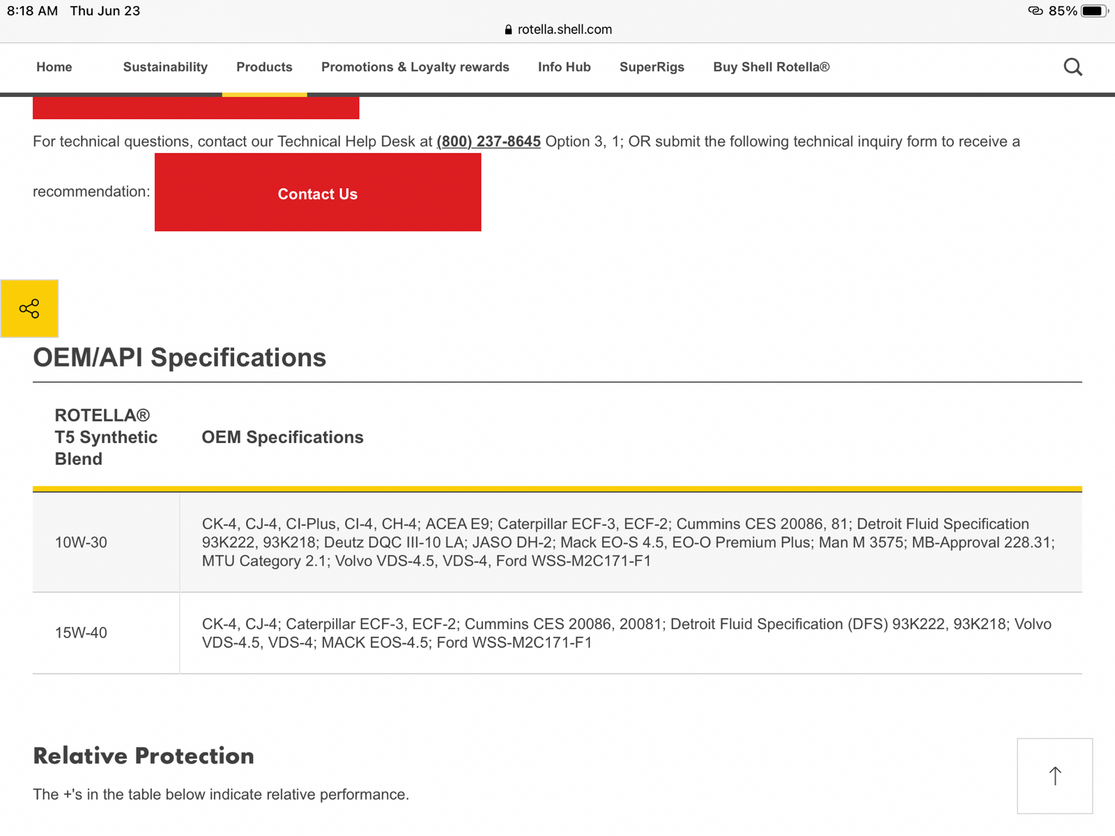

Not even sure I know enough about this to comment, but I thought our wet clutch bikes needed JASO MA
www.oilspecifications.org/jaso.php
the T5 is rated JASO DH-2. Someone more knowledgeable might be able to give us the skinny.
Last edit: 22 Jun 2022 20:25 by Mikaw.

Re: Slipping clutch low gears high rpms
23 Jun 2022 00:57JASO DH-2 relates to modern diesels with "exhaust treatment" (ad-blue exhaust fluid injection system)Not even sure I know enough about this to comment, but I thought our wet clutch bikes needed JASO MA

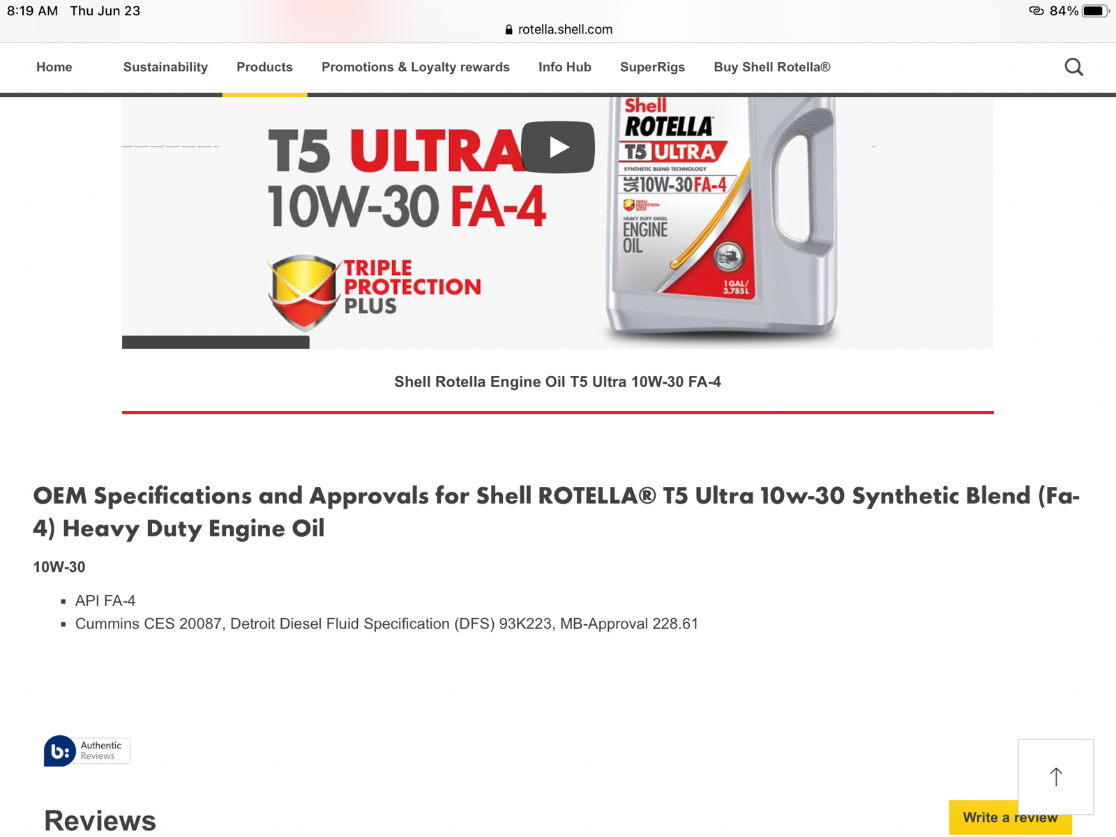

23 Jun 2022 05:24 - 23 Jun 2022 05:27
Like I said I know just enough to get in trouble, but researching it appears the T5 synthetic 10-30 only has a JASO DH-2 approval. The 15-40 has no JASO approval. The T5 ultra synthetic also has no JASO approval.
like I said do your vetting. Don’t blindly run out and buy the T5.
Last edit: 23 Jun 2022 05:27 by Mikaw.
