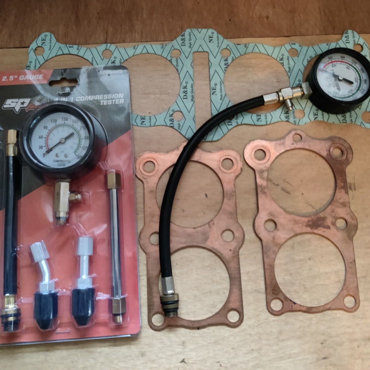

Hi thanks for the comments.
the debris around the top of the piston is just pieces of the old gasket I scraped off which I haven't cleaned up yet.
When I carried out the compression test the engine was cold and throttle was closed.
I've included a picture of the 2 compression gauges which I used and base gasket and the new copper head gaskets which I'm going to useI remove the barrels the checked rings pistons and bores all good
- Posts: 8403
Re: Low compression
18 May 2022 09:27 - 18 May 2022 09:29
A cold engine with closed throttle will give low readings. A long hose with the check valve on the gauge will add a bit to the lowness.
To get the most accurate readings, the engine needs to be at operating temperature, the throttle must be held wide open or the carburetors removed, and the check valve should be as close to the combustion chamber as possible. A reliable gauge is also a plus.
If that green base gasket is from Athena, I would donate it to a local land fill and buy a good one.
Last edit: 18 May 2022 09:29 by TexasKZ.

Re: Low compression
18 May 2022 17:44
Of those compression tester you've shown I would use the rubber push-on type if the Schrader valve is up at the gauge.
But as another poster has mentioned, your problem may be elsewhere. I would definitely go over all my steps before I opened the engine up again.
