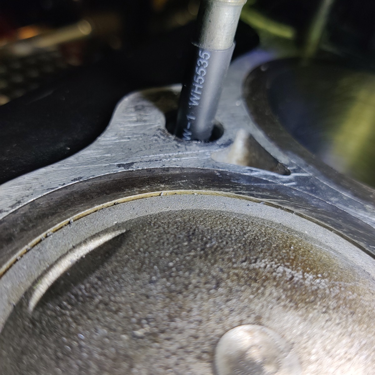

Hi all I have a problem with my z1000st I had it bored to 1100 fitted a set of cruise image pistons and rings, now its hard to start doesn't idle well, I've check valve clearances check valve seats, carried out a leak down test,but compression is around 120psi across all four cylinders remove the head again and noticed that at individual top dead centres the pistons don't go to the top of the cylinder, heres a picture is this normal?
Any advice would be appreciated.

Most engines run with a positive piston deck height [below the top of the cylinder block].
How thick is your base gasket? Have you considered using no base gasket just sealer?

To be honest if you have 120psi on a freshly bored cold motor I think your problem probably lies elsewhere. Is the cam timing correct ?
PS: are the ring end gaps equally spaced 120 degrees apart ?

Am I the only one that's seeing small bits of alloy around the edge of the piston ? I hope that was all cleaned out...

14 May 2022 17:00Am I the only one that's seeing small bits of alloy around the edge of the piston
I saw that too but hoped that was small debris from pulling the head back off ( Hope , hope , hoping )
Re: Low compression
14 May 2022 18:02My guess was gasket material.

15 May 2022 00:39Look's like gasket scrapings to me but I have old eye'sAm I the only one that's seeing small bits of alloy around the edge of the piston ? I hope that was all cleaned out...

With stock pistons the perimeter of the piston should just reach the top of the cylinder. So what you're showing in the photo is not normal, but those are not stock pistons if you bored to 1100. That said, 120 psi is a good reading, maybe a tad on the low side, but more importantly they are all within 15 psi of each other so it seems that your rebuild is OK.
As far as poor idle is concerned, what changes were made to your fuel and air circuits?

Isn't it true that the piston crown height is lower on an aftermarket piston to allow for planing the head?
