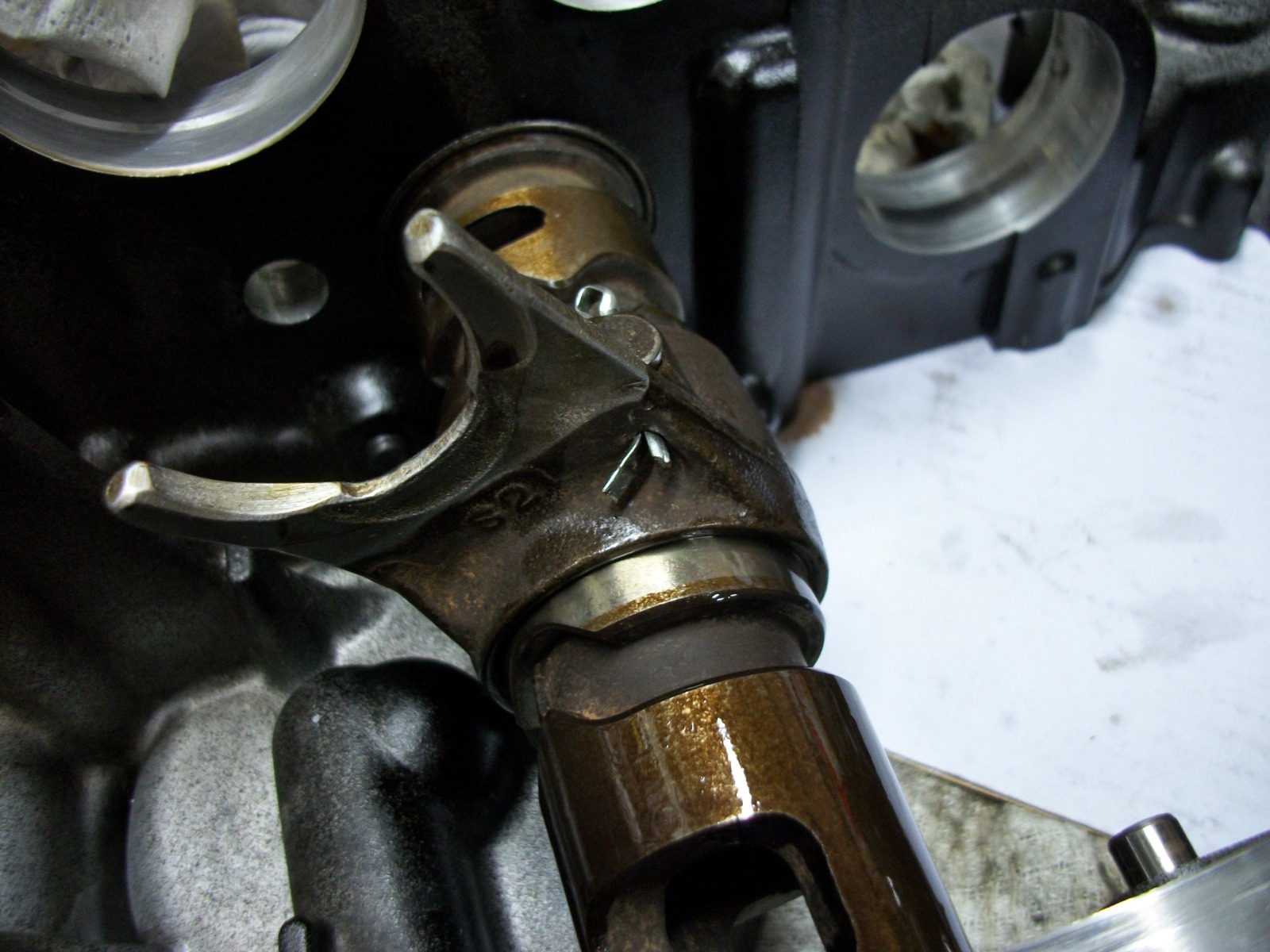

Below are some pictures of the shift forks and drum. Upon inspection, I notice a the crack (which is pictured below) in the 2nd/4th fork. None of the forks were visible bent. Is that crack enough to cause the issues I have been experience? All of the shift fork thicknesses were measured and are within tolerance.

Is the shift fork shaft hollow/bent?

Its hard to tell if its bent but just upon visual inspection it appears not. Also, it doesn't appear hollow just that crack. I ordered new ones so they are getting replaced anyway. I also check that the neutral finder bearings were not stuck. I'd hate to not find anything definitive going through the bike.

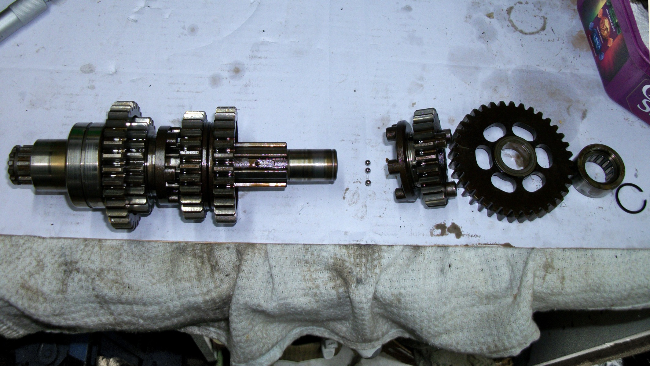

Have only these pics of my spare gearbox parts
2/4 selector and neutral finder bits on output shaft
hope it helps
Rob B
hope it helps
Rob B

Thanks for the pictures Rob. I think I am going to just replace forks, clutch friction plates, and remove those three neutral bearings and see how it runs when I get the parts this week. Unless anybody else has any other things I should look for other than what we covered? Am I right in thinking that removing the neutral finder bearings wouldn't harm anything?

Perhaps it is just photo distortion, but the wear patterns on the sides of the forks look quite different from each other. It seems especially so in the picture with the arrow pointing to the crack. If that is actually the case, the fork may be twisted just enough to cause problems.
I cannot tell for sure, but that flaw the arrow points to looks more like a casting flaw than a crack.
