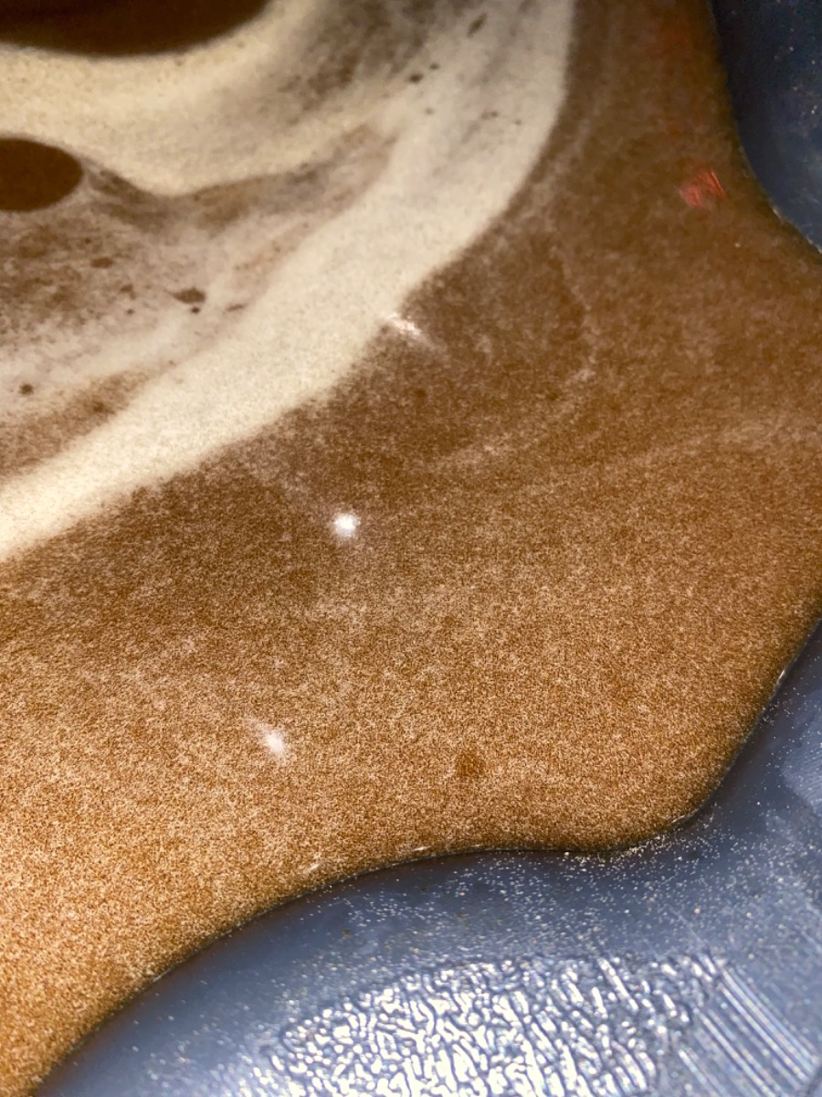

Welp, after my oil pressure sensor took a dump, I guess I didn’t notice until I got to work. Less than 5 minutes later. Filled it with oil and Limped it home. I toss on the new oil pressure sensor and boom. It’s knocking like a Jehovas witness at 8am on a Saturday. Double checked my timing and started it back up. Still knocking, drain the oil and see this…
so now I don’t know what I’m gonna do. I can rebuild it, try to find a used donor and swap them, or just start over. I’m truly unsure of what to do. I’ve put so much into this motor and everything and now this. I could part it out, it’s got some decent stuff on it. Electronic ignition, 4-1 exhaust, stainless steel brake lines, rebuild calipers, good carburetor, clean tank, new tires, new chain and sprockets, new seat cover, rebuilt gauges and so on. Really unsure of what to do now.

Well, a swap is kind of out of the question. The closest kz750 to me is 200 miles away. Biggest issue is that one is that it has 52k on it. I don’t want to swap a bad motor with one that’s on its way out. I don’t want to downsize to a 650 or smaller. If I sell it, I will lose my rear end, no one will pay over $1000 for a really old motorcycle with a known bad engine and no title. I think I’m looking at a rebuild. But I’ve never rebuilt an engine before… I think I can but I have never to date.

Hi Elfarm, I would suggest you take a breath and evaluate what you have - is a $1k for another 40 year old engine of unknown provenance the best way to go ?
The fact that it will re-start after you have turned it off multiple times is a "good sign"
I would suggest pulling the cams out and have a look at the bearings ( these are the furthest from the oil pump so the first thing to go dry)
It is unlikely that the rings are damaged (check the colour, if they are blue they need to go) as I would expect bore damage at that point and it is unlikely it would re-start
If the bores and cam bearings are ok it's just a bottom end rebuild which will cost a lot less than $1k and you will know you have a good motor (worth replacing the oil pump)
It would also be a good learning curve to have seen and know what is happening on the inside. If you take your time and follow the manual it will give you a huge sense of satisfaction (just my opinion)
