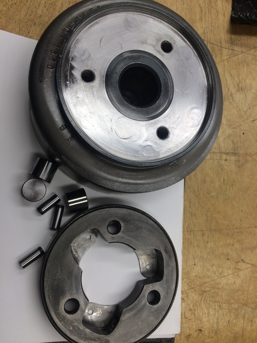

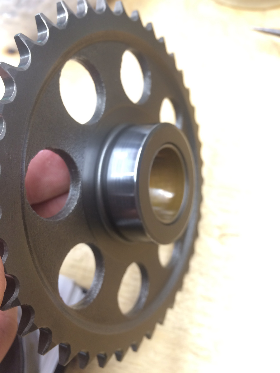

Here's some pics to illustrate what i mean. Polish the surfaces that the rollers slide on with 220 or a scrotch bright disk for a Rolloc.  www.3m.com/3M/en_US/p/d/b40064719/   , you don't have to go crazy just smooth any burrs over so the rollers don't get caught. Tell the machinist to turn the boss down till there are no wear marks. this should be very little, if they take off too much you might run into problems. Also tell them to use an arbor to hold the sprocket. If they try and grab the sprocket from the inside with the chuck jaws reversed they will damage the bearing that is in there. This stuff seems obvious but sometimes machinists just want to get the job done and don't think about the ramifications of how they do it.
