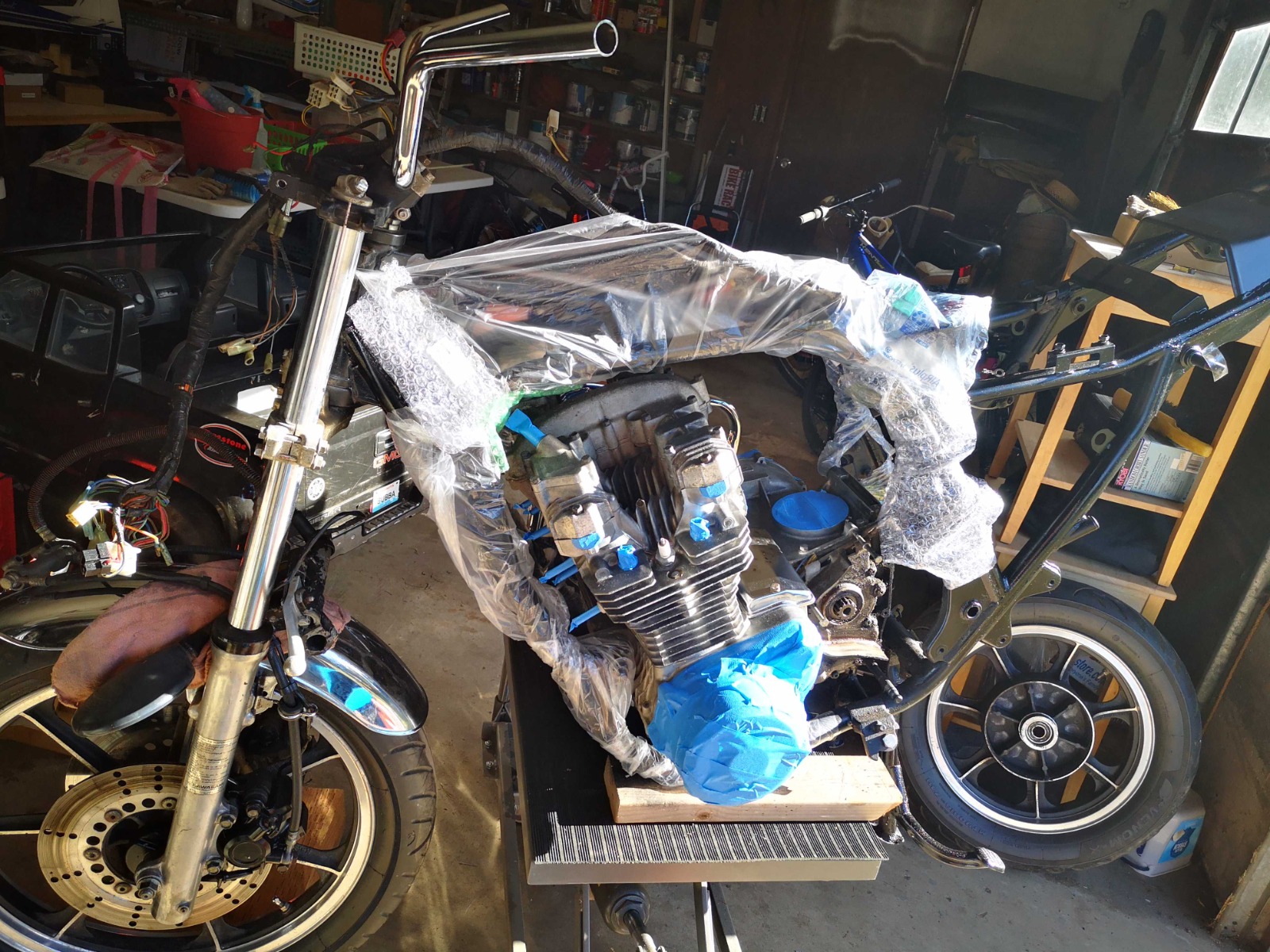

Hi,
getting ready to paint the engine soon, in aluminum.
I want to polish the covers, so I want to mask them during the painting.
Any advice on the best way to do that ? masking tape all over ? wrap in plastic bag and re-bolt to engine ?

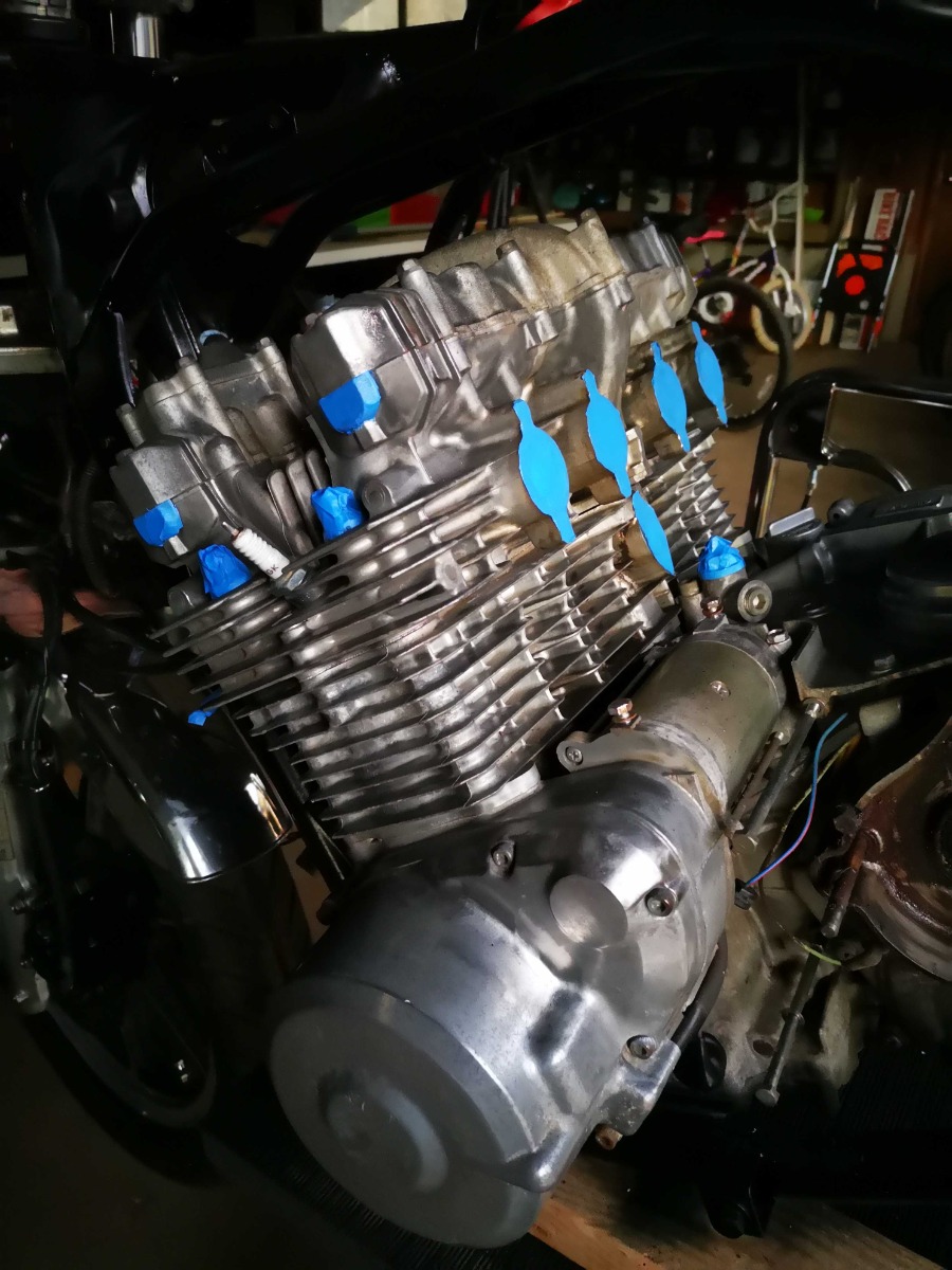

I ended up putting blue-tape everywhere, worked out like a charm. I just need to buy a fresh roll of blue tape now...

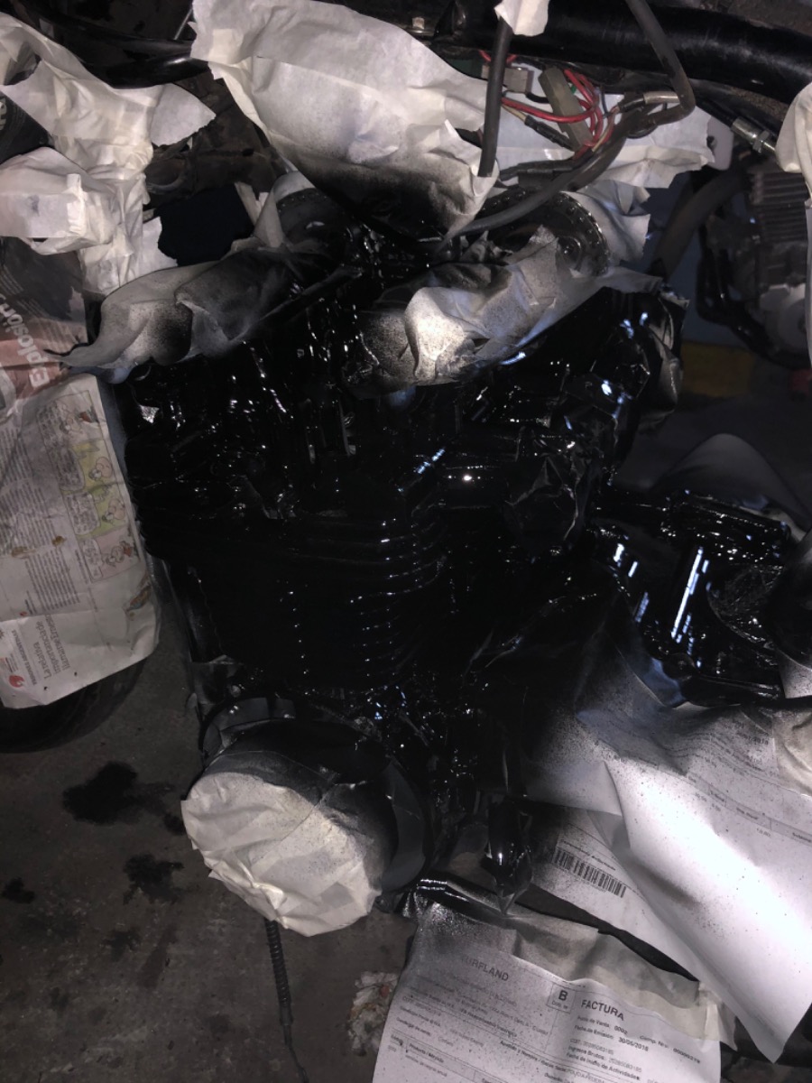

- KZmarcel
- Posts: 91
- Thanks: 6
Re: masking engine covers ?

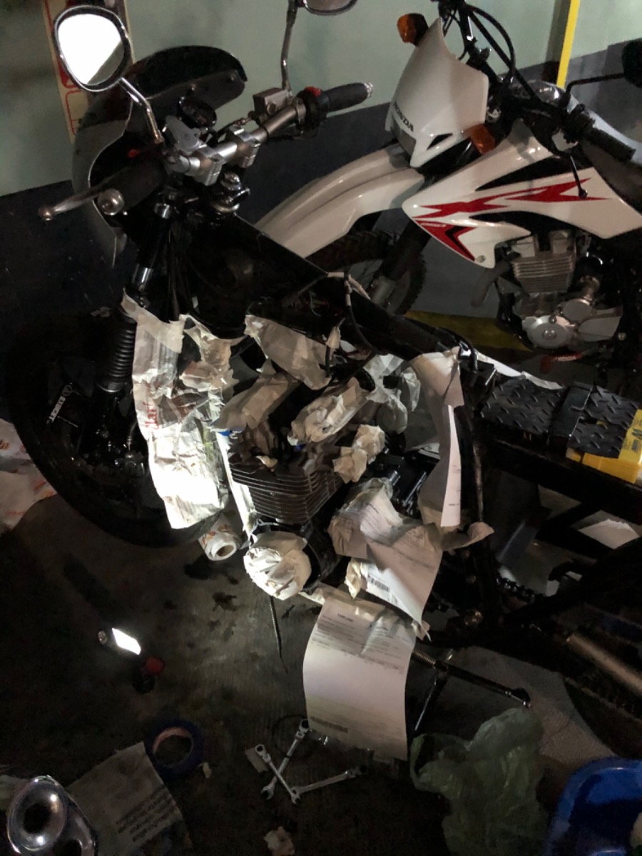

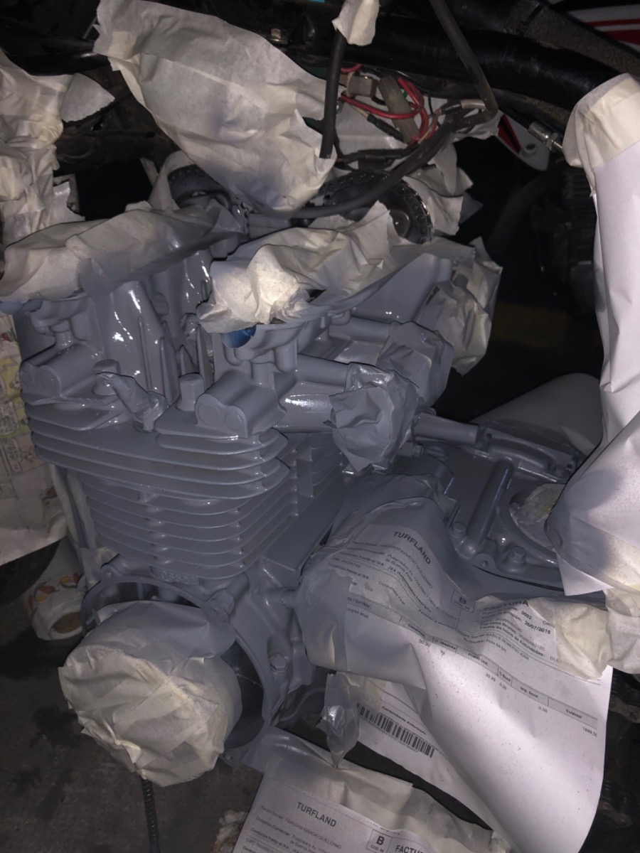

04 Mar 2022 15:29Nice !I made this way
