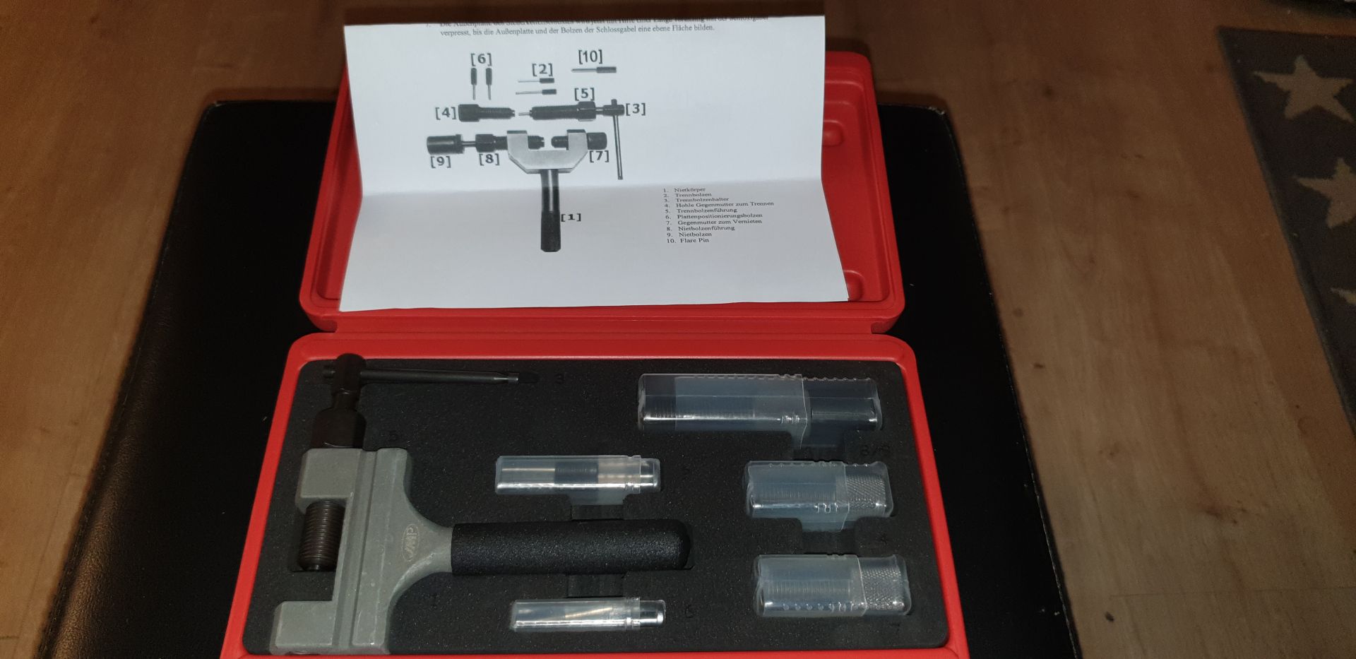

Re: Master link cam chain replacement process
16 Feb 2022 20:08
#862477

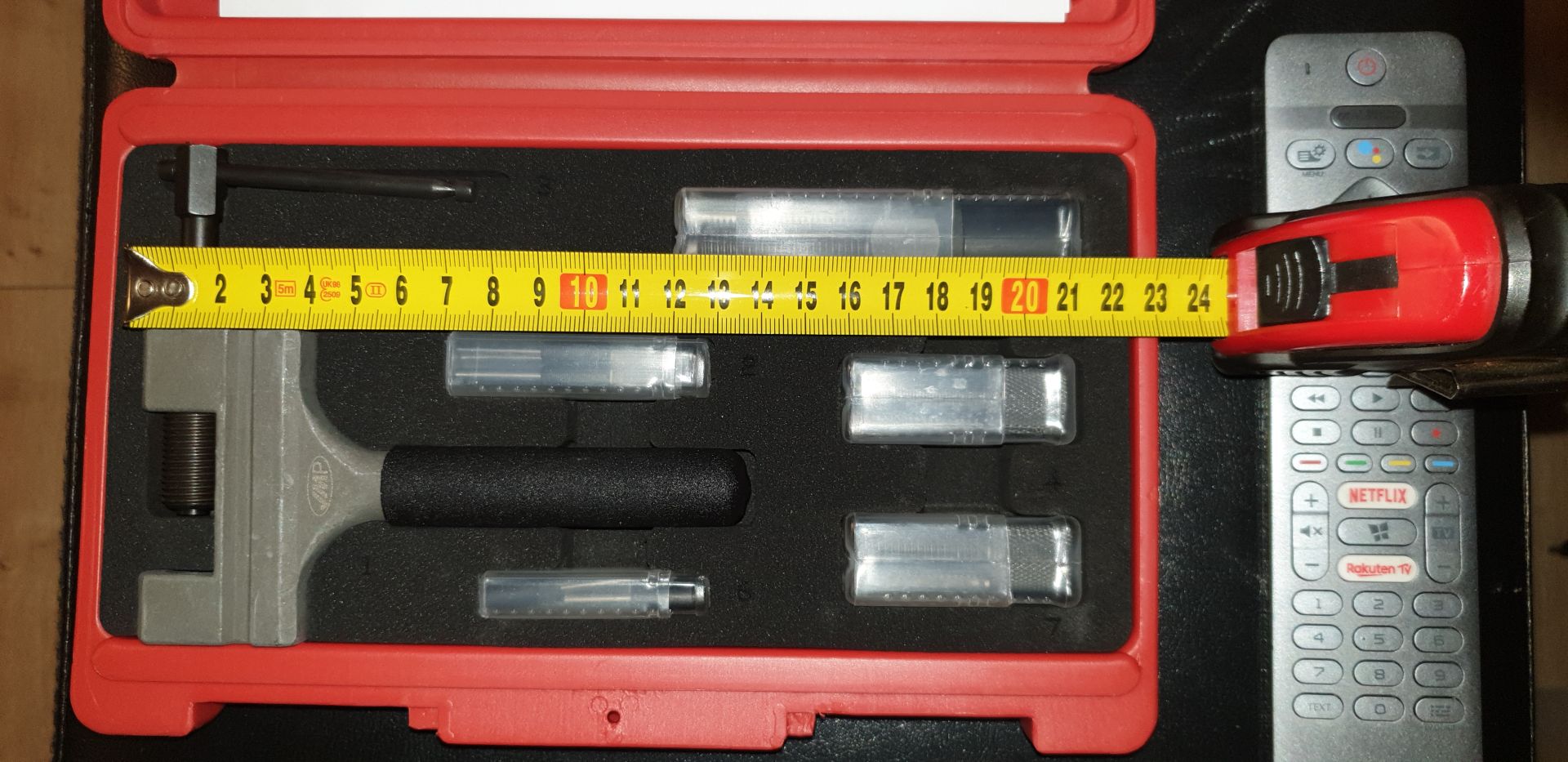

Anyone brave enough for a new challange?
New, unused JMP cam chain tool set.
150 Euro shipped worldwide.

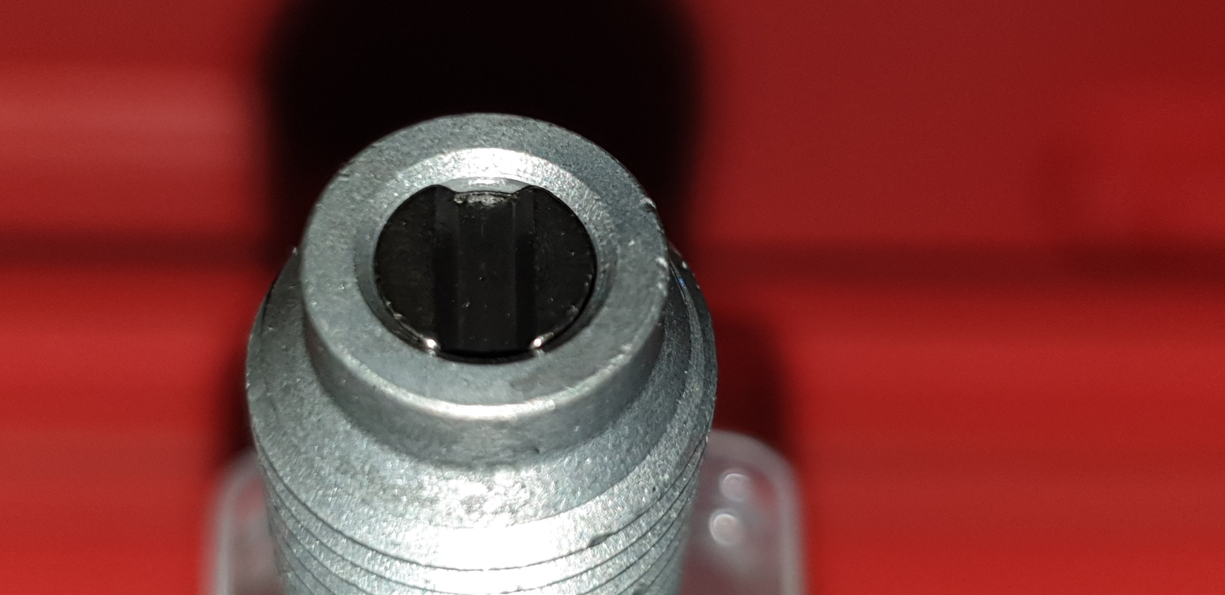

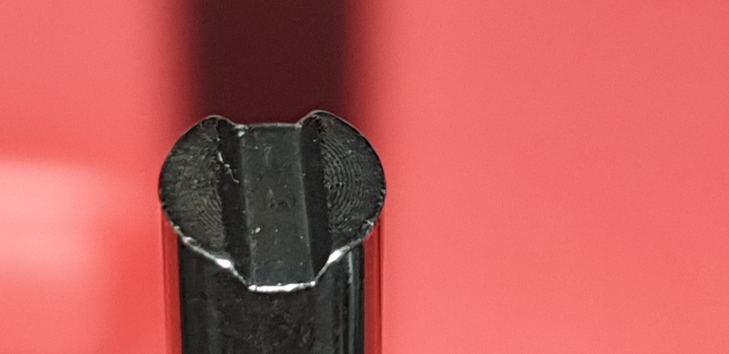

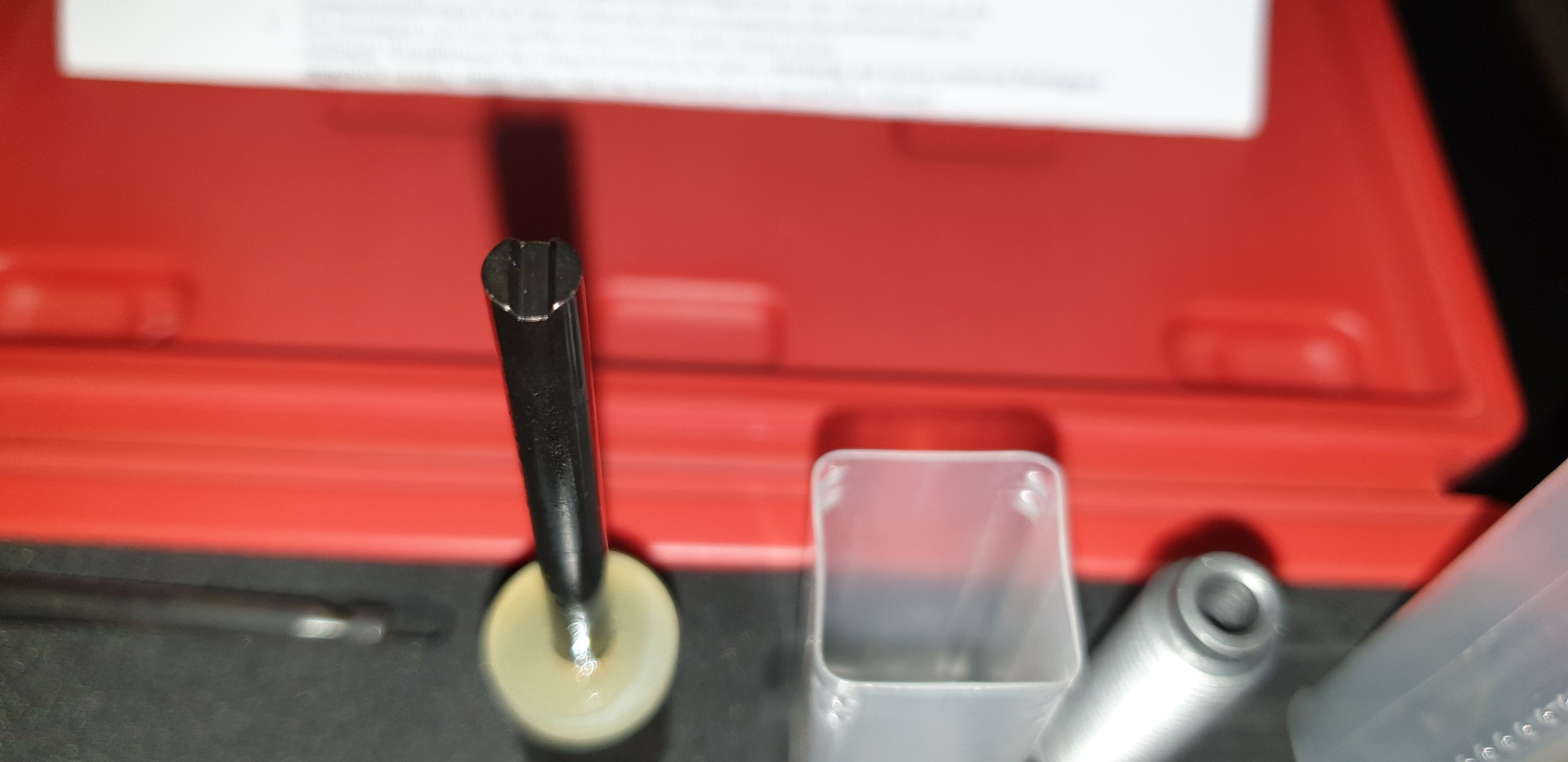

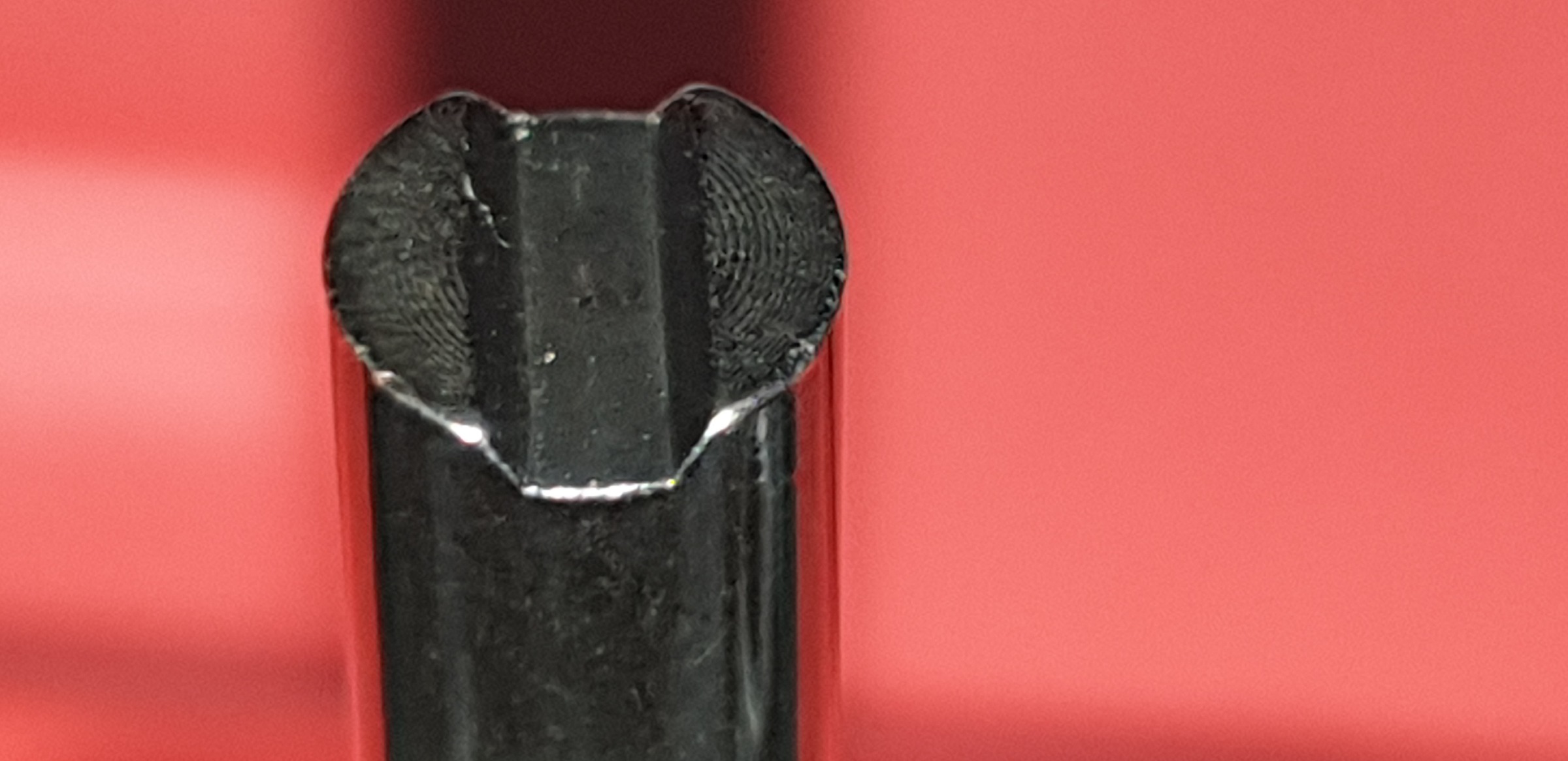

16 Feb 2022 21:04
#862479

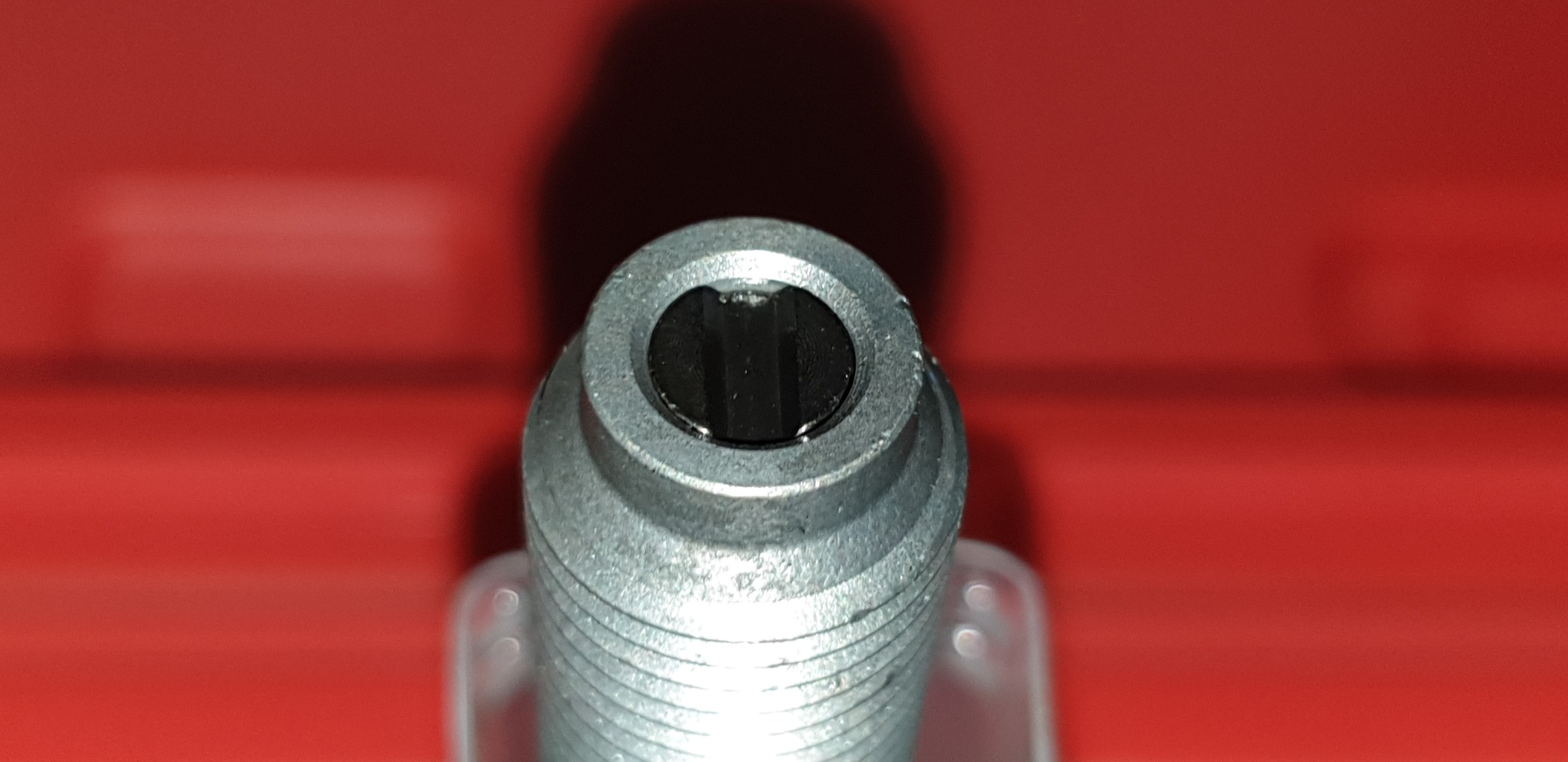

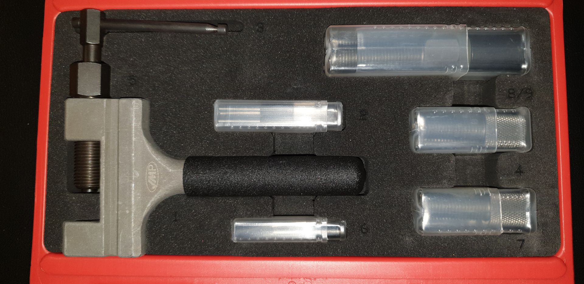

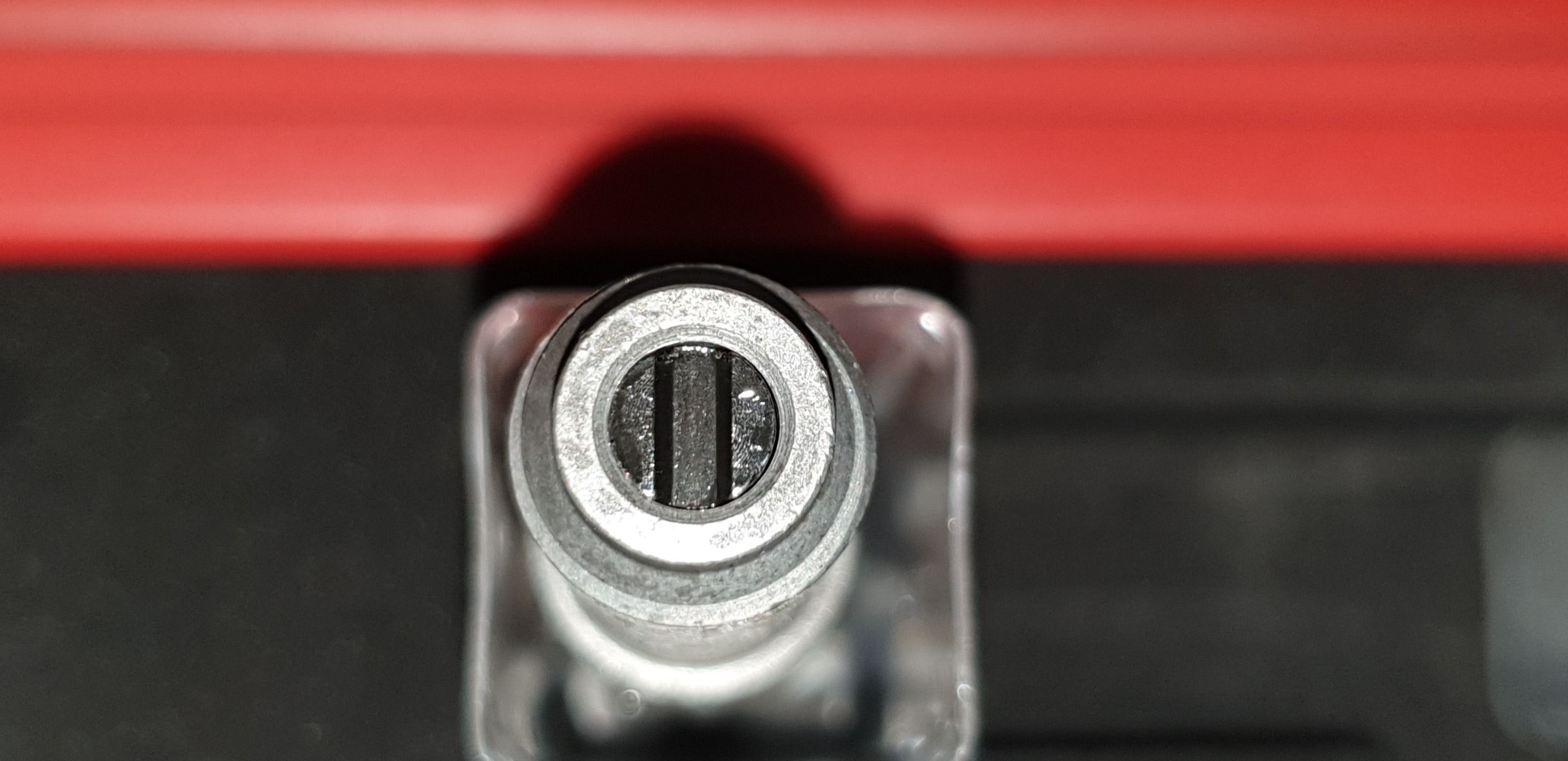

Upon demand, some detailed pics of the #8/9 tool parts.

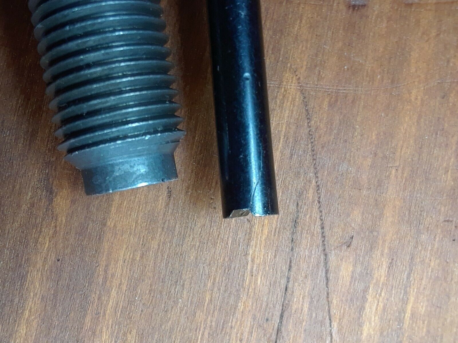

30 Oct 2022 09:27 - 30 Oct 2022 11:02
#876200

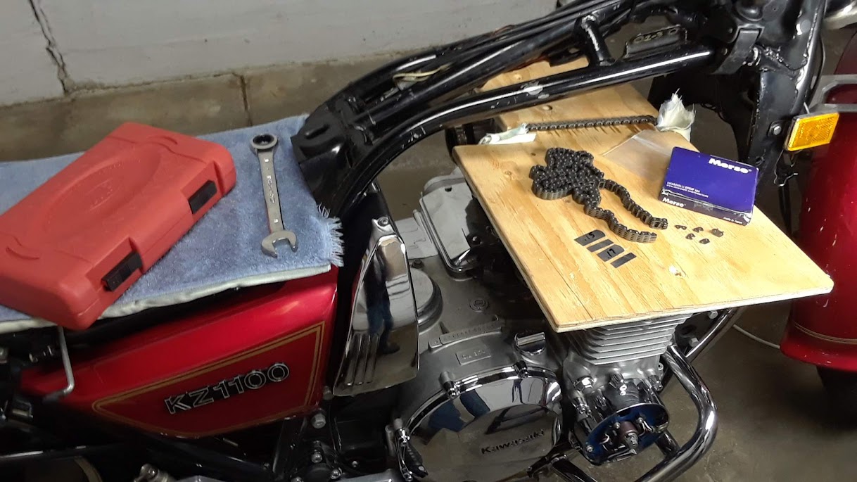

I'm tempted, but have you successfully done this yourself with a tool like this? If so, how did it go?
Installed a new Morse master link cam chain (ebay item 333499911108) in late March this year, and have put 6000 plus miles on the engine without issue to date since.
The JMP MK-1588 was the best kit I could find for the purpose, despite having a tooling issue while executing the process.
1982 KZ1100-A2/1170 sleeper 😀
