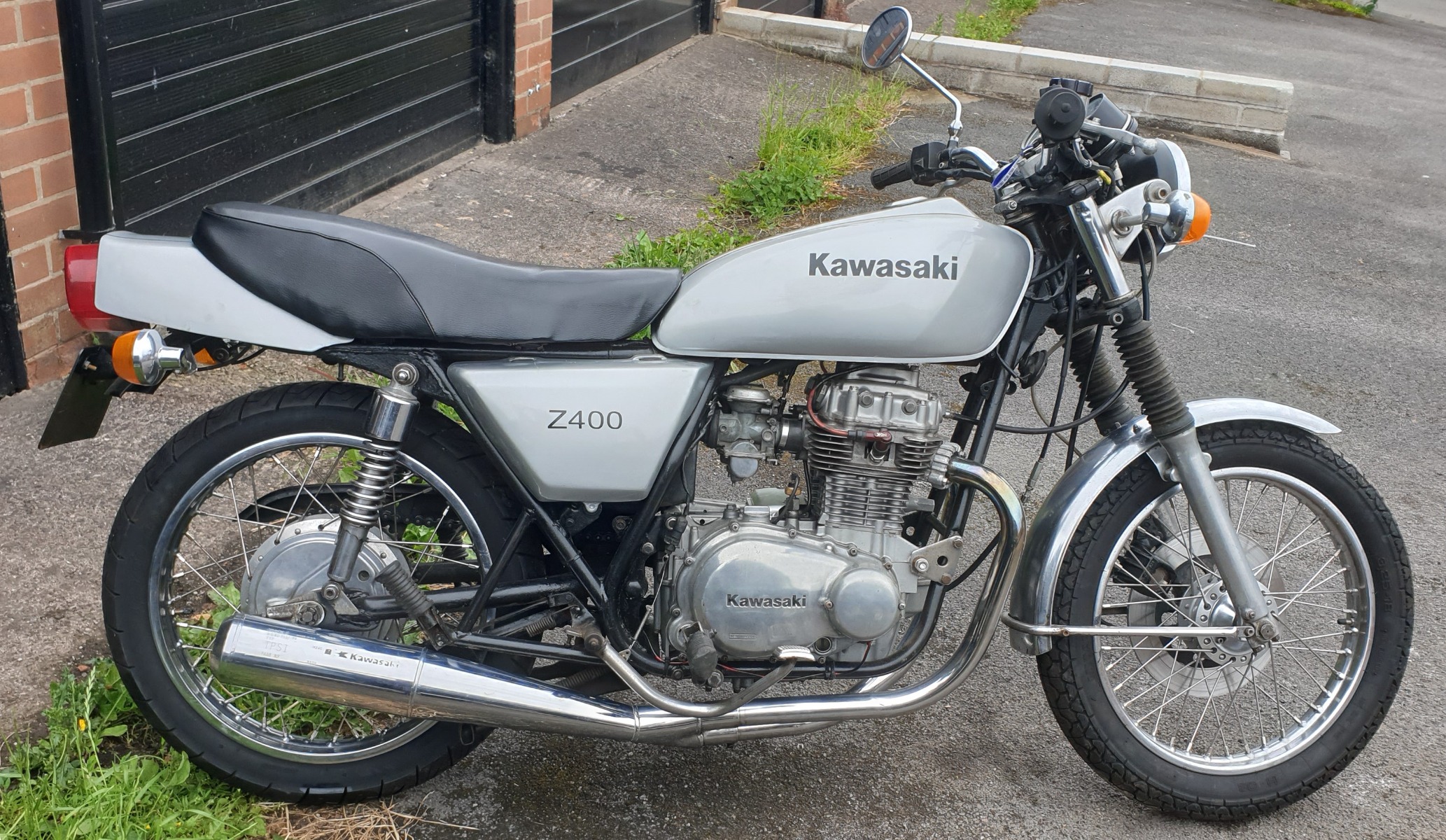

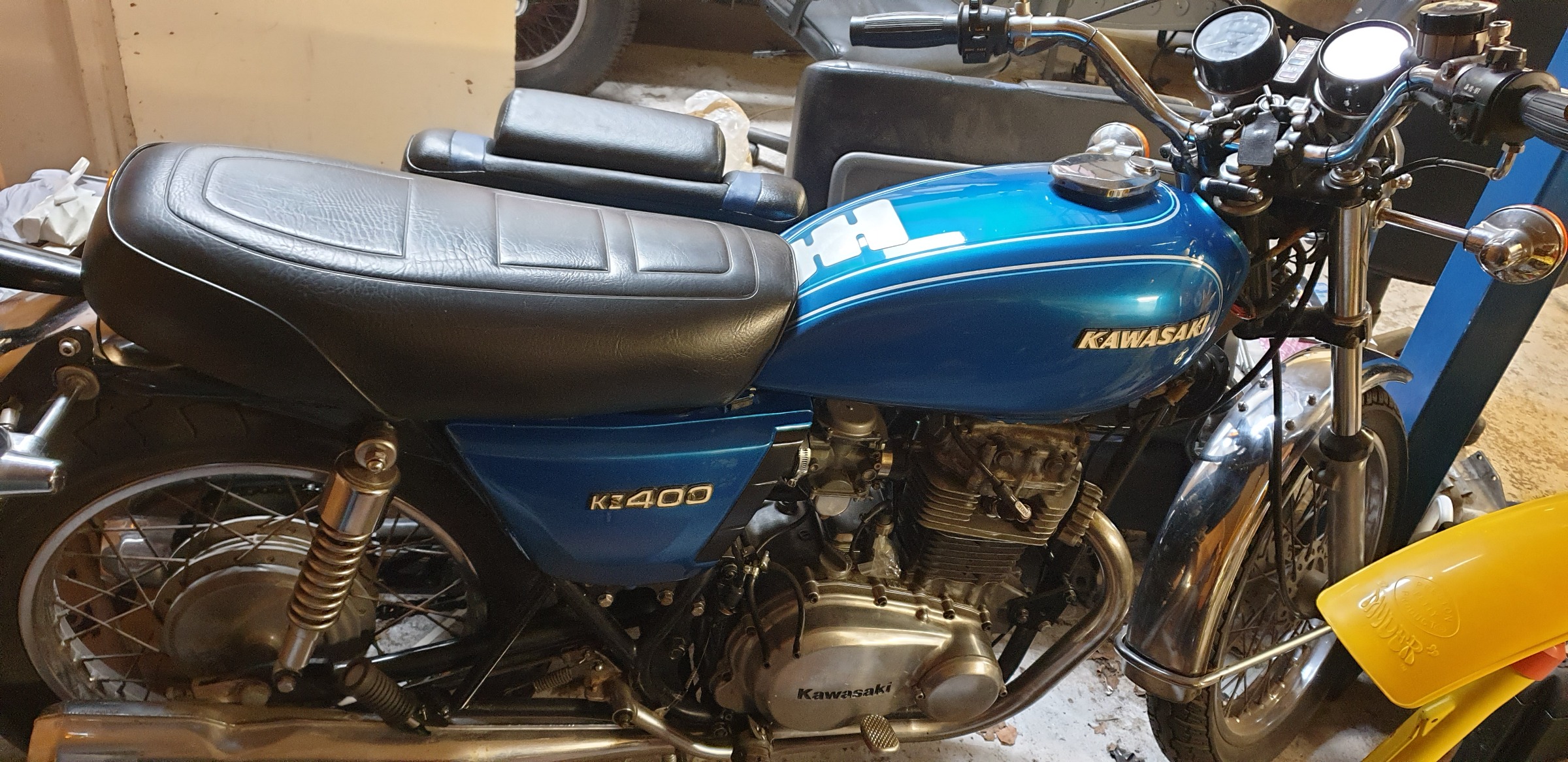

Both these KZ/Z400s have had complete Engine Rebuilds. The Blue one is the Early Type 74/77 and Started life in the US it now has the Later 1978 Z400 Engine Fitted the other is a 79 and the Original Engine was far to Gone so the one in it is built mainly from Refurbished and N.O.S Parts if you look at KZ400.com you will find the full Z400 Engine Rebuild
( www.kz400.com/EnginemodificationFrameset.html ) the Replacement of the Rocker Gasket is Straightforward and only the Tank needs Removing. The Z400 Engine is very easy to Work on and the only special tools needed are the tool to remove the Rotor and a good set of Cire clip Pliers internal and External . This Site will also give you all you need to know regarding KZ/Z400s and 440s.
