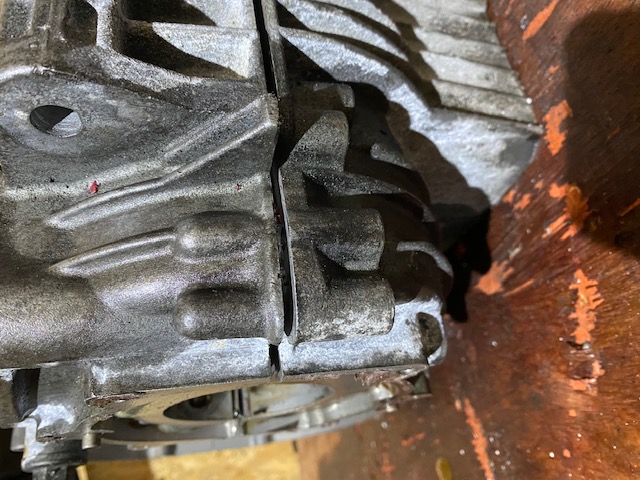

You know what this is super interesting and takes the sting away from the fact that the case is re stamped, it gives me something to look out of later, i personally think the case i have are way later cases that were put on a mill to take the plate down past the stamp and then restamped but im glad to be proved wrong . This is said corner on the case in question.

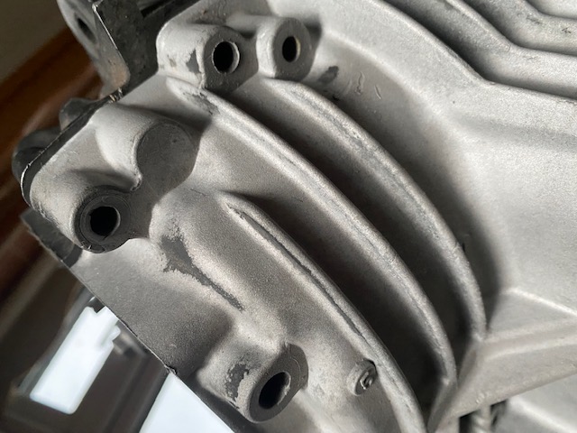

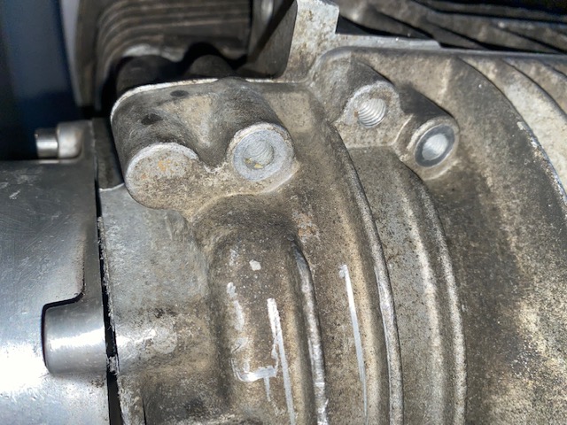

Now i have 2 Z1b cases and you might find this interesting, in the case of thse 2 lugs the older of the Z1b cases has the bolt on the left hand side and the newer has it on the right.
first the older case. Z1E 0546**
and Z1E 0670**
and Z1E 0670**

I have two Z1B's. 55424 has the bolt on the outer. 72313 has it on the inner.

09 Jan 2022 04:32I have two Z1B's. 55424 has the bolt on the outer. 72313 has it on the inner.
Thats interesting in its own right, somewhere in the Z1E 055*** bracket they moved form 2 lugs top and bottom with the hole/tap on the outside to the hole/tap on the inside. No Texas its curved just like all the rest, the carbon streak in the photo just makes it look like a had edge.
