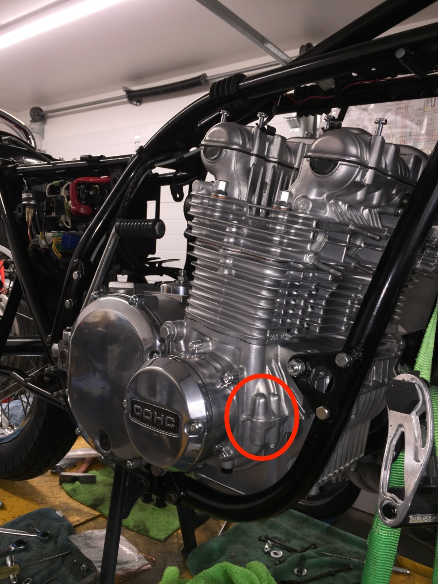

The longer pad was introduced around S/N 27,000. The early font was used until about 34,000, which is when they added the lip. The lower right case photo shows that the cases are Z1 or early Z1A. Putting all this together suggests it was an early Z1A case produced after S/N 27,000 but before 34,000.The photo below shows the lower right corner on a Z1B. This bolt pattern was also used on later Z1A's. But as I mentioned above it was different for Z1 and Z1A.
