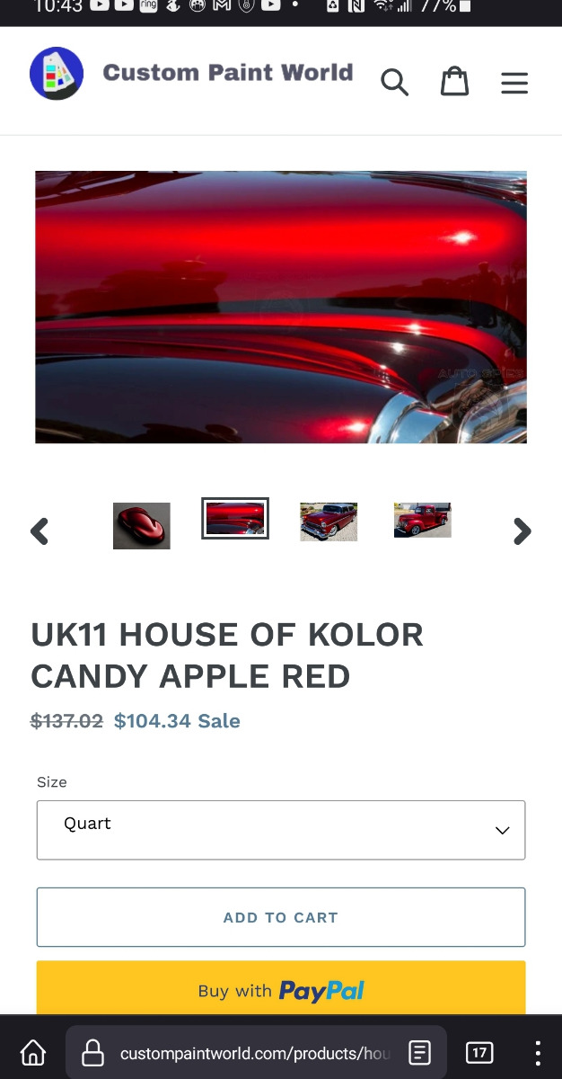

Re: Valve-Lash Affect On Cylinder Compression
15 Dec 2021 19:46 - 15 Dec 2021 19:47
Perfect!
House of Kolor has a nice candy apple red.
www.houseofkolor.com/kolors/detail/index.html?id=S2-KBC11

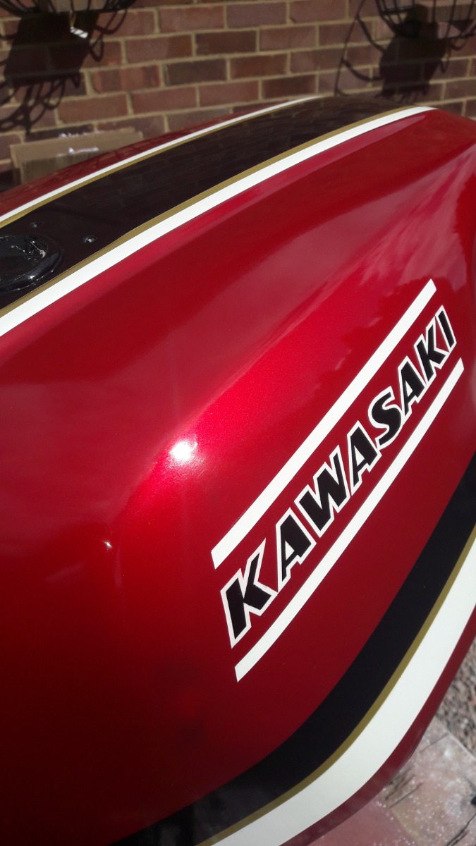

15 Dec 2021 20:05
Mazda soul red crystal 46V.
15 Dec 2021 22:53 - 15 Dec 2021 22:54Mazda soul red latest project.Mazda soul red crystal 46V.
Last edit: 15 Dec 2021 22:54 by Warren3200gt.
