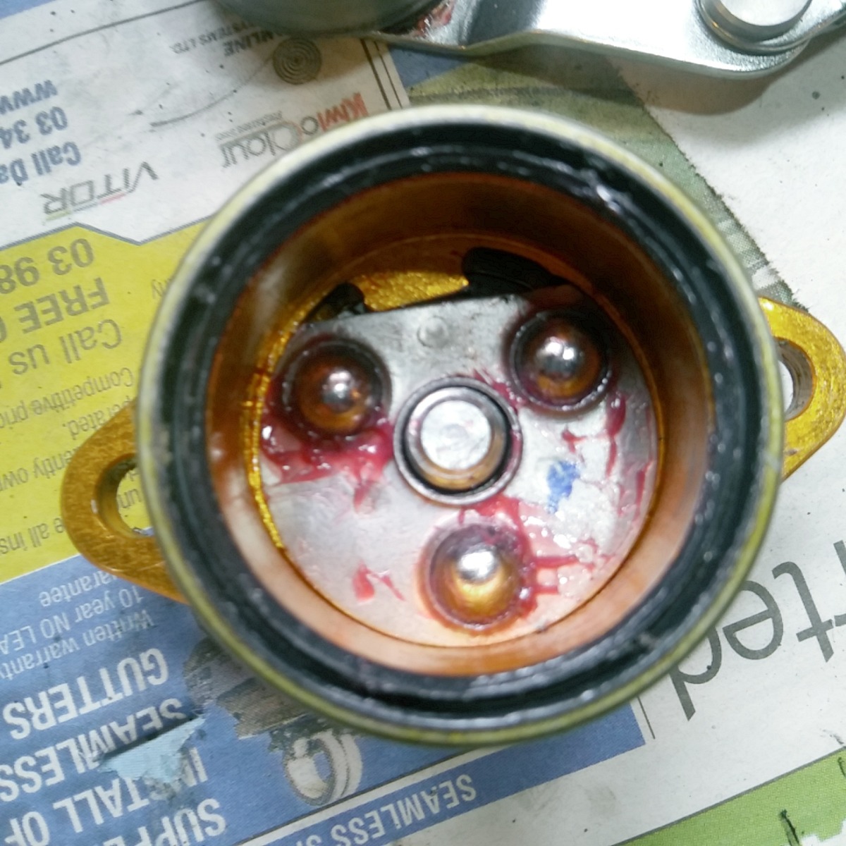

I dont know what happened today. But the b*st**d thing is working fine. I did squirt a fair bit of grease under the ball bearing holder and more on top before putting the actuator arm back in. I also pulled the pushrod half way out and made sure it was going into the hole in the actuator as I pushed the cover back on. I pulled that clutch lever in at least 30 times with no problem.. Once I have the front brake caliper back on. (Thats a whole other new problem). I'll go out for a ride and see how it goes.

I thoroughly greased the bearing assembly when I installed mine.
I might have missed it, but did you pack it with grease when you installed yours?

MoveOver. I only put a light smear of greas under the bearing holder and on top, after putting it in. But this time I gave it 3-4 shots from the grease gun under and over.

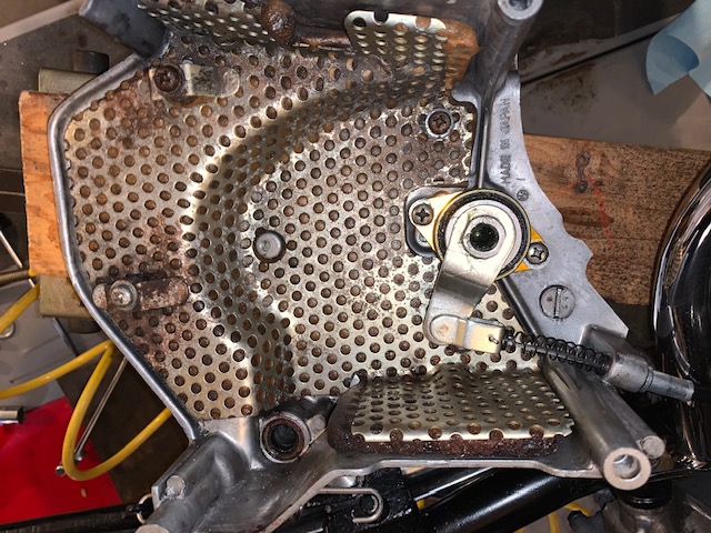

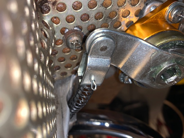

I have been away from this topic for a few weeks and it sounds like it has been solved. Almost 2 years ago there was a discussion about the E-Zee clutch when I installed mine in my '77 KZ-1000. Part of my initial problem was that the instructions were written in Japanese, so I tried to just use the supplied pictures as a guide which didn't work very well. I finally located an app that would translate the instructions into English but even that was lacking somewhat. Eventually through trial and error I managed to get the PMC kit installed and haven't had any problems with it in close to 2 years. In fact, it works great and I would agree that the clutch lever effort has been reduced by about 40% give or take. I took a couple of pics to show the relative relationship of the parts before installing the cover in case I need to go at this again. I also took a pic of the cover showing the boss that needed to be removed/ ground off for cable clearance. I didn't do this at first as I didn't want to change or damage the cover in any way, but I encountered problems until I clearanced the cable. It may be after the fact but the pictures are included.
