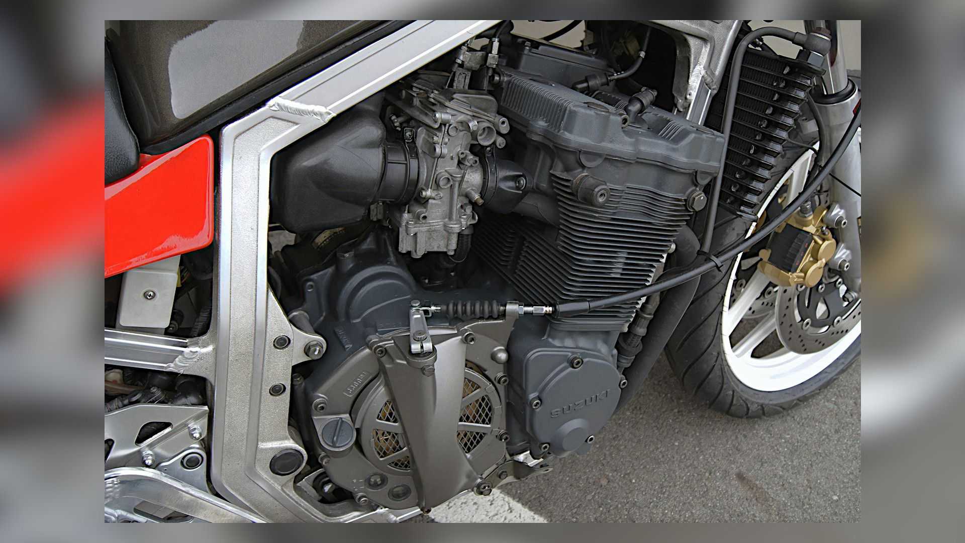

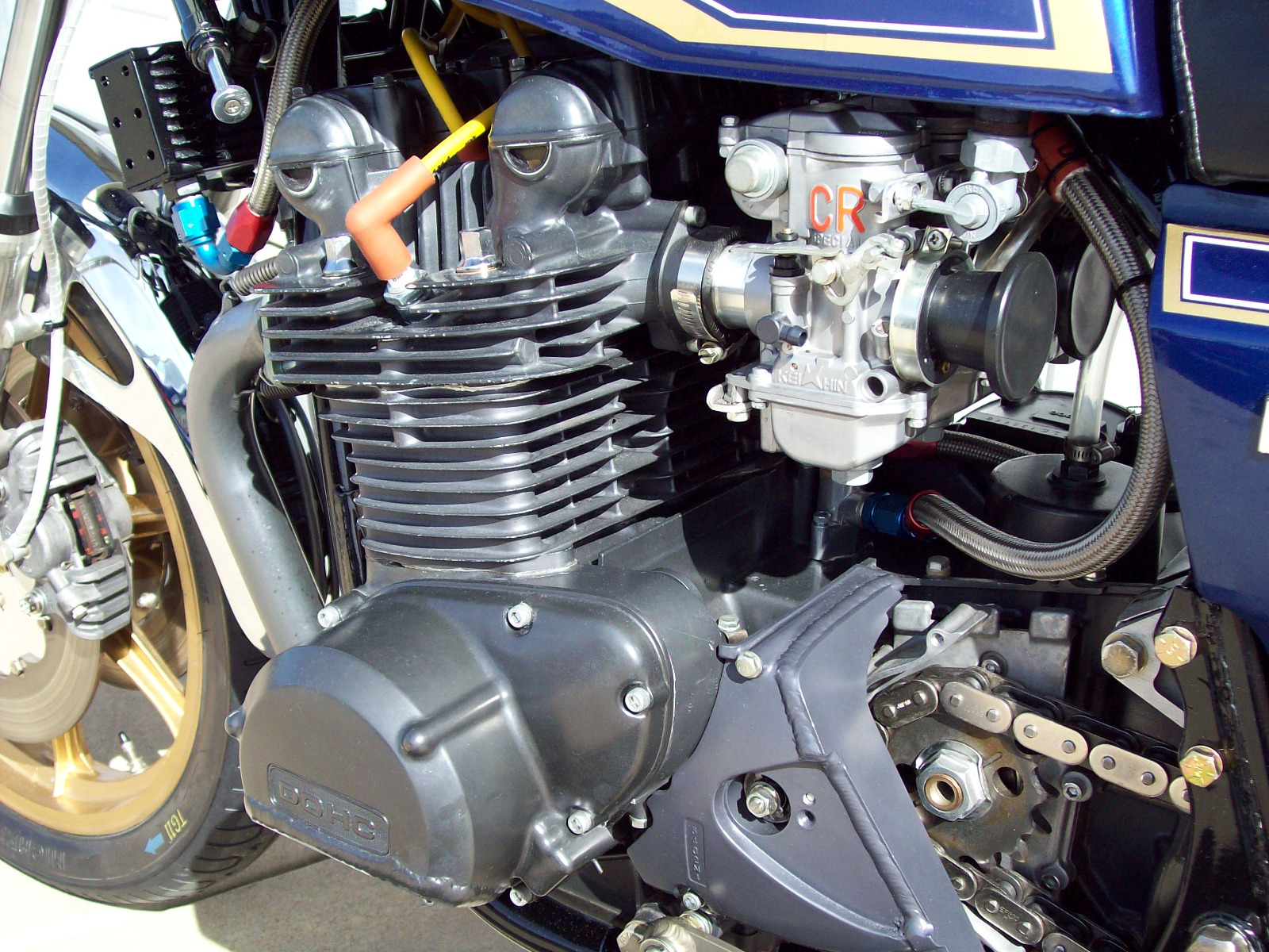

Kal Gard makes an engine coating called Gun Kote. It came about from some military or space program way back in the '60's. This coating when applied to motorcycle motors helps greatly with heat dissipation. Yoshimura has used this coating from the very early days of their Superbike program. Its a very durable coating too!!! NOTHING takes this coating off when applied correctly. The only way to remove it is to glass bead or sandblast it!!! Most racebikes in the '70's and '80's had this coating applied to their motors. Suzuki has used this very same coating on all their oil cooled GSXR and Kanatuna motors since those bikes first came out in the showroom. I believe they still apply this coating to their GSXR model bikes. This is the only engine coating I know of that actually helps in the dissipation of engine heat.
Suzuki GSXR750 motor with the Gun Kote coating.
Kz1000 motor with the Gun Kote coating.

19 Aug 2021 17:01Yep, KG industries 2400 series paint is the one...Kal Gard makes an engine coating called Gun Kote. It came about from some military or space program way back in the '60's. This coating when applied to motorcycle motors helps greatly with heat dissipation. Yoshimura has used this coating from the very early days of their Superbike program. Its a very durable coating too!!! NOTHING takes this coating off when applied correctly. The only way to remove it is to glass bead or sandblast it!!! Most racebikes in the '70's and '80's had this coating applied to their motors. Suzuki has used this very same coating on all their oil cooled GSXR and Kanatuna motors since those bikes first came out in the showroom. I believe they still apply this coating to their GSXR model bikes. This is the only engine coating I know of that actually helps in the dissipation of engine heat.
