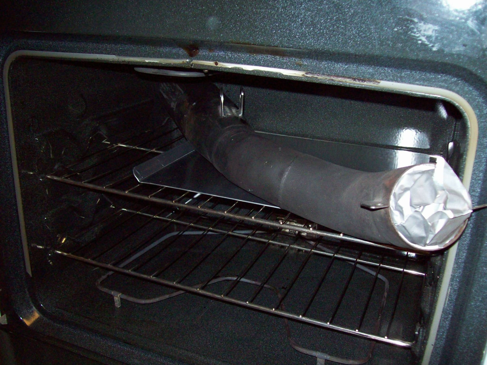

I believe the original Gun Kote is what KG calls their series 1600 coating.
Gun Kote has to be sprayed on parts pre-heated to 100 degrees or so.
Then after spraying the parts have to be baked at 300 to 325 degrees for at least one hour.
I use my family oven to cure my Gun Koted parts. The next 5 or 6 pizza's I cook in the oven do taste a bit funny after baking the Gun Koted parts!!!!!
