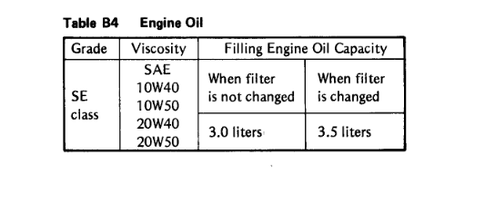

I’ll post up a YouTube video that shows how I did it but she lives now. Now to final tune the carbs and we will be set. I put on the advance weights and it fired right up. One question for you all. When I change the oil, the new oil doesn’t come up to the oil level window. I put 3.5L = 3.7Quarts I think the previous owner put too much oil in it because the window was full before I changed it, now it doesn’t.

If you bike has a centerstand put the bike on that. Check when the oil is cold. Start up the engine and run it for a couple of mins and then shut down. Check oil level after a few more mins.
Sometimes when the oil is nice and clean it can be over the window and fool you into thinking there is no oil.

I think Ed is right. I've done it. No more than 4 QTs. Start it up and the filter should take some then check again.

20 Aug 2021 17:58 - 20 Aug 2021 18:01Page 18 of the fsm says----I’ll post up a YouTube video that shows how I did it but she lives now. Now to final tune the carbs and we will be set. I put on the advance weights and it fired right up. One question for you all. When I change the oil, the new oil doesn’t come up to the oil level window. I put 3.5L = 3.7Quarts I think the previous owner put too much oil in it because the window was full before I changed it, now it doesn’t.
Like Ed said, run it a bit, then park it on the center stand for a few minutes or overnight before checking the level.
