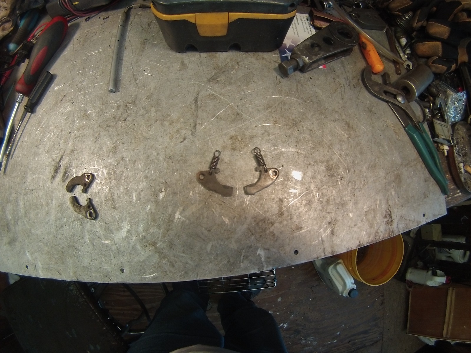

Most of the time the springs get weak causing idle issues. Some bend the spring loops to tighten them up. After playing around with different advances I bought one from Z1E for $150+ and hardly noticed the difference. I bought a used KZ 750 one from eBay for next to nothing for the springs. The plate I sent to one of our members. I've never seen one broken as you suggest. Are you sure the pins aren't bad.
This is what I have.
The larger ones look like yours.

I see it now. Let me know if you want them. Location and which set?

Yes y’all are correct, the pins that engage the weights have been broken off by the previous owner or maybe rust. But those definitely are the correct weights. Can you pm me and we can discuss how much you want for them and shipping and all of that? Those pins were actually broken when I pulled the whole assembly off, I just figured they were to ensure the rotor did not spin too far. Then once it clicked that there were slots for the dyna rotor to go in that those were actually broken off.
if you don’t mind I’d take the ones with the springs, as mine are slightly buggered as well.
