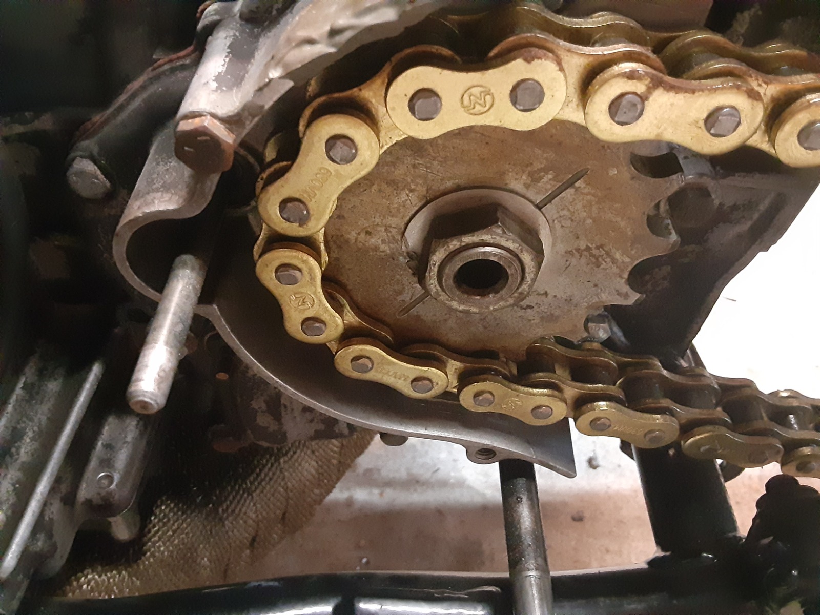

Yes, everything appears to be set correctly. I feel complete resistance when I pull the clutch lever. The rod is clearly not budging. I guess ill open the other side of the bike and post some pictures.

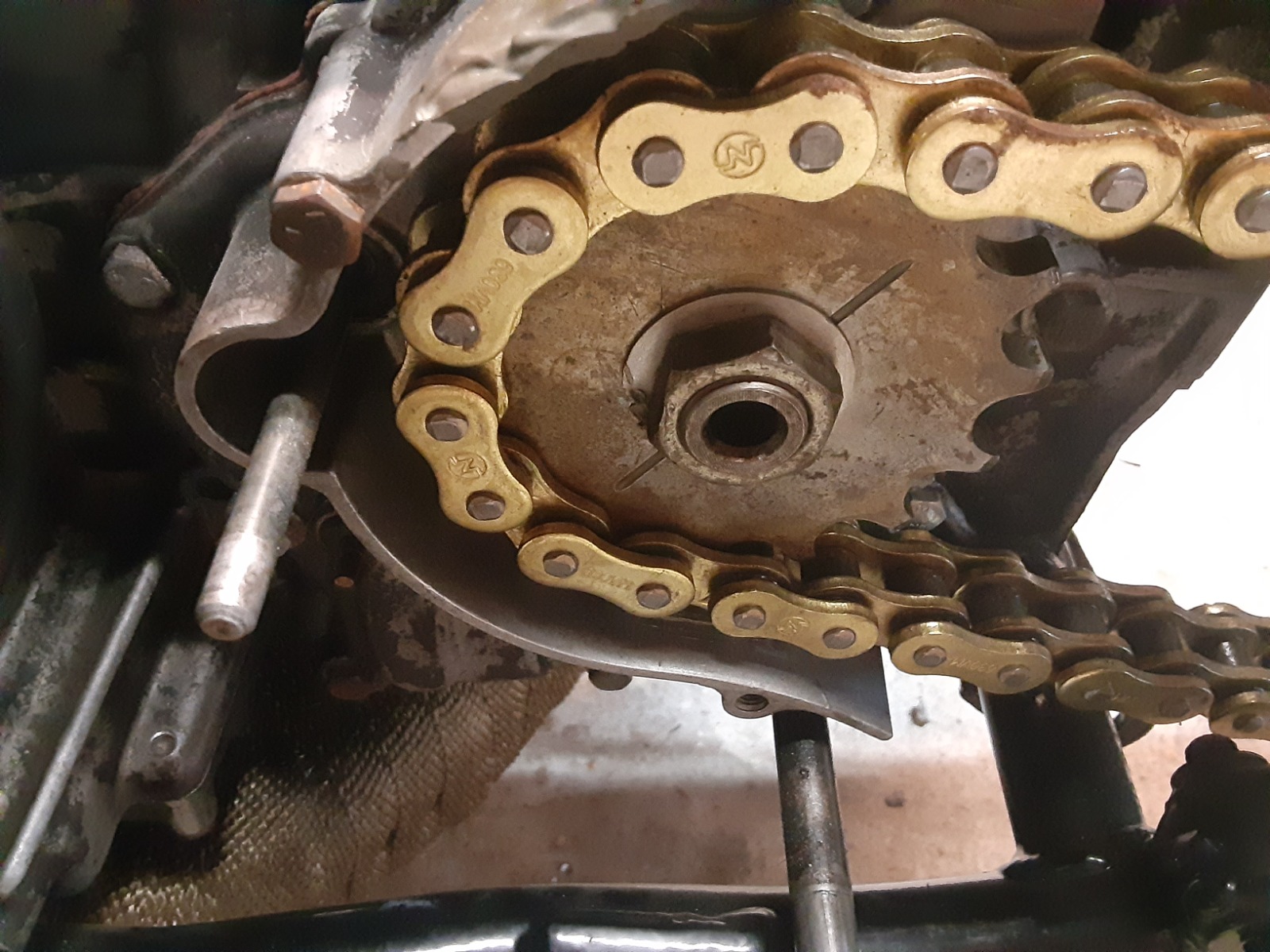

The bike is not in running condition yet. I will review those procedures and make sure I have done this correctly. Here are some pictures though:
