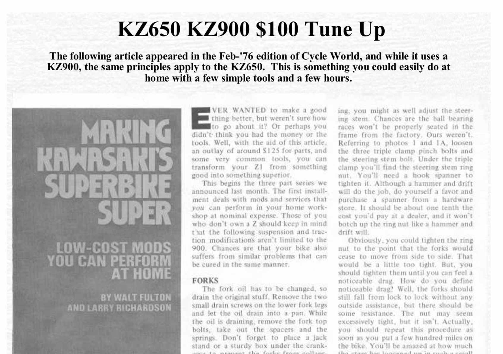

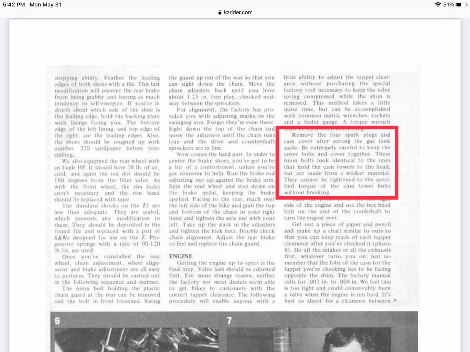

Because of the discussion with Robb2018 and his cam chain issues, reminded me I recently read an article in the file base. It’s a write up on getting top performance out of the Kz900. In the article it says to make sure you keep the cam cover bolts separate from the cam cap bolts. It mentions that although they are similar in looks the cover bolts are made of weaker material. I have heard of several guys snapping cam cap bolts within the torque spec. As anyone heard this and how would one confirm it. Also how would you separate them out of a pile. Here is the paragraph in the article.and a screen shot of the article title. Just thinking this could save us all headaches.

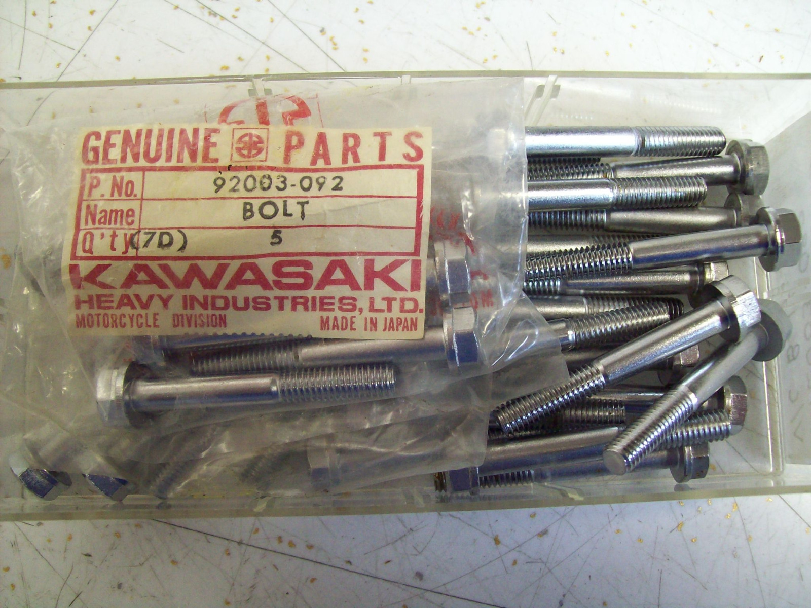

That is funny about the cam cover bolts being different than the bolts for the cam caps. Going by Kawasaki microfishe they use the very same bolt part number 92003-092 for the cam caps as the valve cover bolts on the '73~'75 Z1's,'76 Kz900 and the '77~78 Kz1000's!!!!!! Didn't look up the '79 and up Kz1000's. I myself have used that bolt 92003-092 in both locations since back in the '70's without ever snapping one in two pieces!!!!! And since I always have used shim under bucket setups. My cam cap bolts have been removed and reused probably 20 to 30 times!!!! Plus my cams had lifts from .410 to .440 thousands.
If the Kawasaki part number is the same for both bolts, they ARE the very same bolt!!!!! You don't call and ask Kawasaki for the 92003-092 bolts for the valve cover that are different than the 92003-092 bolts they use for the cam caps.......... Sounds like more internet bull@@@@ to me.
O.E.M. Kawasaki bolts part number 92003-092.
.440 lift cams in place using 92003-092 factory Kawasaki bolts.

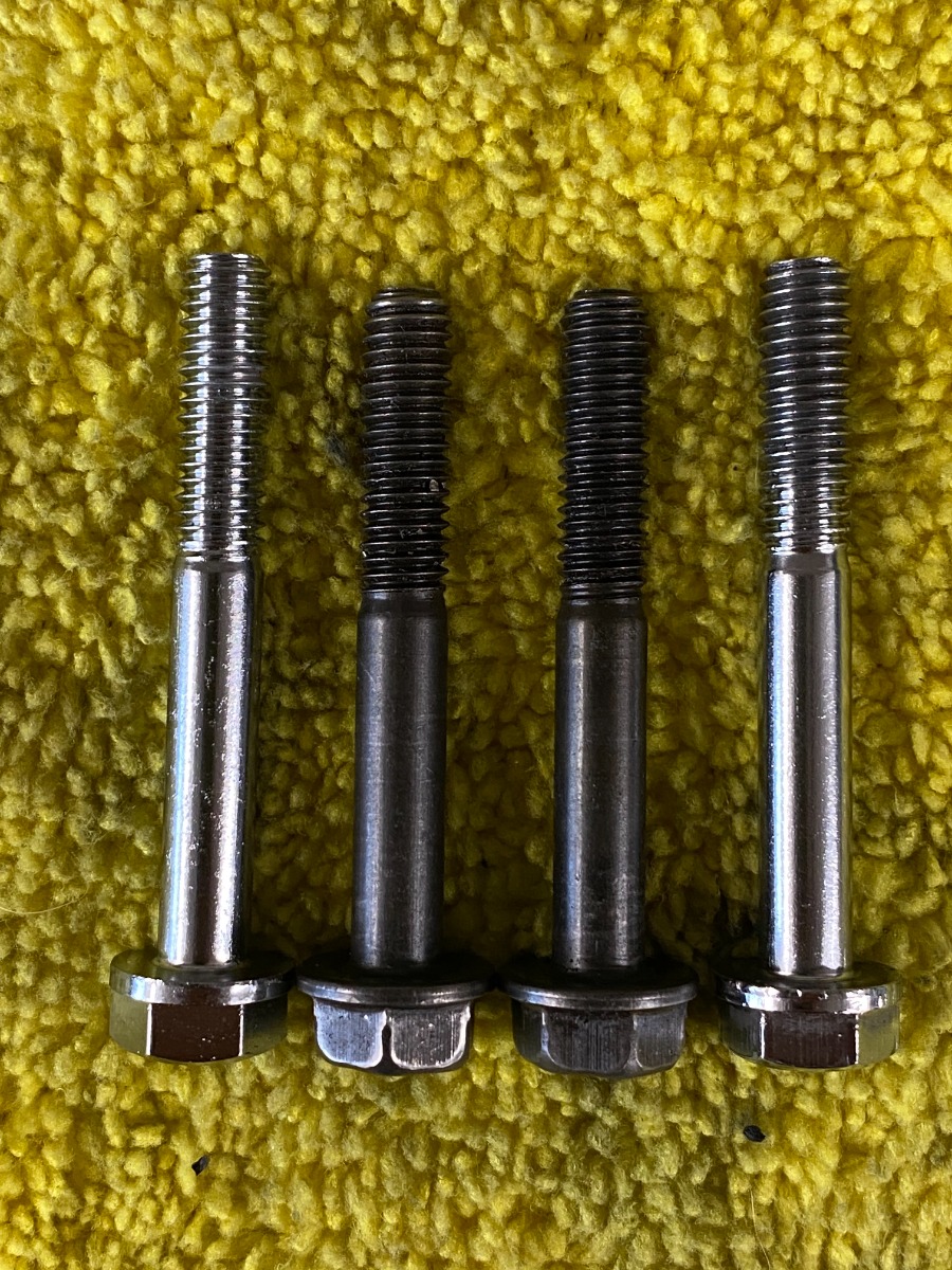

Some years ago I learned that early Zeds had black case hardened bolts for the cam caps. They were 43 mm long. At some point they increased the length to 45 mm and stopped using the case hardened ones. This may be the source of the warning but it would be impossible to mistake one for the other, as they are quite different as you can see in the photo. The thread length is the same but the overall length is different.
There may be a service bulletin for the switch. I have a PDF copy of them and will check.
