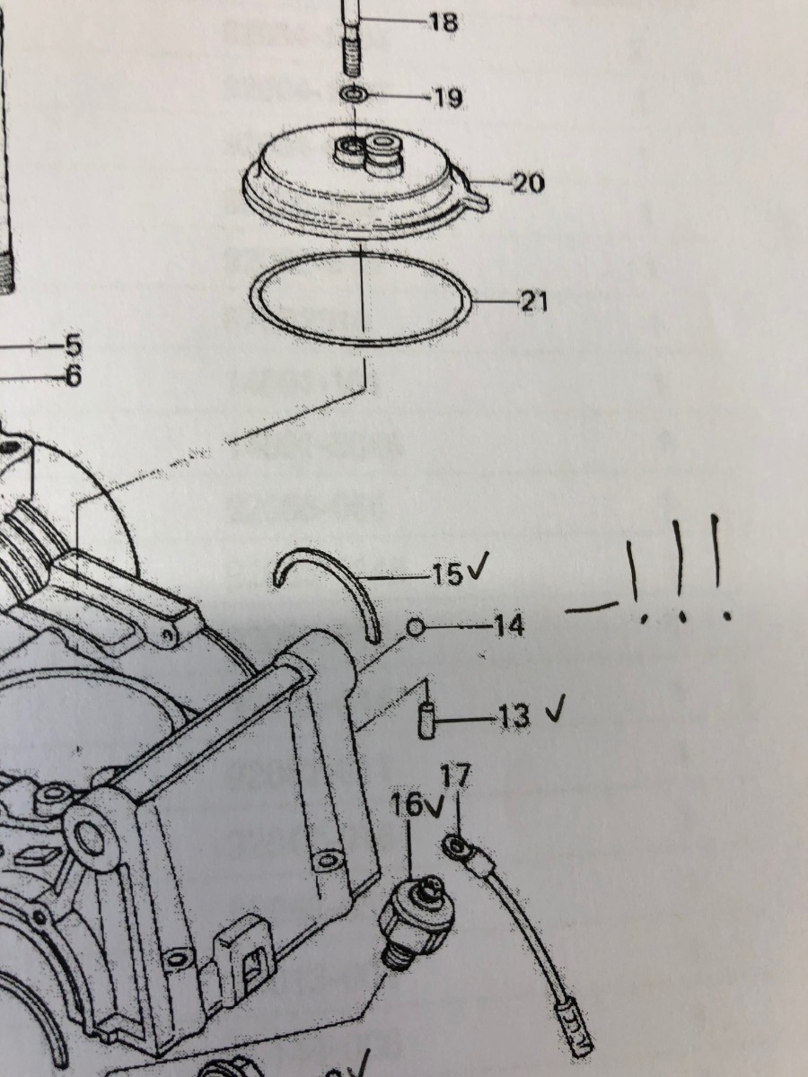

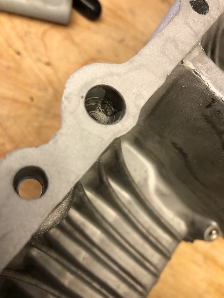

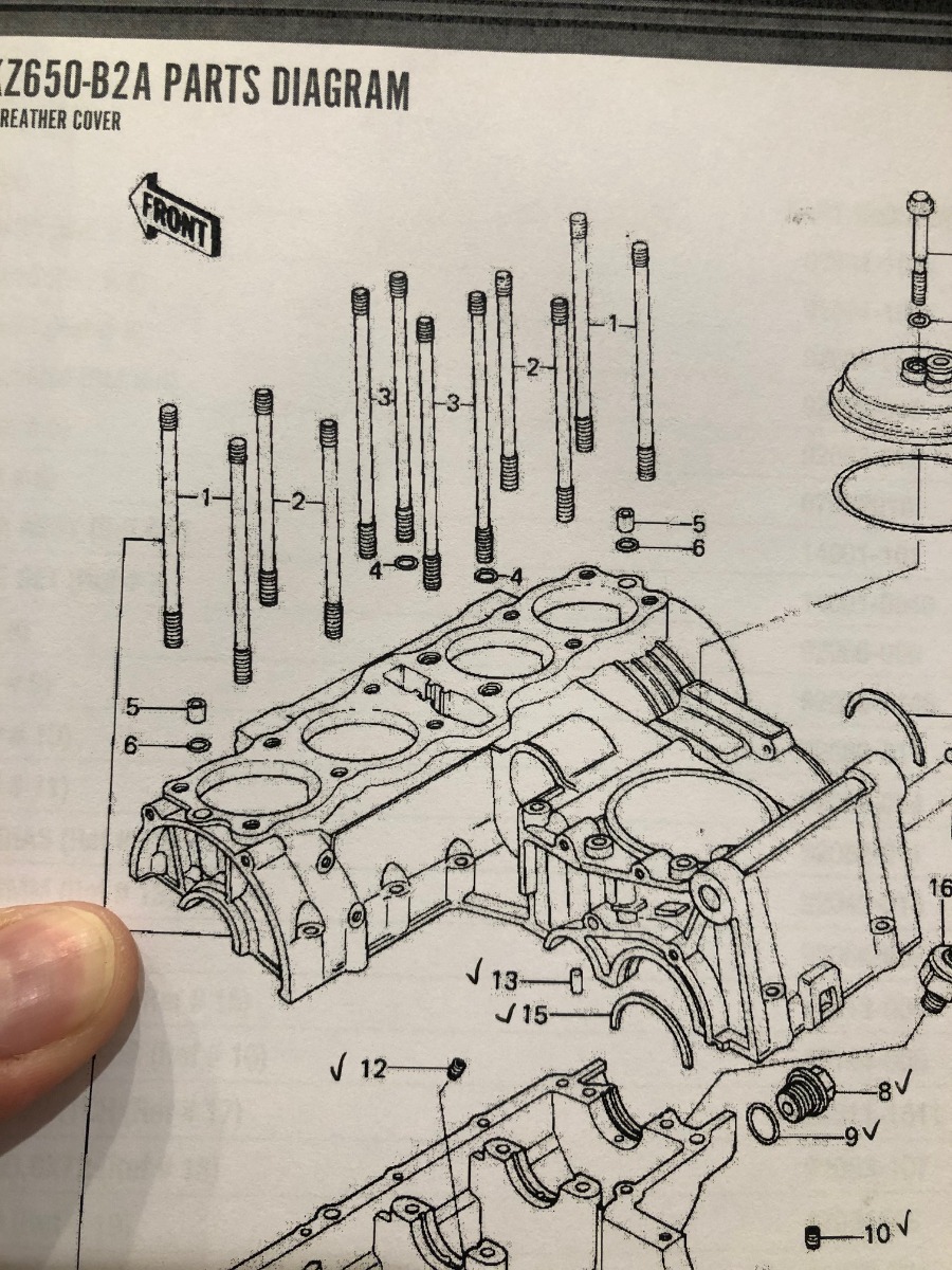

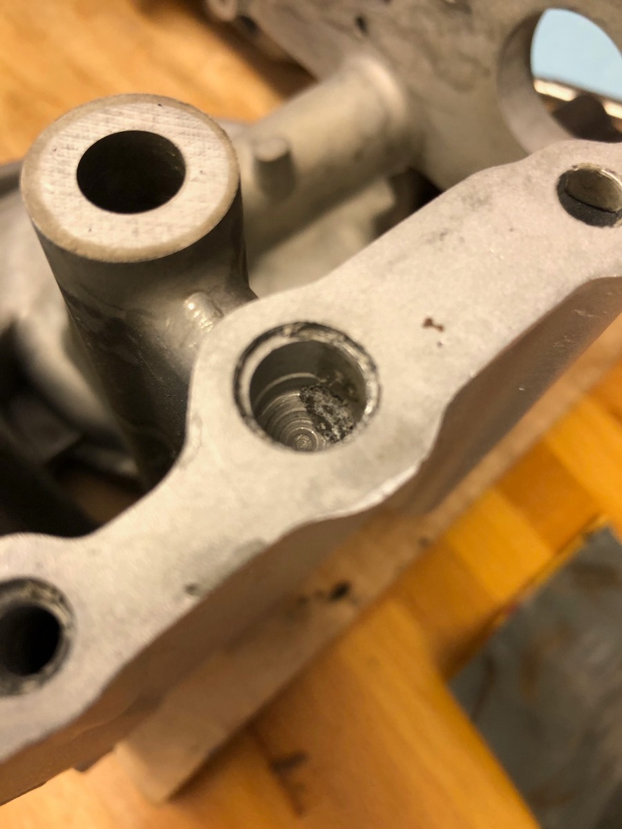

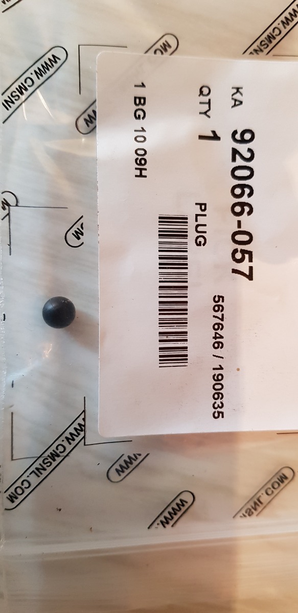

2 new questions as I go carefully through everything.

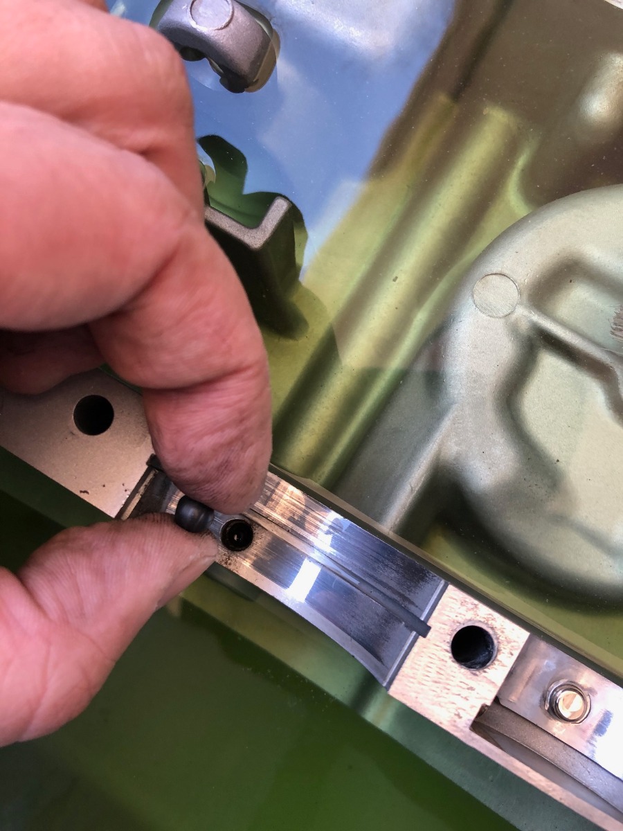

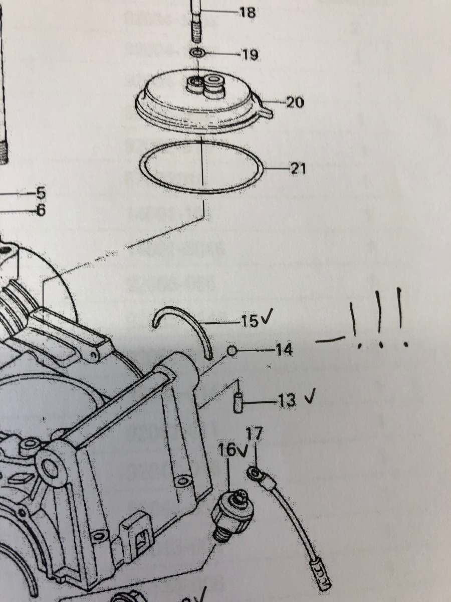

#1. Rubber ball. I lost it. Is it's only purpose is to block oil channel? If so, I could just replace it with silicone plug, correct?
#2. #4 o-rings. Do the go on top of stud or under stud, not clear to me where it should be and what is the purpose? Only 2 studs?

#1 = It´s not a rubber ball, it´s a formed kind of liquid gasket stuff that finds his way to plug your oil gallery/passage!!! The port have to be open to build up oil pressure for the cam bearing!!! Check all oil ports are free and not clogged with such kind of sh*t with compressed air!!!
#2 = i have no idea, please ask the 650 experts...
Last edit: 25 Apr 2021 13:39 by Scirocco.

Re: kz650 1978 Q/A
25 Apr 2021 14:04 - 25 Apr 2021 14:04Sorry, but you are wrong. It is rubber ball, see #14 on parts diagram. I held it in my hand and I have PN, just curious what it's for, need to be there.. It's not crankshaft, it's gearbox shaft.#1 = It´s not a rubber ball, it´s a formed kind of liquid gasket stuff that finds his way to plug your oil gallery/passage!!! The port have to be open to build up oil pressure for the cam bearing!!! Check all oil ports are free and not clogged with such kind of sh*t with compressed air!!!

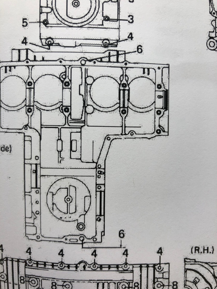

Question #3
Parts diagram seem to be wrong on dowels, it's locations and qty.. I found some inaccurate places, but those on front back (#6) - I didn't have them, only on sides. Does it look correct?

Re: kz650 1978 Q/A
26 Apr 2021 07:00 - 26 Apr 2021 07:03
Those 2 o rings #4 go at the bottom of the #3 stud (next to #3 piston and cam chain opening). If you look you will see a cut out for them to fit into. Keep that rubber ball away from the bearing for sure. I can't really help you on its location or help with the dowels (didn't split the case) but if you look at the diagram at Partzilla it shows those 2 #6 dowel pins and they sell them.
