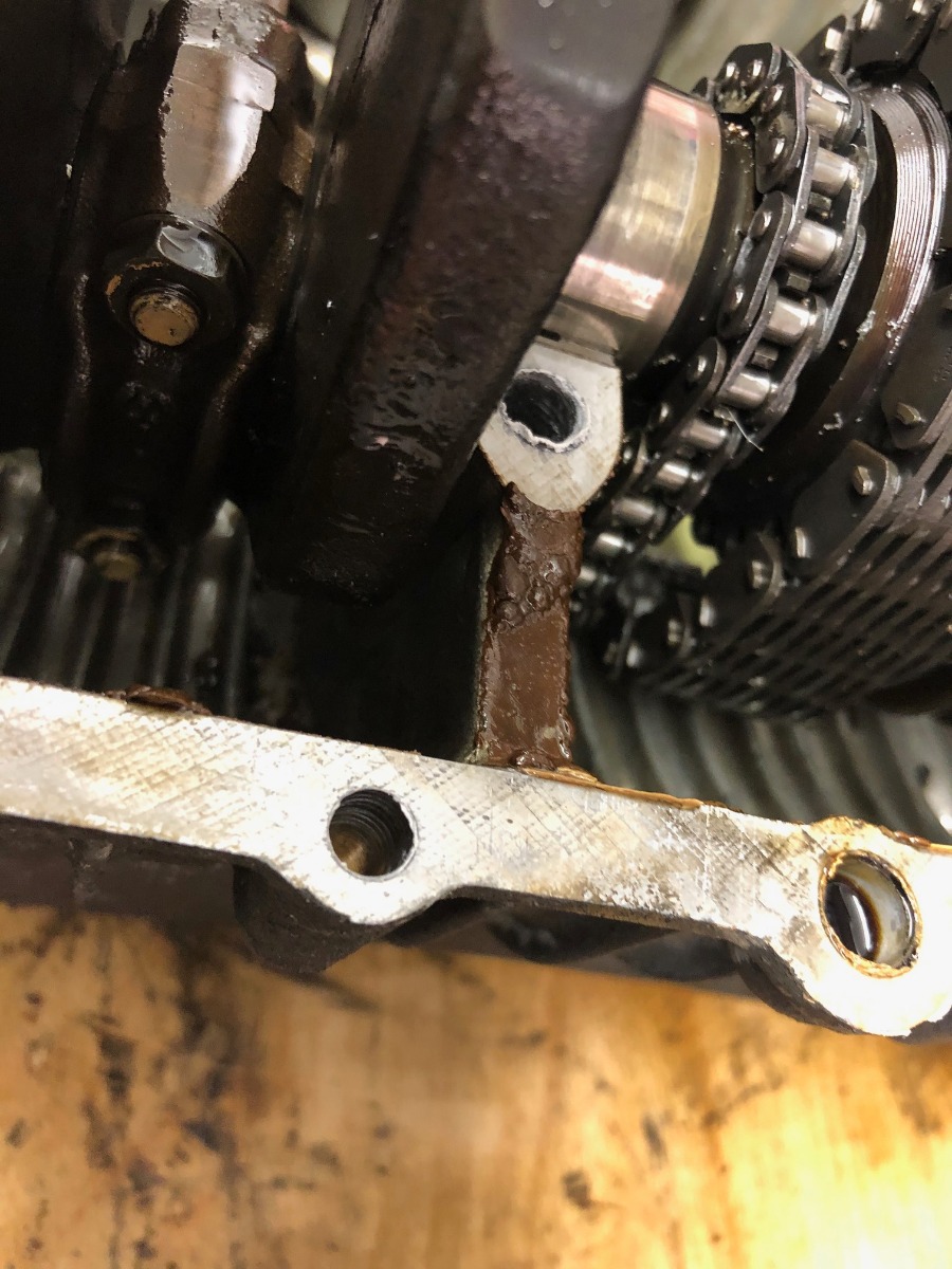

In process of rebuilding engine. Cases split and I have bunch of questions
1. What is this white stuff on bolts? Is that a factory thread locker? I don't see any indication of someone being in engine yet but I do see engine assembled with white paint-like sealant. there is even runs. See on picture, some of it is next to crank on areas not even needed. What's interesting - left side bolts have a lot of it on threads and right side bolts - none. So, what should I use for reassembly and do I need any thread locker on bolts?

#1 The white residue looks like the remnants of 40+ year old ThreeBond case sealer to me. It was very thin, and at the time probably still applied with a brush, I usually used my trigger finger. No factory thread locker on bolts.

1 - Probably engine case sealer.
2 - For base and head gaskets, use OEM. For the rest it doesn't matter much. Use 3 bond to seal your cases. Spread thinly.
