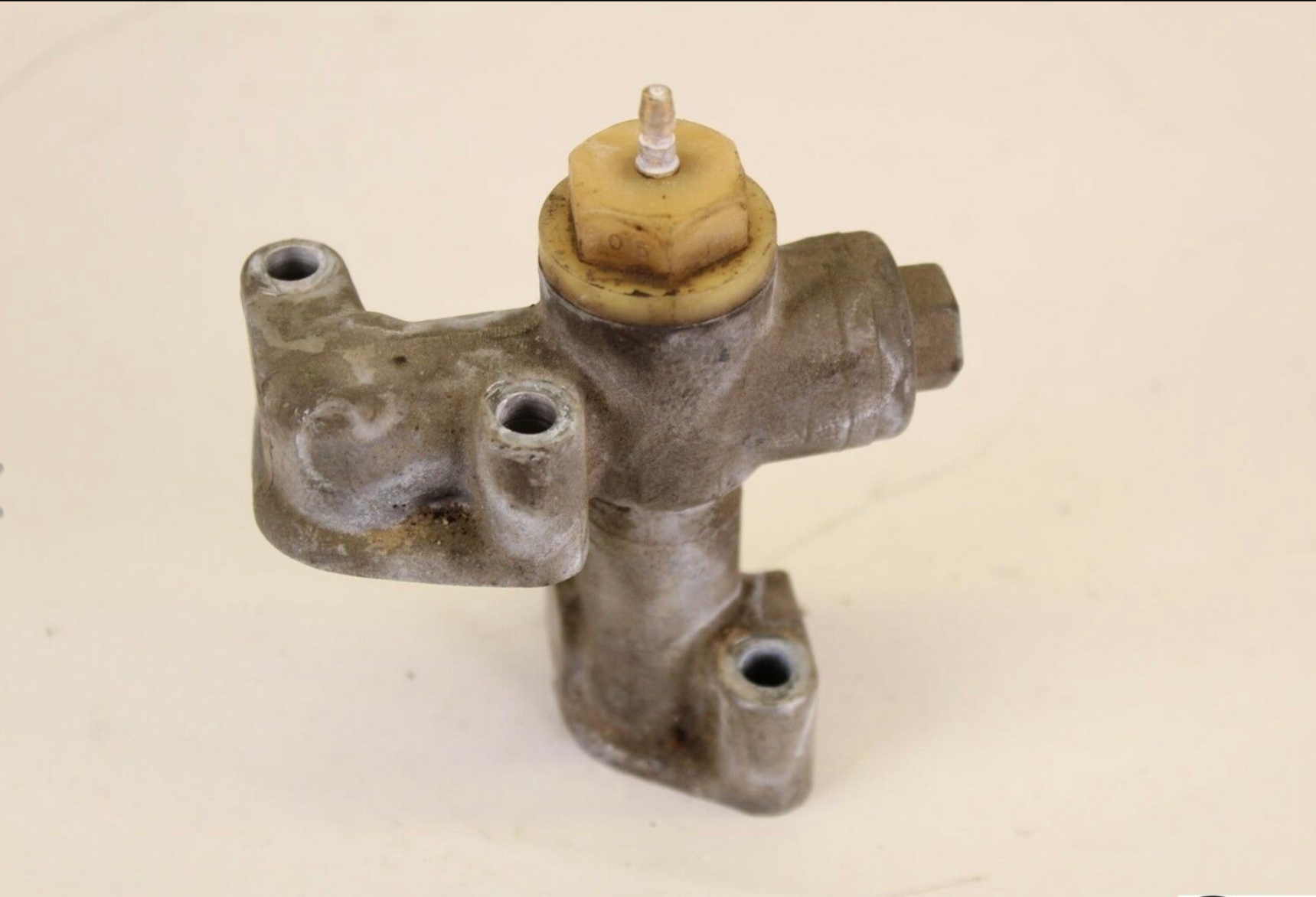

This is the stock oil tube, with oil pressure sending unit.

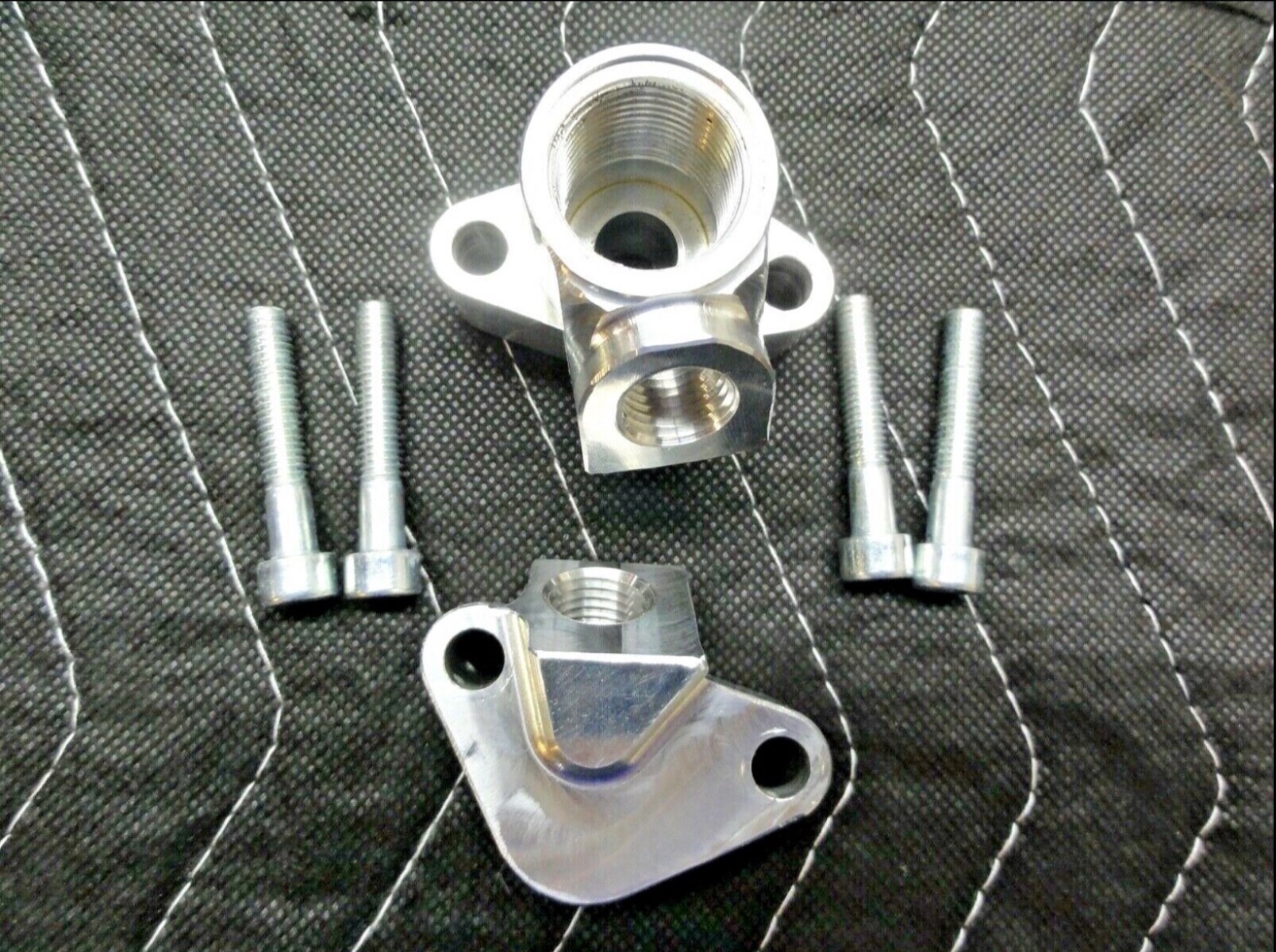

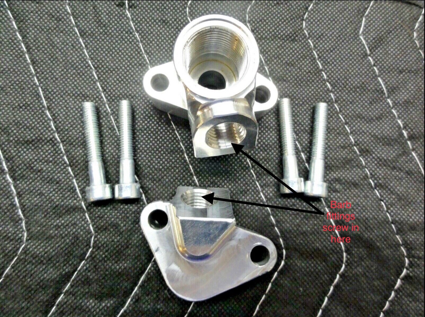

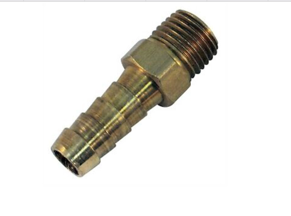

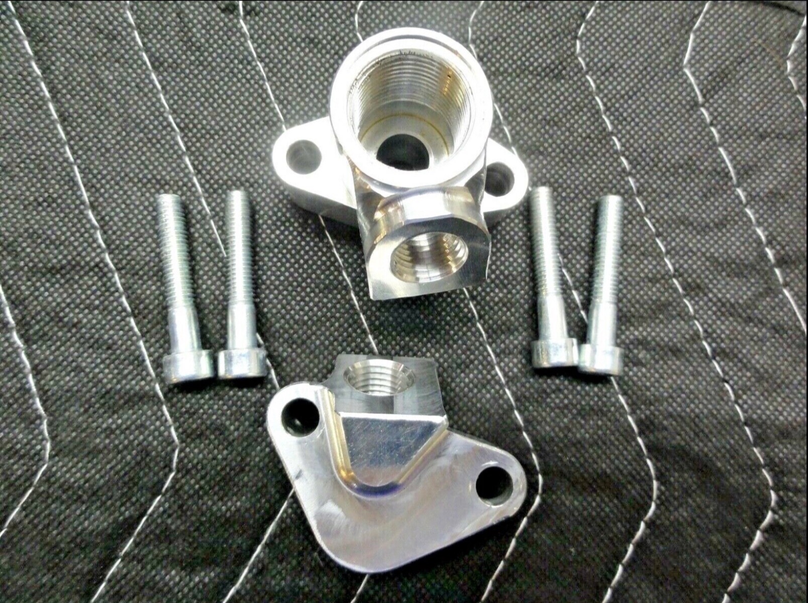

This is after market oil cooler adapters. If you have these with a hose jumpered between them then you can easily mount a cooler to the front down tubes and route hoses to these fittings. These fittings fit n place of the stock oil tube and will need screw in hose barb fittings

I have the after market fittings on the bike but no cooler. For now, I have joined the two oil ports with a length of hose. Can i plug off both ports if I decide not to install a cooler?
- Posts: 5193
- Thanks: 2340
Re: Oil Coolers
07 Mar 2021 09:53KennyJ wrote: I have the after market fittings on the bike but no cooler. For now, I have joined the two oil ports with a length of hose. Can i plug off both ports if I decide not to install a cooler?
NO, NO NO
Get the stock piece shown by MIKAW
If you plug both as you suggest the oil pump is cut off from the motor
Catastrophic failure will result

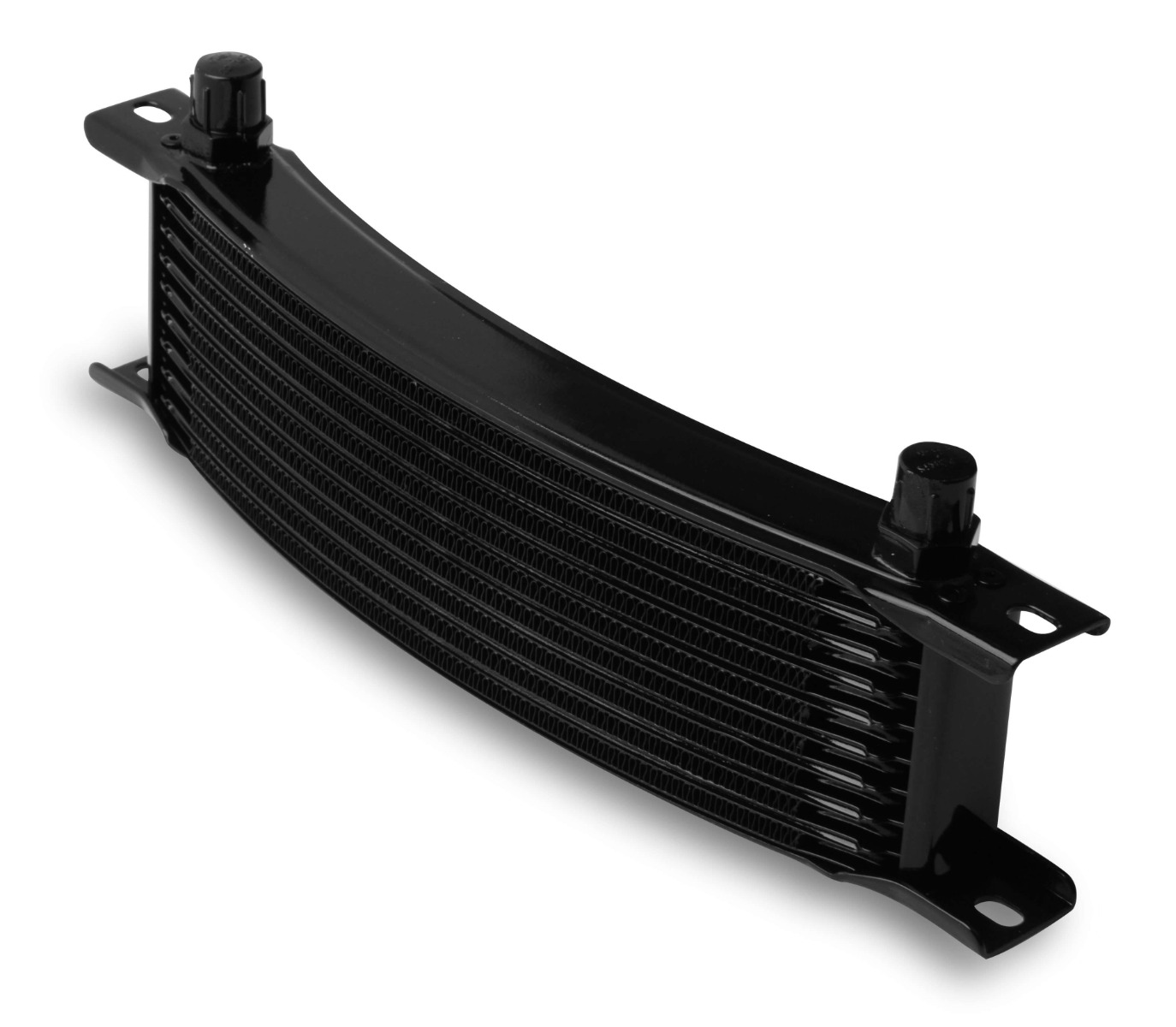

09 Mar 2021 17:02Here is a example of a Earls cooler These are top shelf items
Lots of choice's . styles and sizes and fitting options too..
. Holley distributes them among others

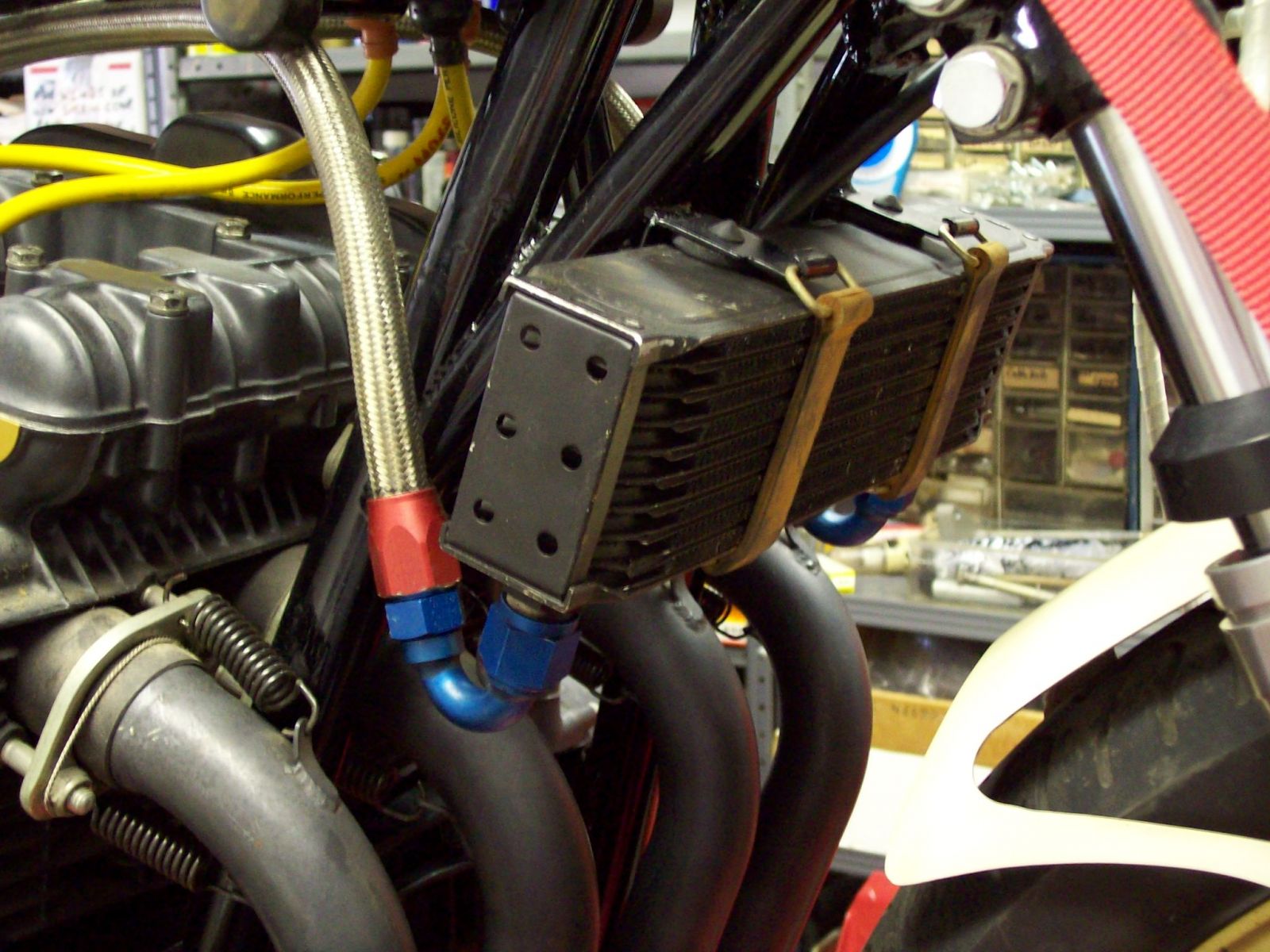

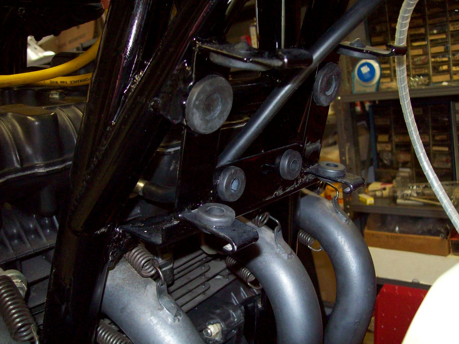

Like Mr. Dave said, Earl's Supply coolers are one of the best you can buy. They like to be rubber mounted to keep the amount of vibration to the cooler to a minimum.
The Earl's coolers are also set up to use braided steel line and AN fittings. No Mickey Mouse rubber oil lines!!!!
This Earl's cooler has been on my bike since back in 1982. You can see how it sits on rubber grommets inside the cooler mount.

09 Mar 2021 22:28Dr. Gamma wrote: Like Mr. Dave said, Earl's Supply coolers are one of the best you can buy. They like to be rubber mounted to keep the amount of vibration to the cooler to a minimum.
Dr. Gamma, where did you get that oil cooler mount ?
Re: Oil Coolers
10 Mar 2021 08:58
That mount is home made out of battery box rubber dampers, I see an electro plate grommet in there as well. The straps are Z1 battery hold down... I love the uses of what’s on the shelf ingenuity
