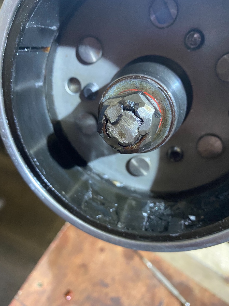

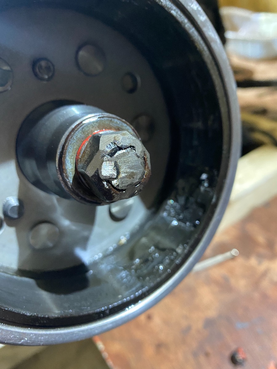

So early this year I fell into the trap of cheap project bike what could go wrong... well everything. Polish bike,, 650 euro and 300 to ship , they are a rare bike over here...perfect. I’ll be posting a build thread at some stage when I’m not so angry about the whole affair but for now I thought I’d share the last 2 days nightmare. If I could only understand the reason behind the thought process of some "mechanics" and I use the term loose.. like real loose. I finally got the time to make a start on the engine, strip it back, put in new seals and gaskets as she was caked in oil. In my head I’m thinking what’s the worst that could go wrong... well I’ll show you. First thing even before the motor came out of the frame was this.
Fairly hacked up but iv seen worse.

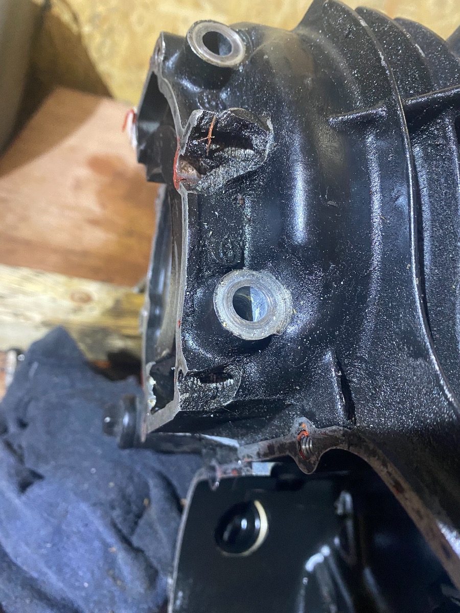

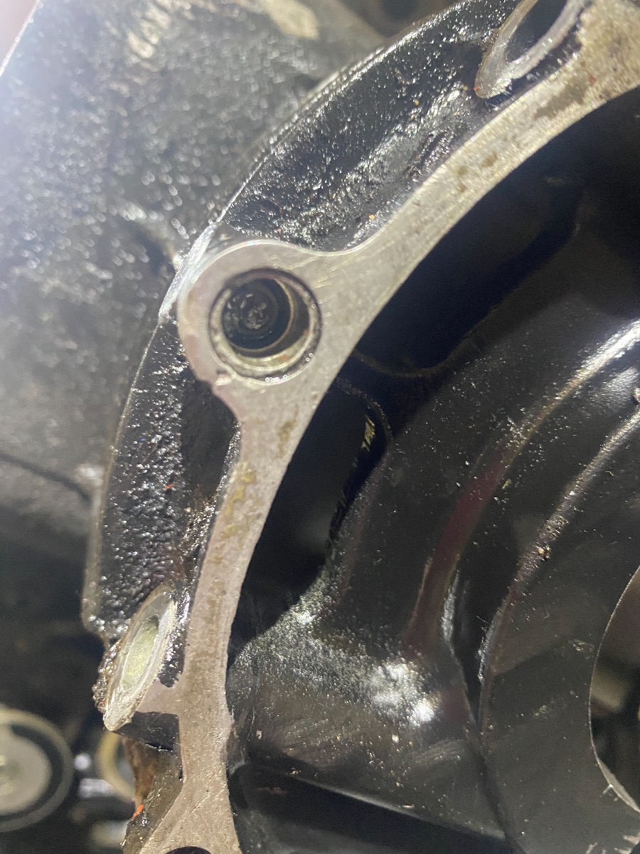

Then there was the 6 bolts broken in the casings, these we all filled in with gasket seal in a failed attempt to stop oil from coming out, hence the oil caked engine. That aside i figured a day getting them out would be on the cards.

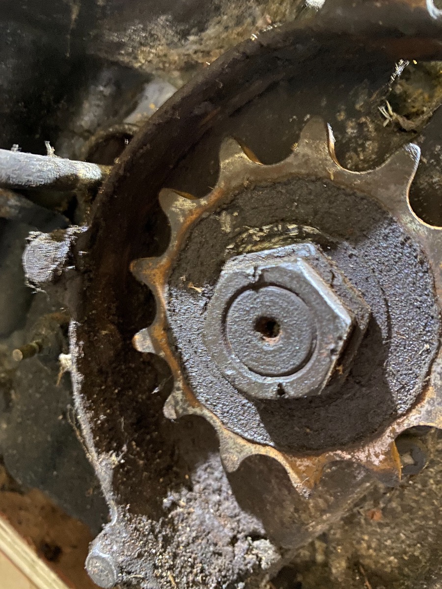

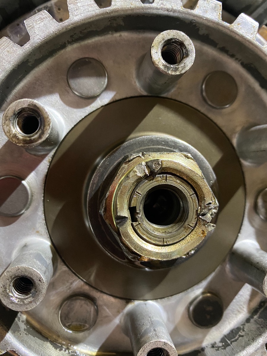

Then came this.
I knew I was dealing with someone special when I saw how hacked up the clutch housing nut was and I knew that this had been opened up before and the was more to come.

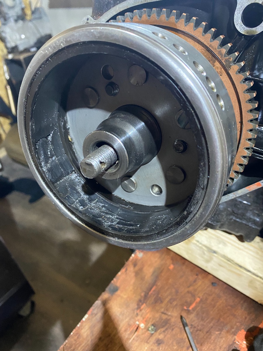

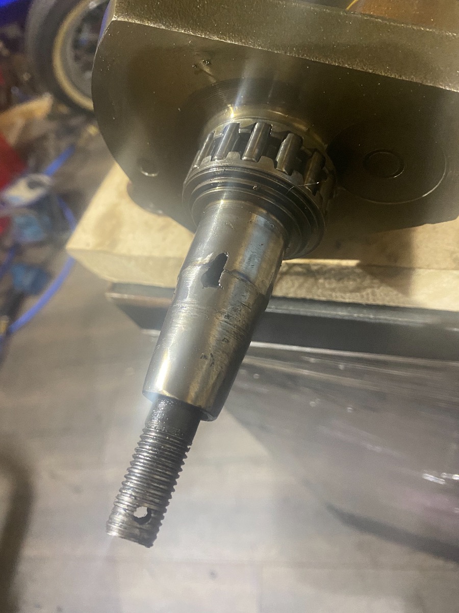

Outside of the jack job on the nut the housing is in real good nick , so I turned my attention to the other side and that when I saw what ruined my day.

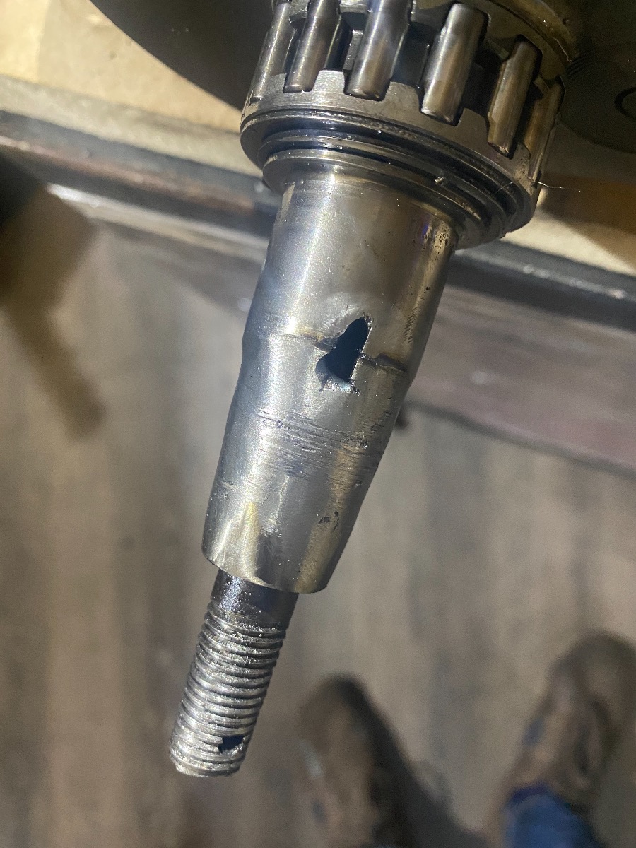

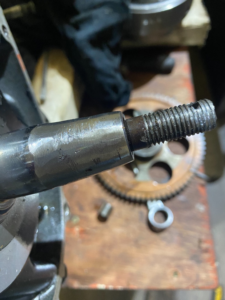

WTF ? Excuse my abbreviations. So I got the nut off and about an hour or so later I got the beaten up flywheel off and then the mother of all kicks in the nads.... was this.

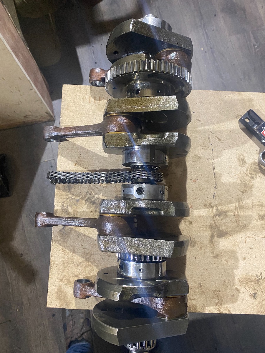

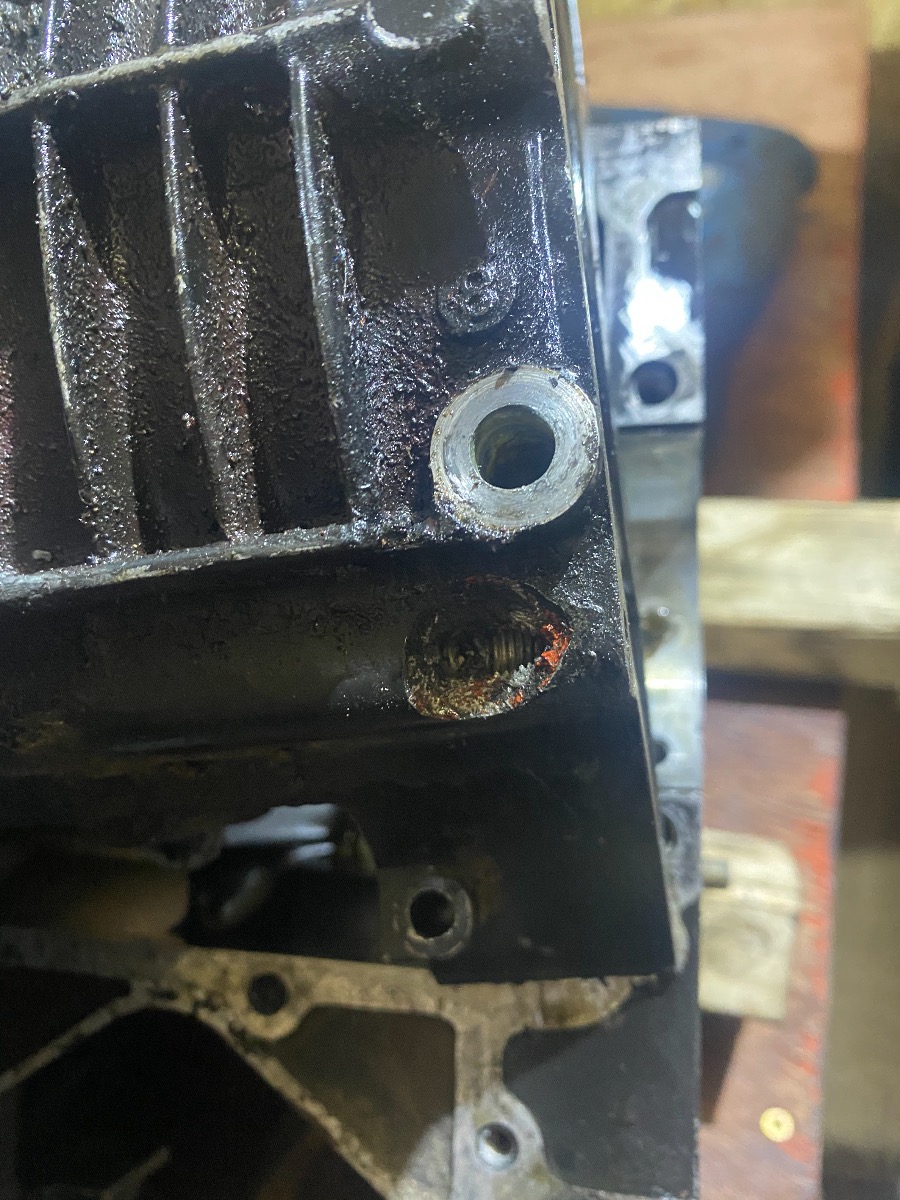

So the crank is junk and the most annoying thing is that its a perfect crank outside that, i just cant understand, why any one would do that? Its the hack job of all hack jobs. So long story short, i need a new crank and new cases as on closer inspection the lower case is junk too. there are way too.. and i was in a good mood this morning. P.s im sorry for the video error things, i used an iphone 11 and i cant get rid of them now.

Here is a photo of how perfect the crank .....was and the hack job on the casing by over tightening bolts.

That crank end was not Red Loc-Tite
That was ARC tite!! :laugh: As in Arc Welded with a Lincoln Buzz Box 225
I welded Harley Guys center pin for the rods and flywheels on big stroker motors That always loosened years ago.

19 Jan 2021 13:30If it was a welded bolt id be ok with that...kinda. its welding of a thread one size down from the bolt that should have gone there and then the grinding down of the shaft after. For what though? cause they couldn't find a bolt to fit? the logic still has my head scratching.z1kzonly wrote: That crank end was not Red Loc-Tite
