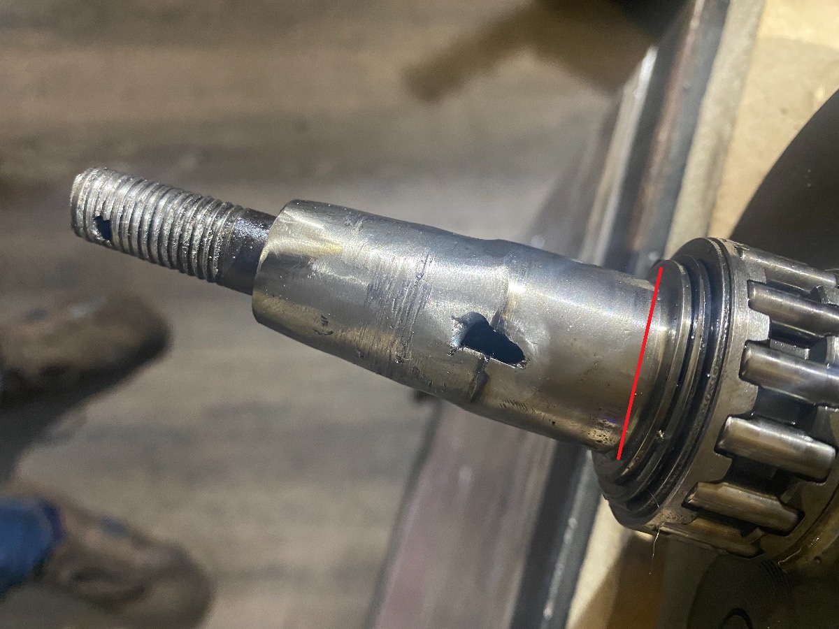

22 Jan 2021 13:02kzstreetfighter71 wrote: On anther note, My engineer mate says that there is a way of fixing the crank, cases are junk,,, but i also have a spare head... so when the crank if sorted ill have a crank, head, maybe a frame.. and a full injection system, loom, front end and back end bar the wheels... maybe a whole other bike someday? fingers crossed. Im going to bite the bullet and start a build thread on Sunday when i can get photos uploaded.
We are lucky here in the USA because there are a few good crank guys around. They can press apart the assembly and replace any pieces and bearings that need refreshing. It's not cheap, but the crank will be as good or better than new when done.

Since Brexit the doors to the German market are opening wider and that's a big market for us over here, slightly more on shipping but it no duty on imports but i cant speak German. So Nessim im dropping off a few bits to a auto engineering firm in Dublin next week hopefully and they will press the flywheel side off, my engineer/tool maker mate will "part off" the offending piece here at the red line. with a recess.
Then make a new one and press it in, return the whole piece to the engineering firm that will repress it into the crank and balance the whole. If all goes to plan. It will cost nearly as much as buying one but the 18mm 1984 Gpz1100 crank is like gold dust over here.

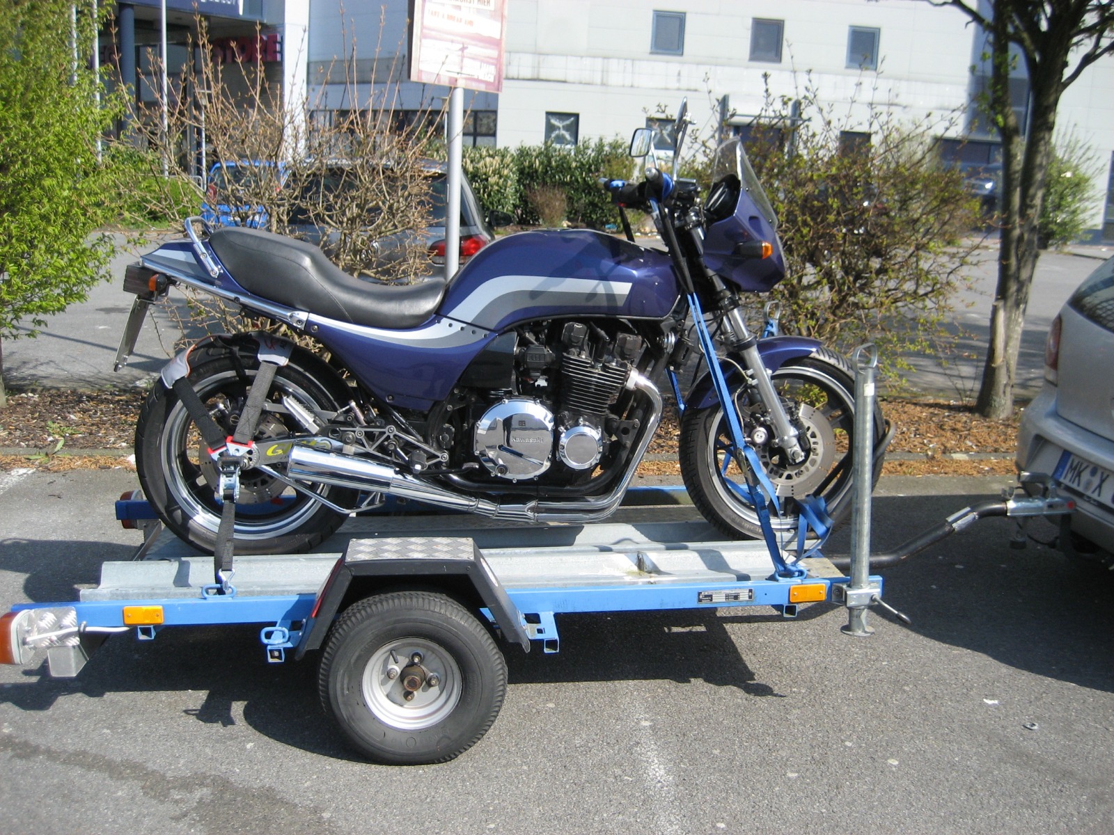

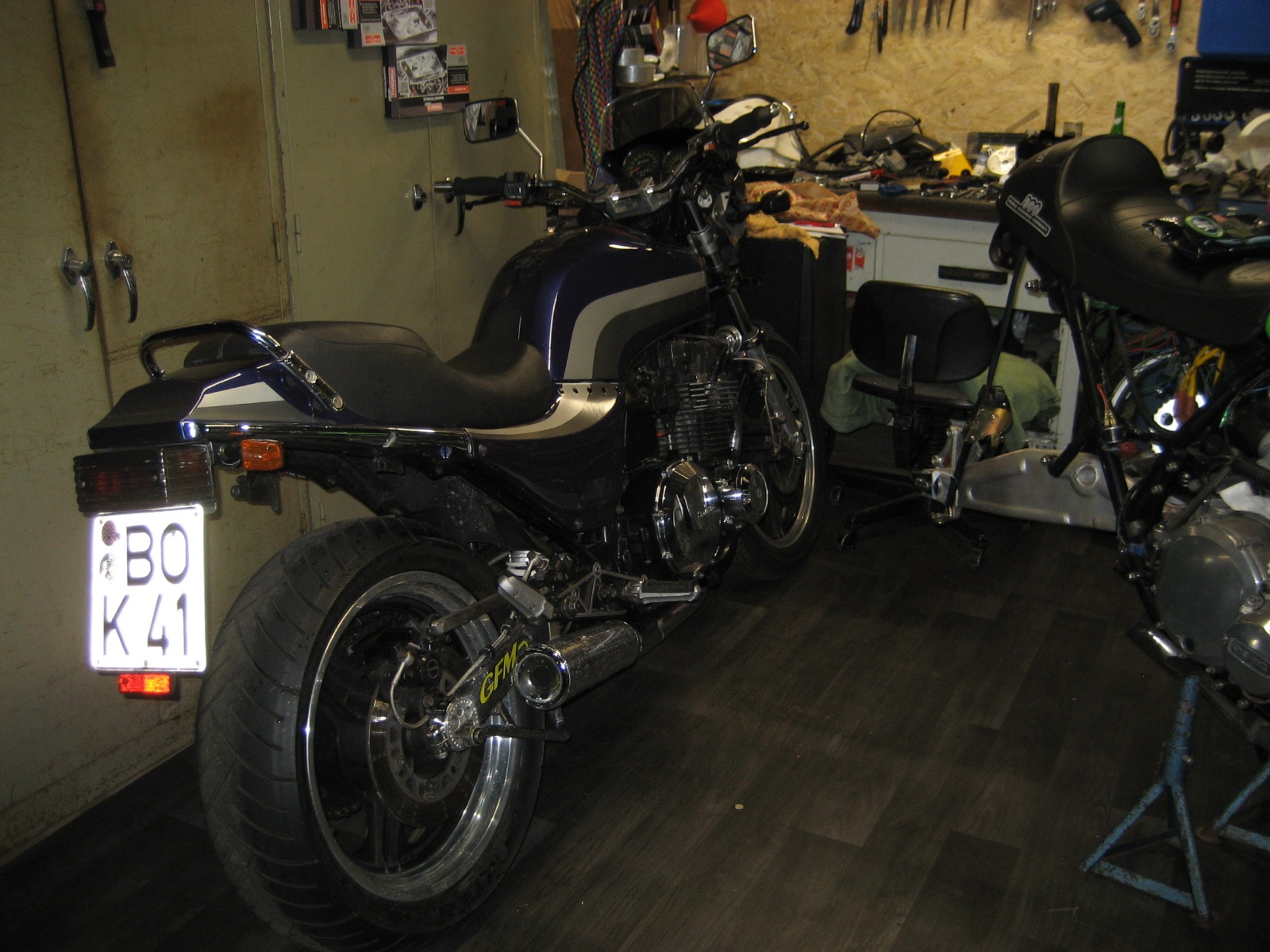

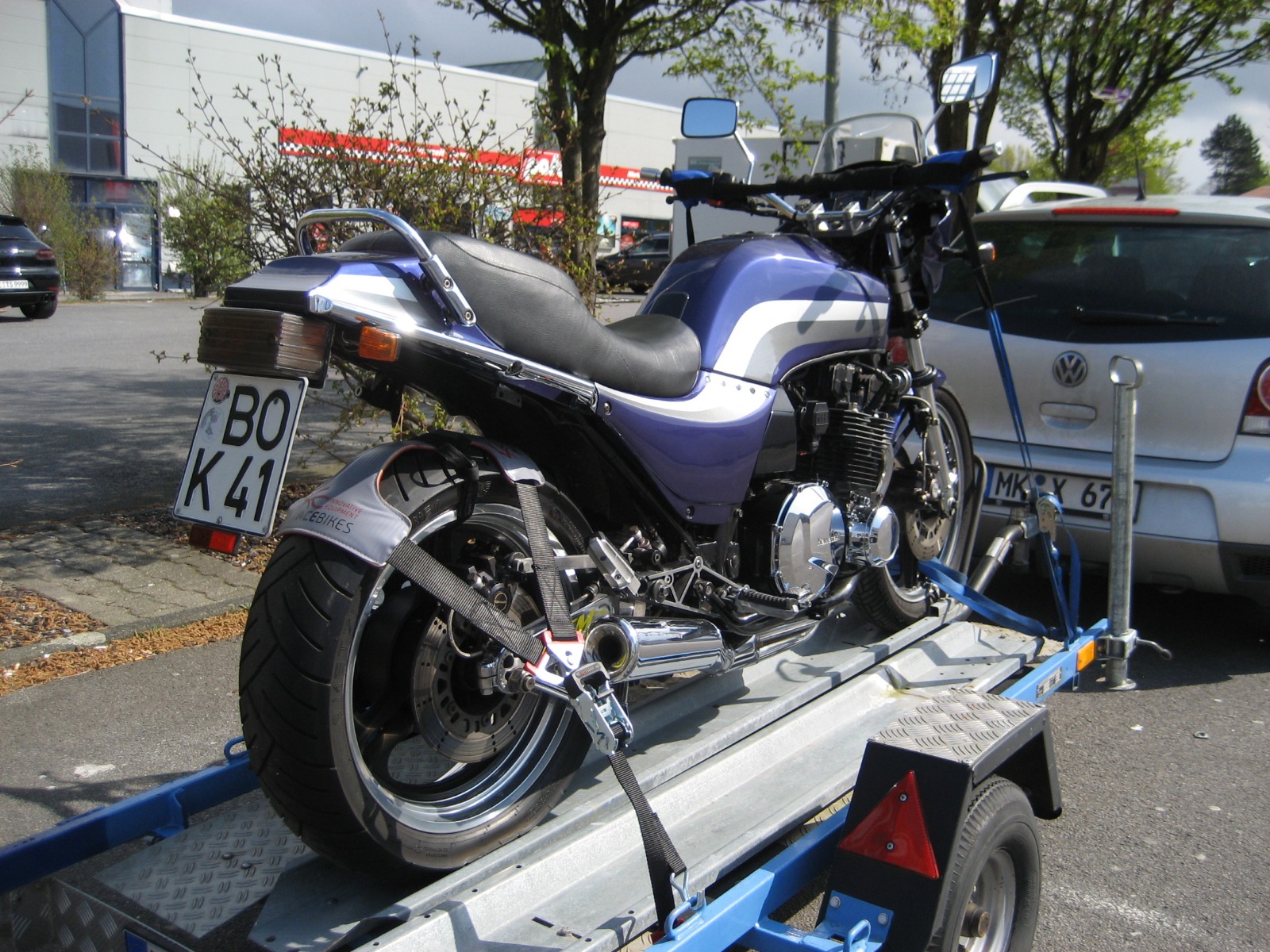

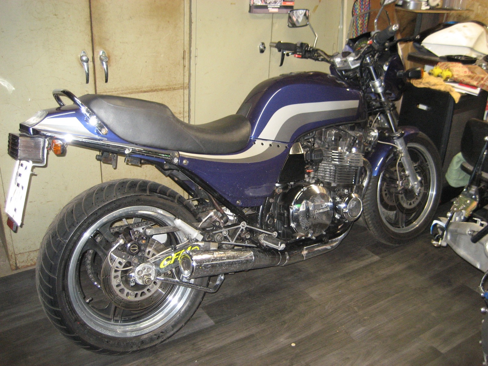

If you need GPZ 1100 UT parts or a nearly complete donor bike with title (cylinder head removed).
If you have interest i can take more detailed pics.
Some special parts are a spread/rewelded rear wheel (5.00 x 17), White Power rear suspention, GMF Performance rear swing arm.
Location is Germany. Asking 800 Euro and it is your bike.

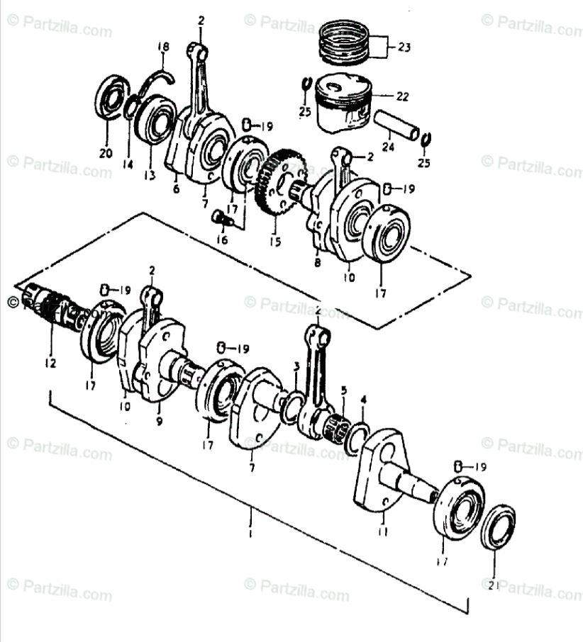

Kawasaki doesn't sell crankshaft parts but this illustration from the Suzuki GS parts fishe shows a GS1000 crankshaft which is very similar. If you took that crank to a crank builder they would press apart the joints and replace the end part #11 shown below.

23 Jan 2021 00:51 - 23 Jan 2021 00:53She will have a new home in Ireland!Scirocco wrote: If you need GPZ 1100 UT parts or a nearly complete donor bike with title (cylinder head removed).
P.m sent mate.
Last edit: 23 Jan 2021 00:53 by kzstreetfighter71.
Re: My Gpz1100 nightmare project bike “ warning explicit photos”
25 Jan 2021 12:08
E-mail send with the pics.

05 Feb 2021 01:29
The pictures of Sciroco's bike look good.I have 3 registered 1100Ut's,one has an 1100 B2 bored out to 1200 engine.I also have aB2 with a UT engine,and sometime will build another.I'll keep the engines I have ,but do have lots of bodywork.Most of the bodywork I have will need painting.You said your's is a1984,so should be an A2,with the inner faring,bigger (longer) fork yokes(and therefore frame at the front),and if the original exhaust is fitted,no kawasaki badges on the exhaust,and 2 bolt fittings for the silencers.
I also have original exhausts,shipping could be expensive though,and finding a box to fit culd be difficult!
