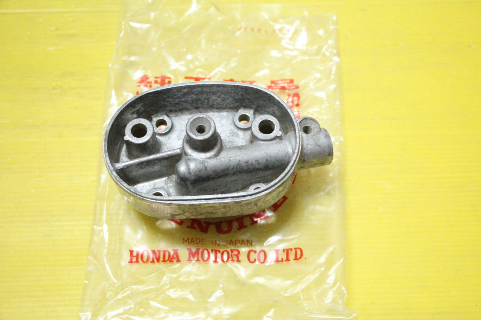

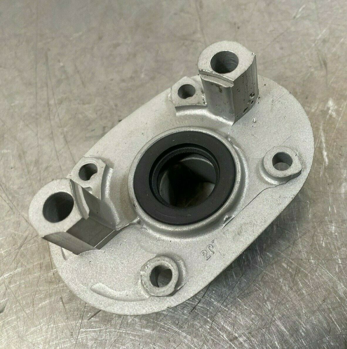

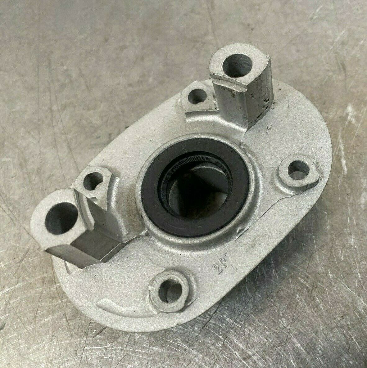

They had issues with top end oiling depending on jets to oil the rocker arms. The CB 350 four had the same problems along with no cam bearings. My CL 350 had two cam bearing/rocker side end covers that would be destroyed if a oiling problem occured. All had high pressure oiling systems. The Cl/CB/SL didn't have a filter. It had a centrifugal filter that would get full of gunge quickly. I loved my Honda but I was happy to find the Z1's had REAL bearings that could be replaced if needed. IMO that with the rest of the features make the Z1/KZ engines far superior to the competters.
Miller was the Honda guy and could make them MOVE but but he admitted that was the major flaw in their design. Eating cams and lunching heads. :whistle:
