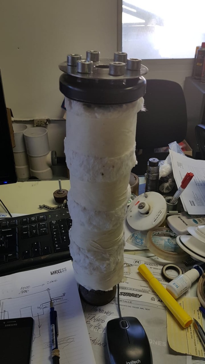

- undiablo
- Posts: 435
- Thanks: 64
Re: Megaphone Baffle Packing
03 Sep 2020 12:08
Kawasaki KZ 750/4 LTD 1981
Kawasaki KLR 650 2011
Argentina - Buenos Aires
