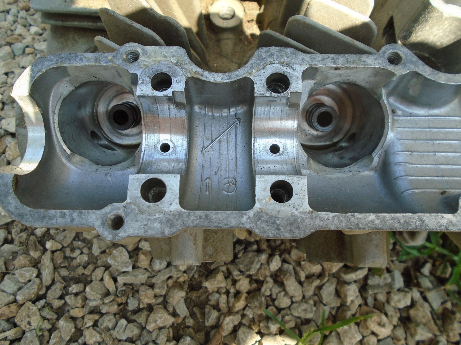

Asphalt900 have you had a chance to check the lift on yours? Did the head it was in have any clearance cuts?

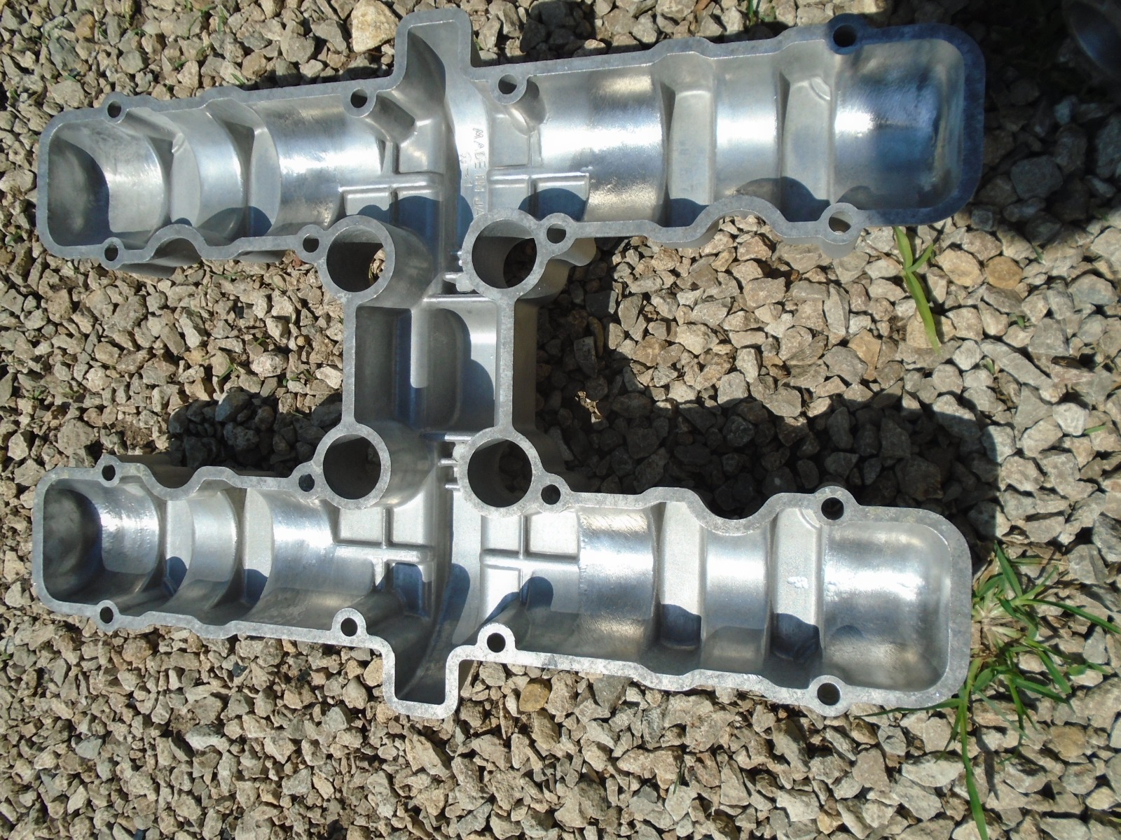

05 Sep 2020 11:53
Mikaw i didn't even take a measurement before i sent them back to the owner of the engine, SORRY. He just brings me engines he purchases and i re-do them to original form. But Yes the typical bucket relief and x's ground off the camcover. The bucket bores for the head must of had some residual blast media in them because bores are in piss-poor shape. He dropped off this engine and picked-up the one i finished. Drove 13HRS and back 13HRS and still had enough energy to set it in the frame when he got home. And he is 70YRS old. I'll never complain again about being only 56, Ha.
