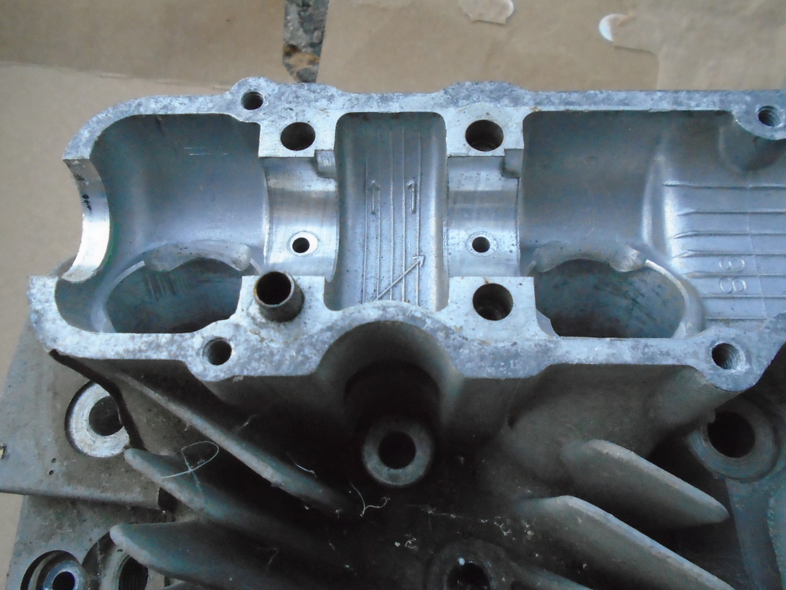

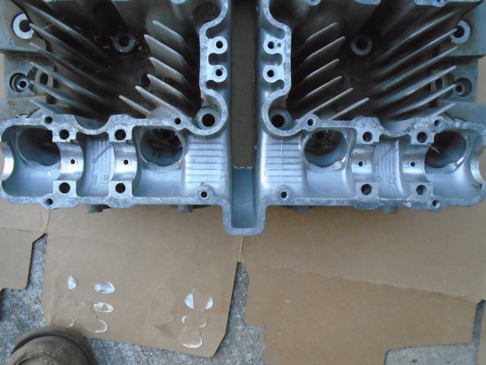

Here are some snapshots of the head they came out of Matt. Yes typical relief of bucket bores and X's removed from camcover.

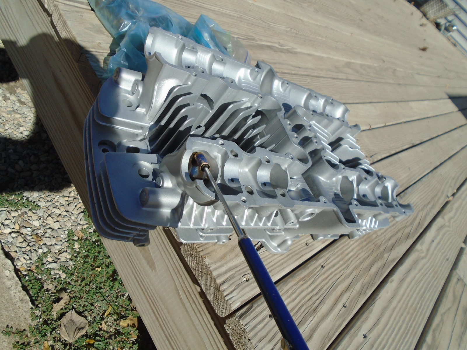

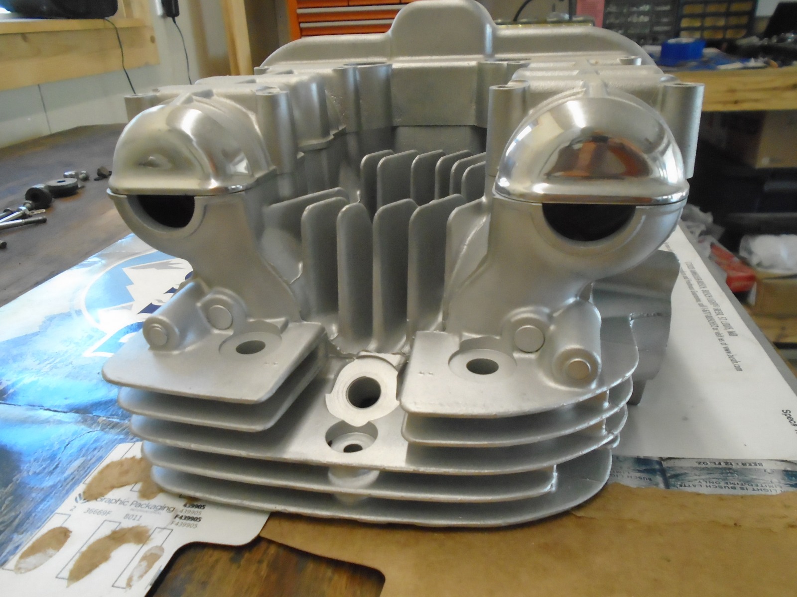

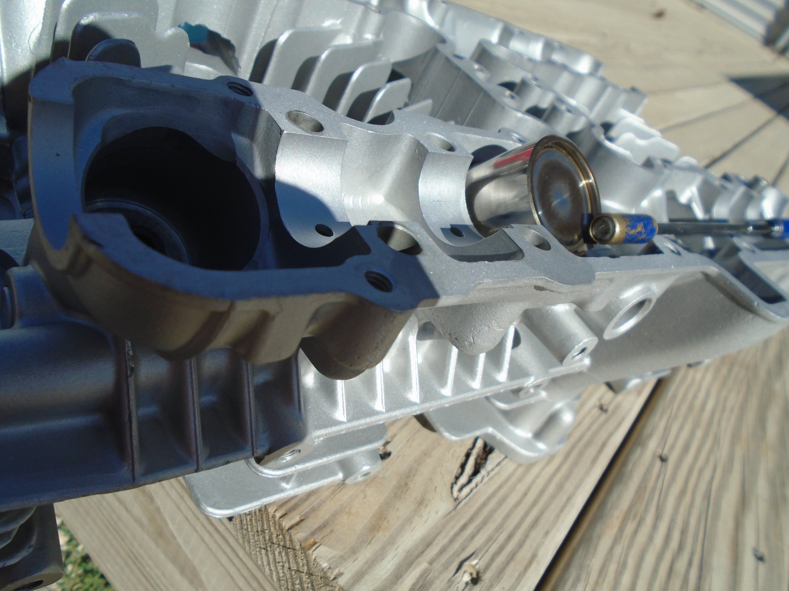

Okay, a bit bored today so i cleaned-up the head pictured earlier this morning. I was just curious if it was the bore that caused the stuck drilled bucket or the bucket. Well it turns out it has to be either the drilled bucket OR muck from sitting for so long caused this? Perfect fin 900 heads are too hard to find to just chuck.

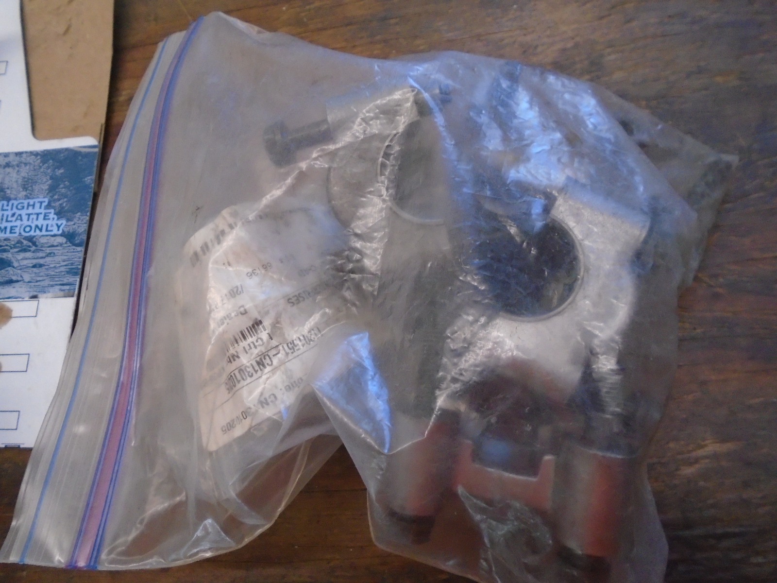

Would look sharp, tease. Even the original camcaps,in a bag, double tease.
