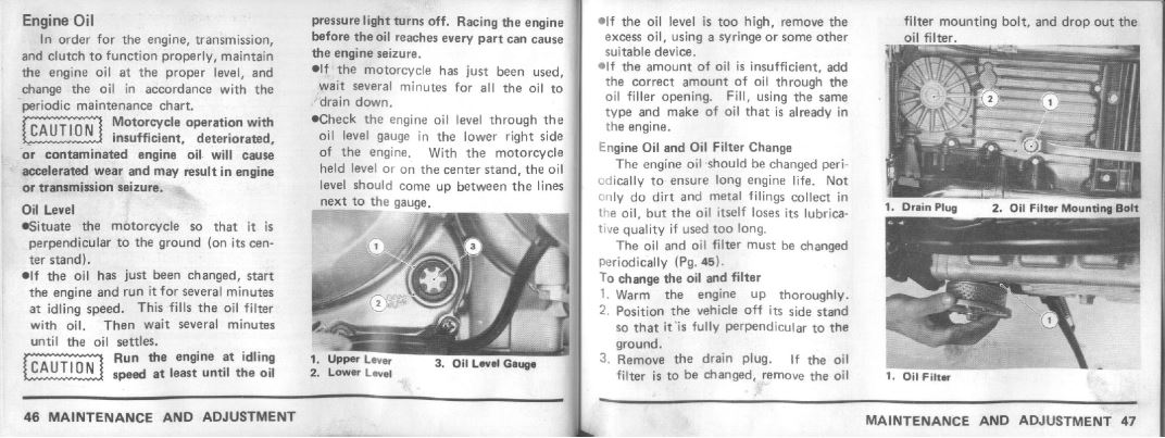

Assuming you KZ is like my KZ650 I suggest you pay attention to the amount of oil shown in the oil sight glass rather than using quarts, liters, or other measures to determine the correct amount of oil. Put in enough oil to bring the level up to the upper mark next to the glass. Let the bike sit for a little while, the check again. Add oil only if the oil level is below the upper line. This is how I have done my 1977 KZ650-C1 since the day it was new (43 years) and I've had no problems. Ed

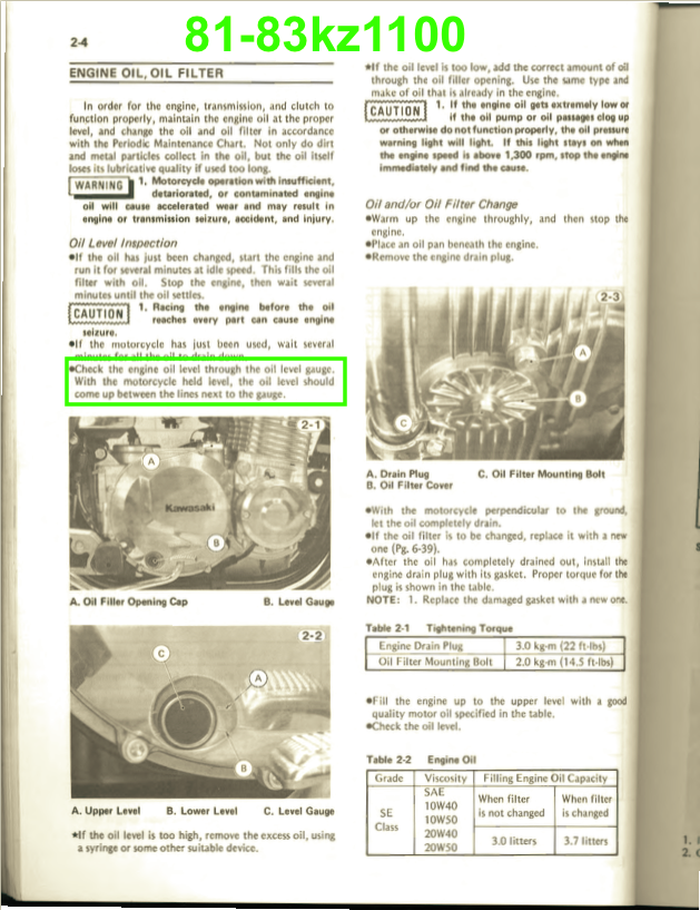

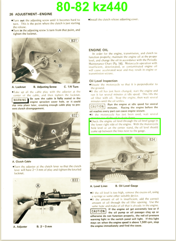

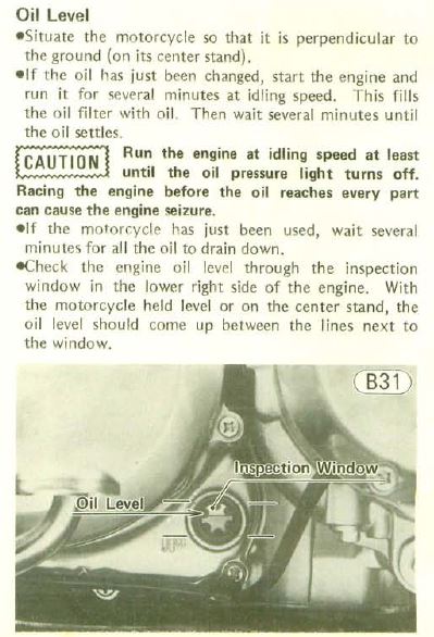

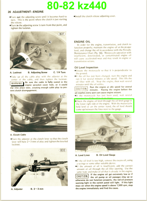

Does the manual tell you to check the oil while the bike is on the center stand?
I've always checked oil with both tires on the ground. It seems like having the back of the bike elevated like that would give an incorrect reading in the sight glass.

I always check the KZ650 oil level with the bike on the center stand. That's the way the KZ650 Kawasaki Service Manual and the KZ650 Owners Manual specify it to be done. Ed

Factory manual for the 750/4 bikes says to use the center stand.
I like to check when the engine is cold because that way you know all the oil has drained back. Oil expands when hot so it may be over the window after a ride if it's normally at the top of the window when cold.

The manuals say perpendicular to the ground suggesting the front wheel needs to be raised a little as if the machine is on both wheels, but that said if the whole window is covered there is way to much oil in the engine whether perpendicular or not, my suggestion is get the machine upright and perpendicular drain off the oil and refill it so the oil is between the two marks, probably just a schoolboy error going on here.
