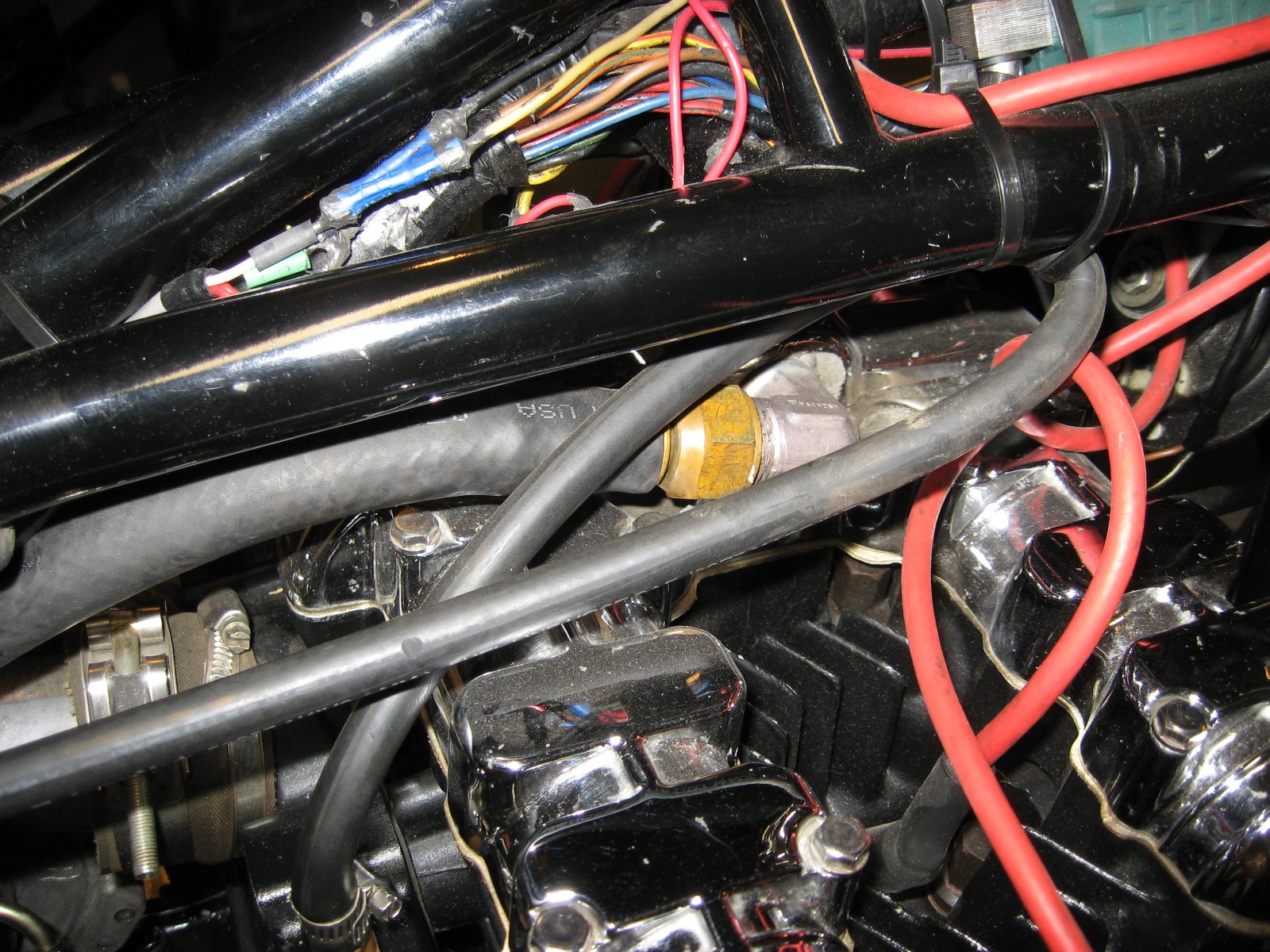

Sounds like you should have a valve cover vent. I have a 77-kz1000A1 and it has a vent hole in the middle of the cover which is vented out the rear of the bike, via a fitting and tube. You may have the wrong valve (engine) cover.

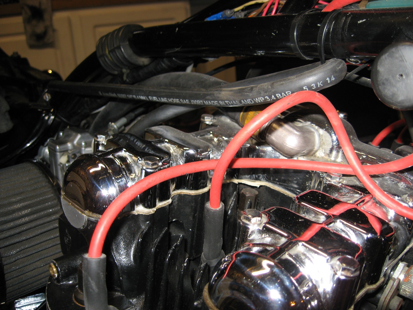

urankjj wrote: Sounds like you should have a valve cover vent. I have a 77-kz1000A1 and it has a vent hole in the middle of the cover which is vented out the rear of the bike, via a fitting and tube. You may have the wrong valve (engine) cover.
On a stock bike a working factory oil breather should be fine .
But here is a sample from my turbo b ike on how to vent a cam cover

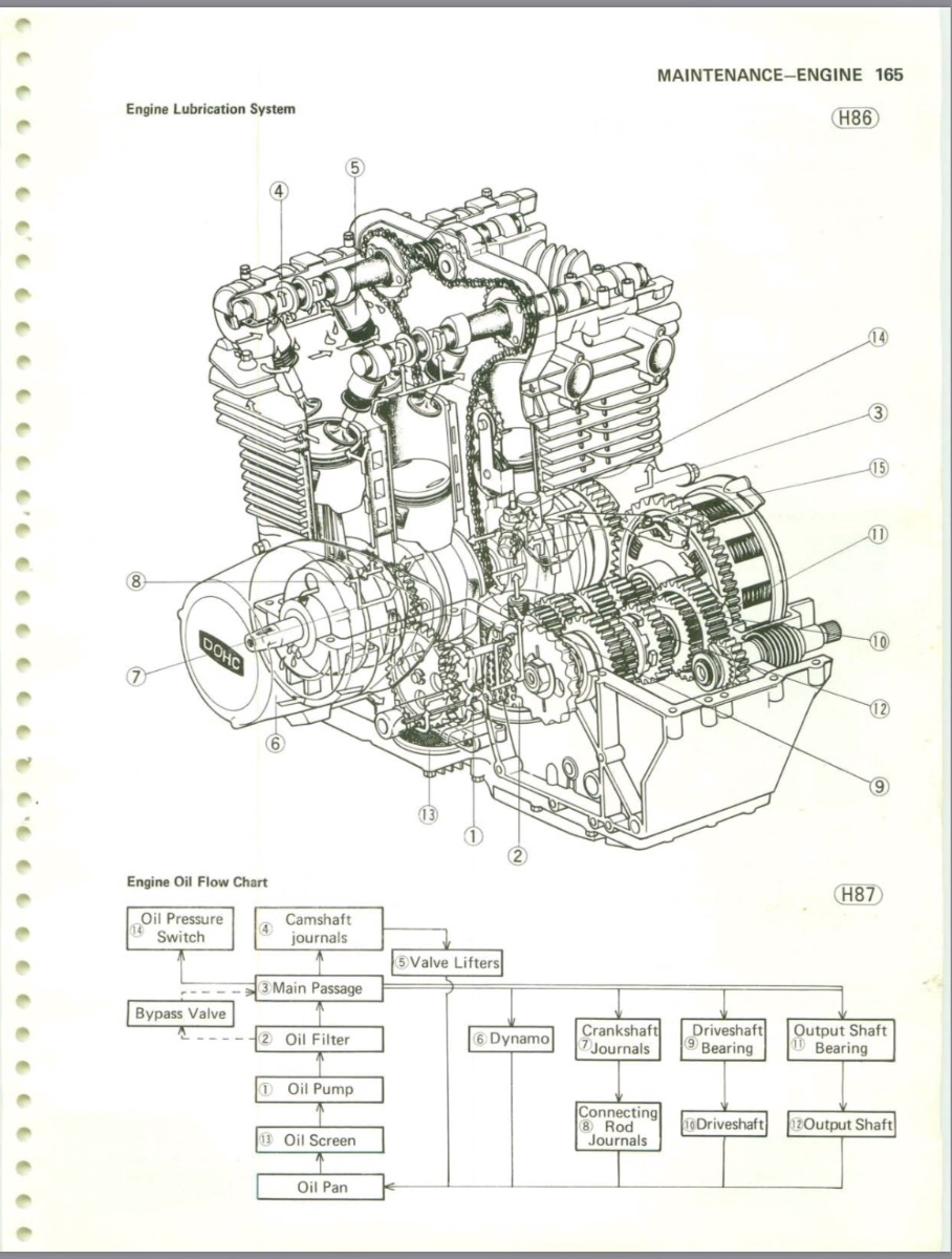

hardrockminer wrote:
It sounds to me like your oil return passages are blocked. Oil gets pumped up to the cams but doesn't seem to be returning to the sump.
There are no real oil return passages or ports. The oil pumped up to the cams flow back through the cam chain slot into the oil pan.

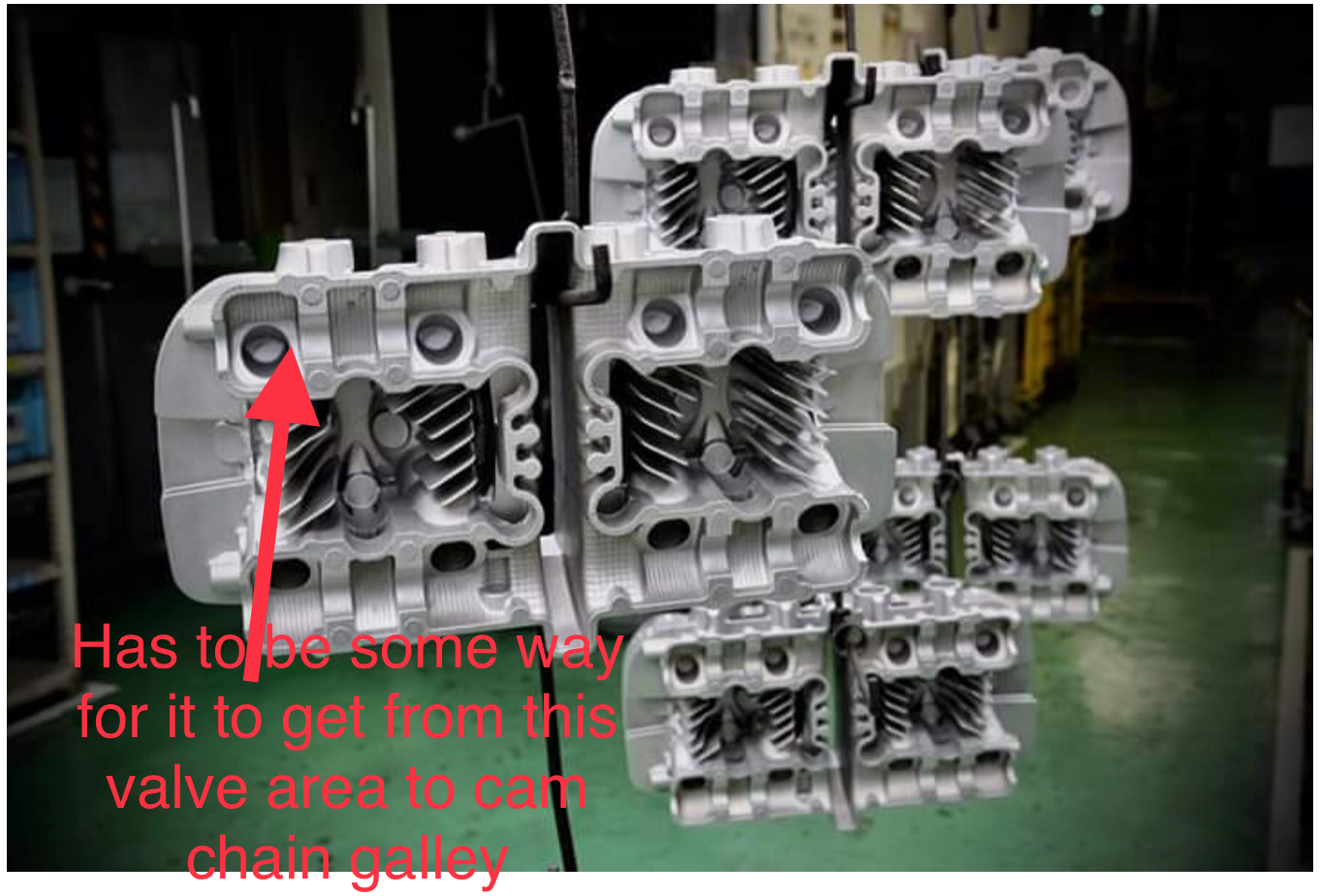

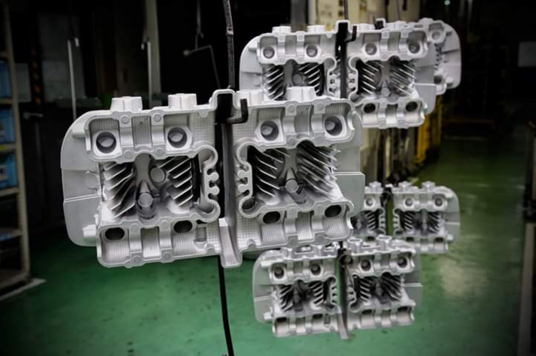

Check a little more closely. Look in the valve ports and you will see how oil drains back to the cam chain slot. But on reflection....this would not cause a pressure buildup unless the cam chain slot itself was blocked.

Please point me (us) to the passage how the oil drains back to the cam chain slot through the valve ports.
