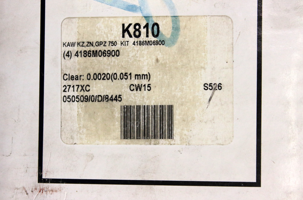

Bore clearance is 0.051mm = 2 thou for the Wiseco pistons.

On all the bigger 1075 etc Wiseco kits I've fitted , including the 250hp Turbo drag bike I've gone 2 thou with no issues.

I've always thought .002" was the standard for air cooled engines. Out here in the heat I wouldn't want to go smaller clearances.

My Zephyr 750 ran more than 70000km on Wiseco K810 kit without any issues. Cylinder-to-piston clearance was set to that recommend by Wiseco: 0.051mm (0.0020) .
