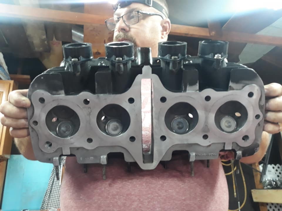

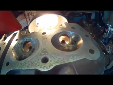

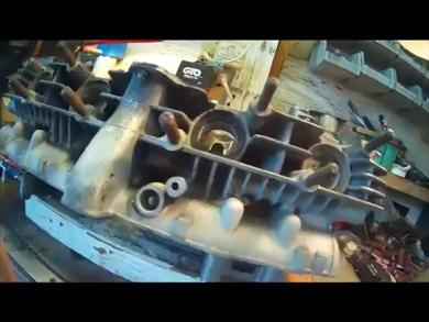

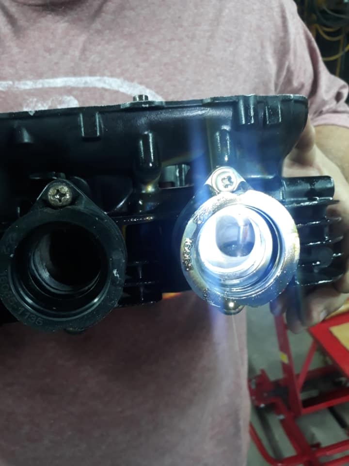

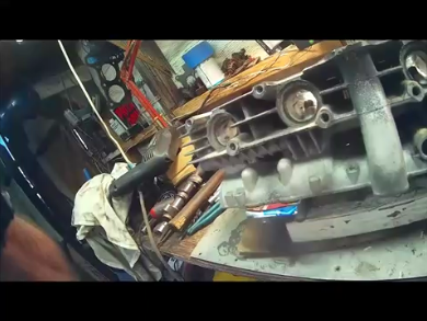

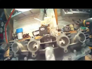

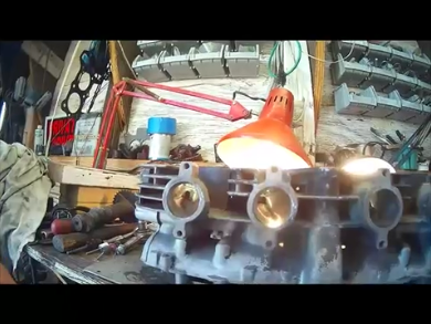

That's pretty much what I did. I'm having to download my clips to take snapshots of the ports and seat areas. I didn't think to do them at the time I recorded them. :blush: Here's a few. More to come. I'm always open to suggestions on how to make them better. B)

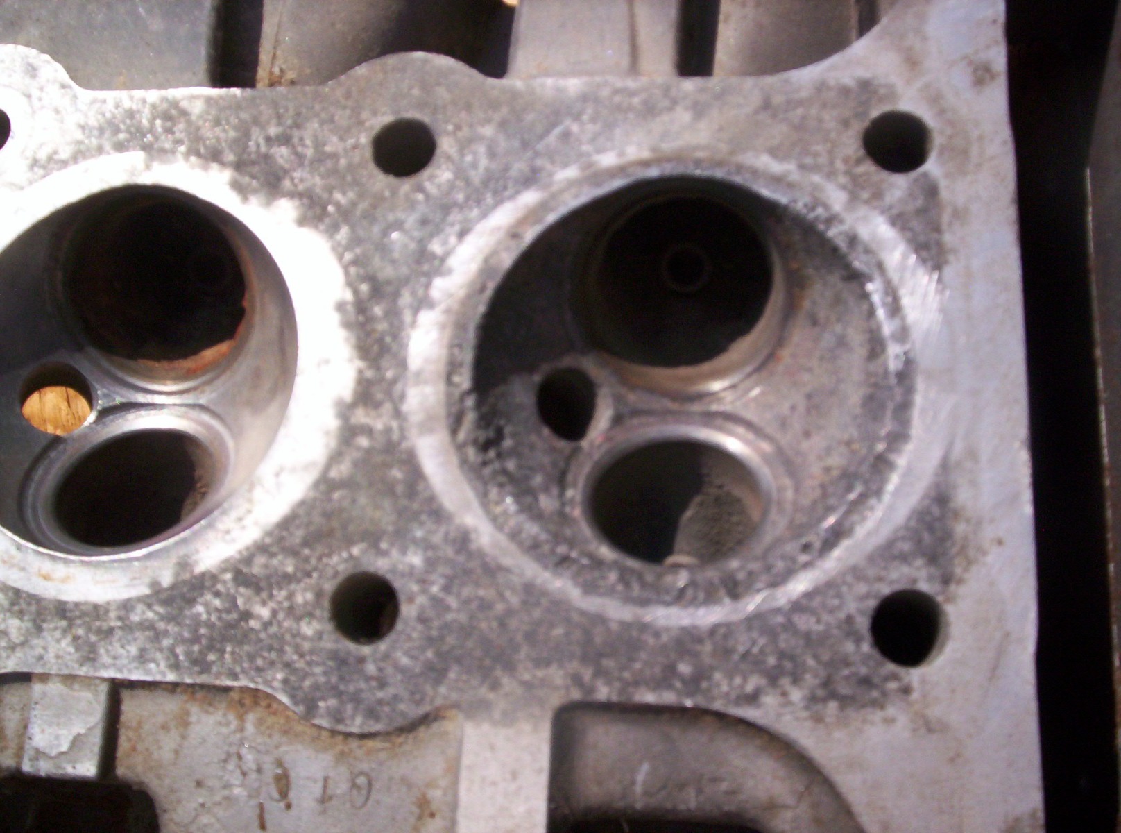

I certainly wouldn't suggest doing what this guy did. :ohmy:
I started with this
