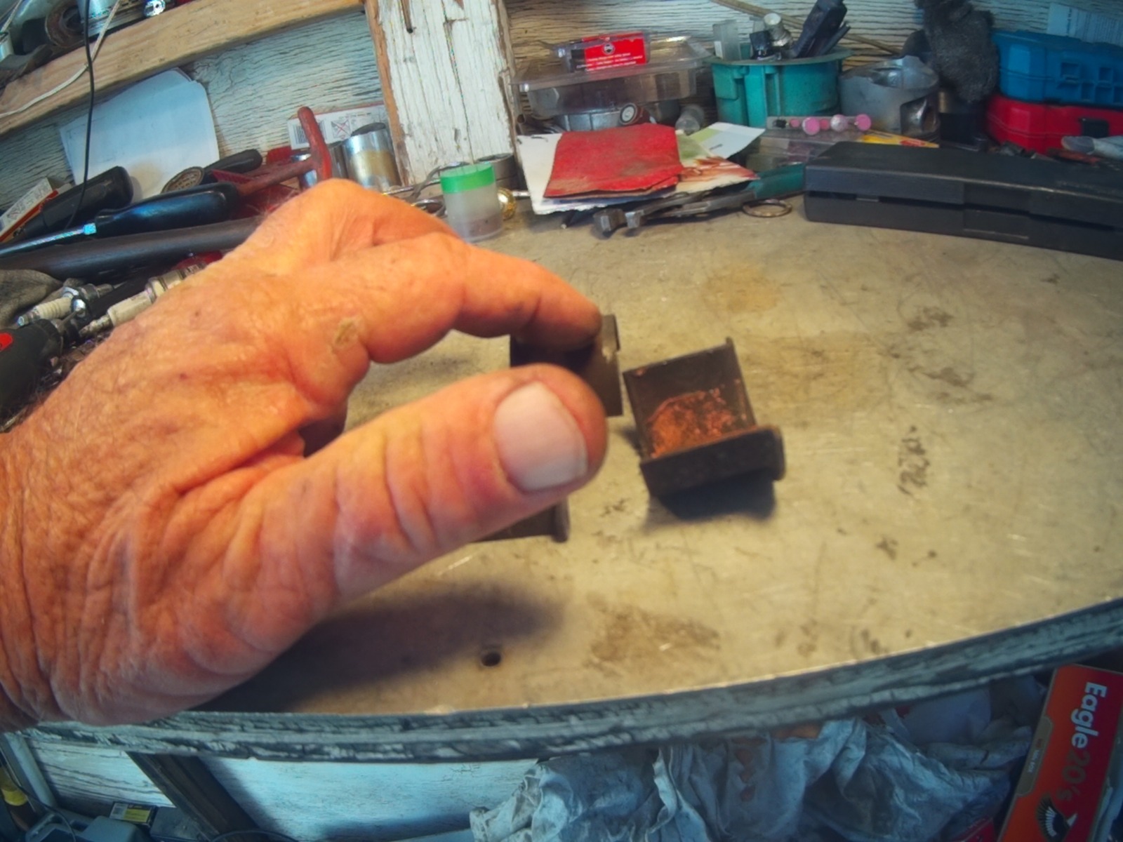

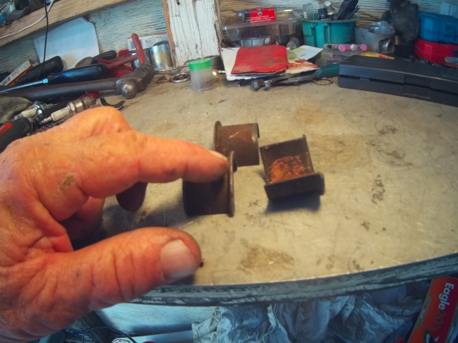

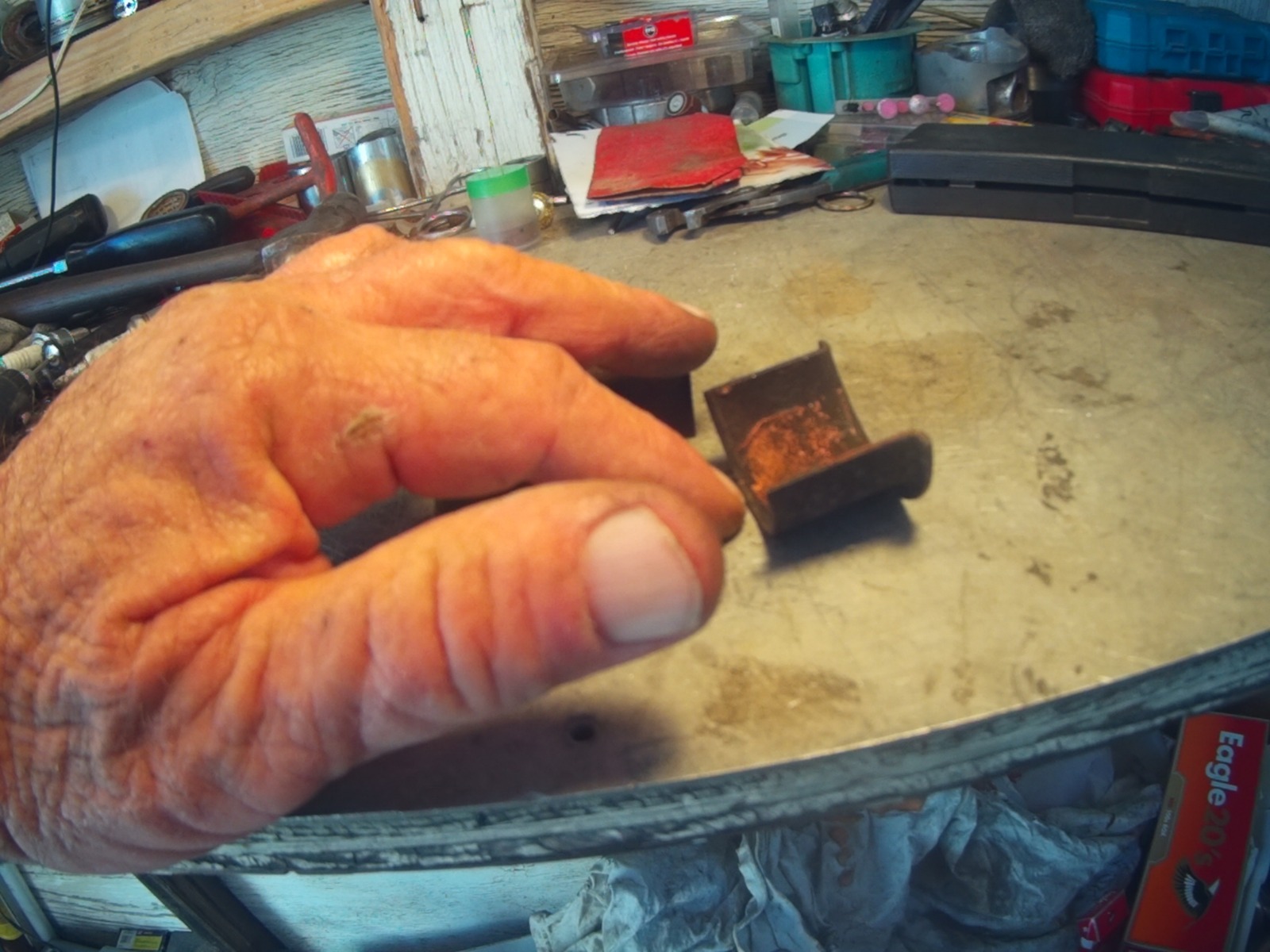

I had the same issue on my V/H header. I used my small welder to lay a bead filling the void and used my grinder to reshape it. It's been holding for two years now. The shells bend at the flange so they won't fit evenly and that's what I think caused it. I straightened them with my vise.

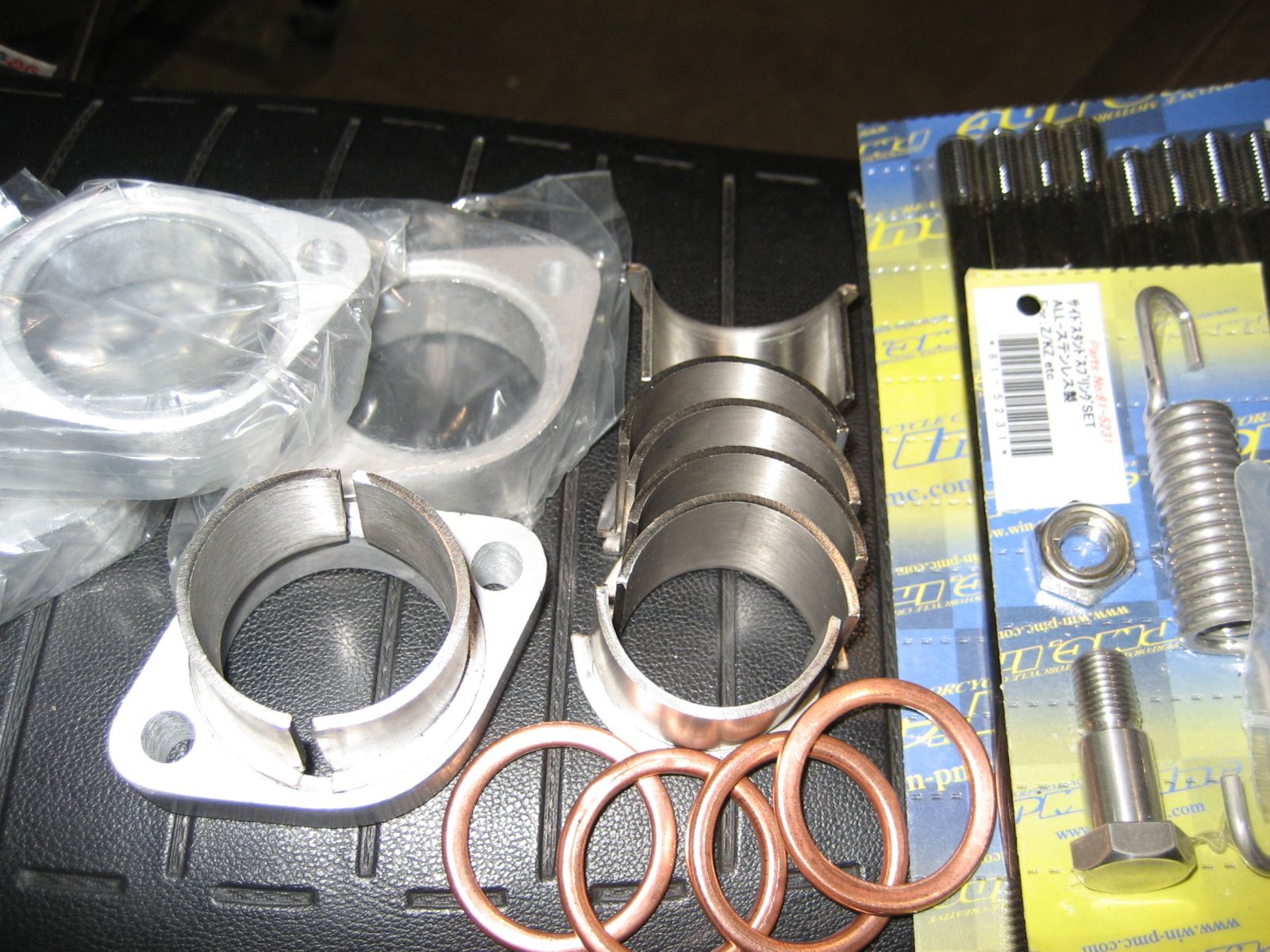

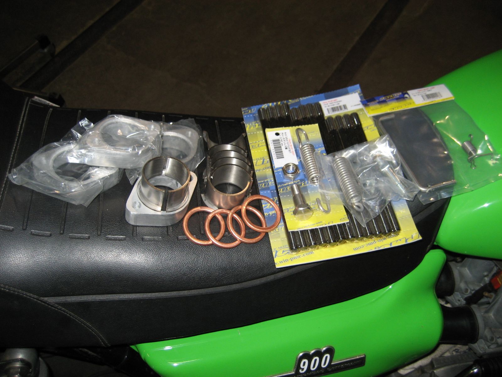

03 Mar 2020 17:53 - 03 Mar 2020 17:53Scirocco wrote: I change most of my nuts and bolts to stainless steel shells, studs,nuts and bolts.

Almost all the bolts on engine/trans have been replaced with SS SHCS on my 650 for years, from the beginning I used Never Seize on the threads and body, unless the application dictated Loctite and have not had any trouble with galvanic activity. Dry I believe would be a issue.....
