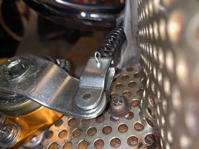

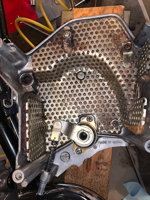

I will try to pop off my sprocket cover tonite and take a pic of how the actuator is situated. A good picture is worth a thousands words or more especially in this case as the instructions that come with the kit are minimal at best. Perhaps Baldy110 can chime in when I post the picture to see if his is positioned the same way. Just as food for thought, when I installed mine I kept a close eye on how much the cable pulled on the actuator so it didn't go over the top so to speak. I attempted to use a translation program to decipher the instructions and that helped a bit. In the directions they tell you to file down a part of the sprocket housing casting if it gets in the way of the cable spring. Mine did interfere so I used a carbide bit on a Dremel tool to remove the casting web and viola, no more interference.
Rick H.
Okay, here's 2 pictures. The first pic shows the actuator in relationship to the sprocket cover. The actuator arm is at full extension in the pic. The second pic more or less shows how I notched out the casting web to eliminate interference with the spring on the end of the cable. Hope these help.

Rick H. wrote: I will try to pop off my sprocket cover tonite and take a pic of how the actuator is situated. A good picture is worth a thousands words or more especially in this case as the instructions that come with the kit are minimal at best. Perhaps Baldy110 can chime in when I post the picture to see if his is positioned the same way. Just as food for thought, when I installed mine I kept a close eye on how much the cable pulled on the actuator so it didn't go over the top so to speak. I attempted to use a translation program to decipher the instructions and that helped a bit. In the directions they tell you to file down a part of the sprocket housing casting if it gets in the way of the cable spring. Mine did interfere so I used a carbide bit on a Dremel tool to remove the casting web and viola, no more interference.
Rick H.
Yep mine is positioned the same way but I didn't have to clearance the cover.
