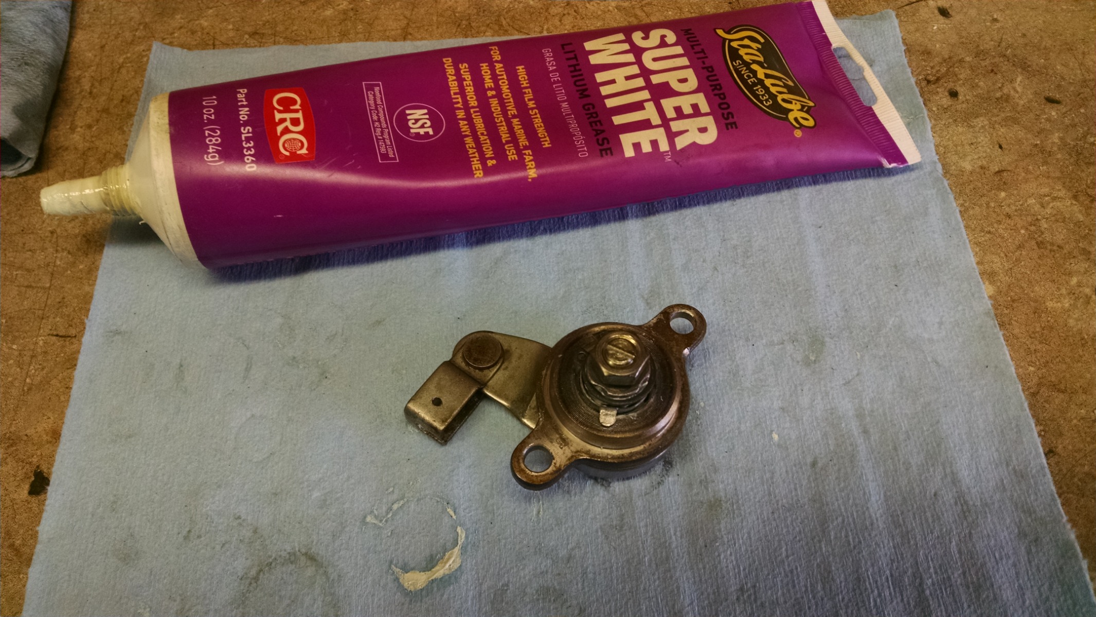

To Baldy110: Thanks for the update on the EZ pull clutch lever. I too have been thinking of getting one that would hopefully bring my KZ-1000 clutch lever effort more in line with my K1600 GTL. I understand the install directions are in Japanese, how did the install go on this unit?
Rick H.

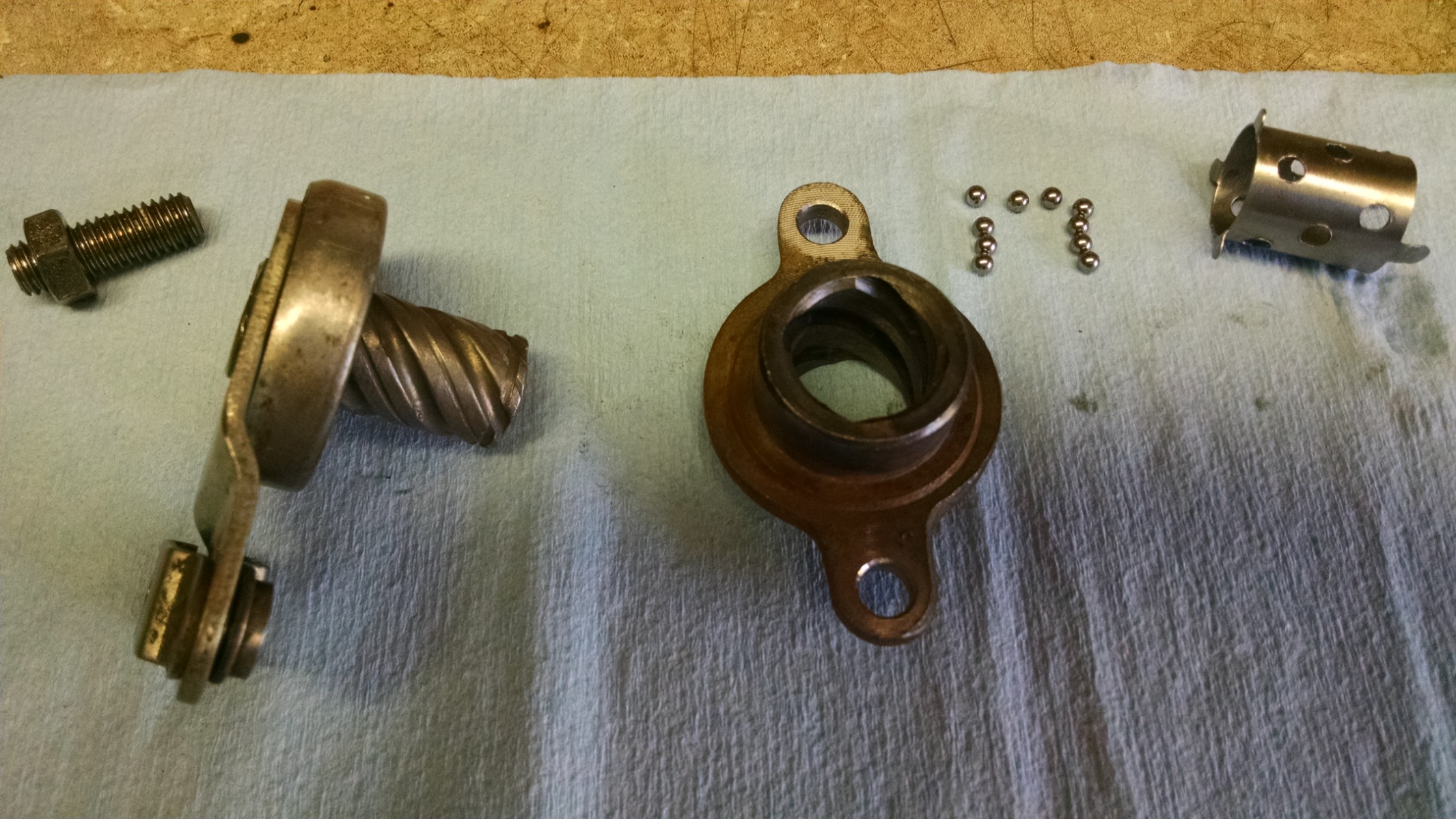

The instructions were pretty much useless but if you have any mechanical experience it's an easy install.

29 Dec 2019 10:06 - 29 Dec 2019 10:08baldy110 wrote: Looking closely at how it all goes together I don't see how anything can pop out everything is captured. What kept popping out on the 350 one?
The dreaded "pop" would be the cam balls jumping or rolling into the next slot if not properly adjusted. The ball / cam design, while being easier to pull, does have some drawbacks.
This ball / screw design can not do that, although it has it's own little set of problems.
Just a little bit of patience required to assemble.

When I put it together I noticed how it could rotate to far but since this isn't my first rodeo I adjusted it accordingly. I'll just have to use it a lot and see.

So when you installed it you could tell right away if it pulled too far and make the subsequent correction? I have the nylon worm housing in my KZ-1000 and I am sure it leaves much to be desired in the friction department. I have greased it with some pretty hi tech stuff, but the lever effort still seems excessive.

With the ramp and ball clutch actuator it's critical to get the arm positioned correctly or the ramp will jump over the top. I misassembled my 750''s clutch actuator and learned this first hand.

29 Dec 2019 13:46 - 29 Dec 2019 13:49I saw the possible problem while I was assembling it. I loosened all the cable adjusters then turned the clutch adjuster on the case counter clockwise until it stopped then turned clockwise about 1 /8 turn. At that point the caged balls would not be able to move enough to jump the ramp. Then I adjusted the cable adjuster to get the lever to the top. I pulled then released the clutch lever several times. Started the engine then fine adjusted the adjuster at the lever. The engagement point is about 1" from the bar. I just got back from a 100 mile ride and the lever is like butter.Rick H. wrote: So when you installed it you could tell right away if it pulled too far and make the subsequent correction? I have the nylon worm housing in my KZ-1000 and I am sure it leaves much to be desired in the friction department. I have greased it with some pretty hi tech stuff, but the lever effort still seems excessive.
