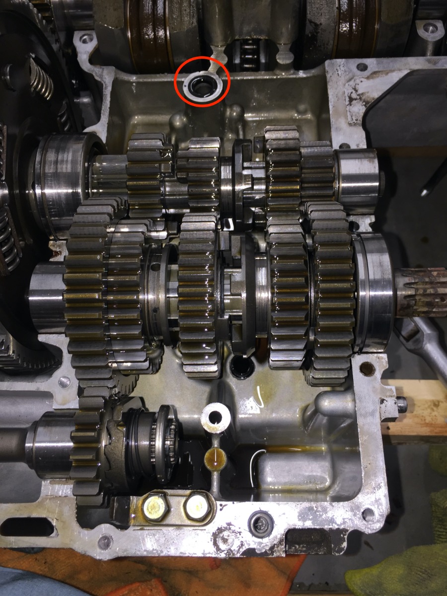

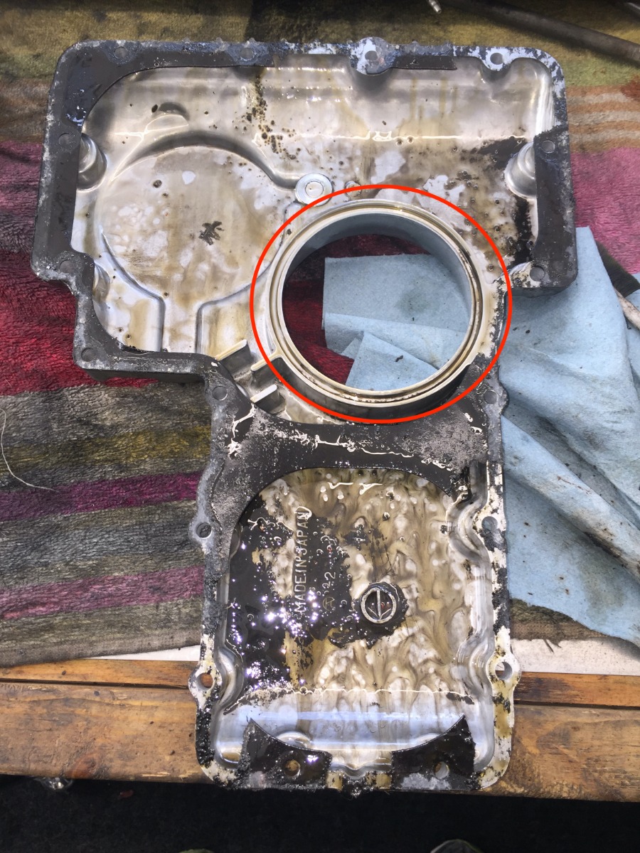

I was thinking about that today. There is a big O-ring, same size as the one on the bottom of the filter cover. It's between the cases. Maybe it's missing?

14 Dec 2019 20:36so cases have to be split to see if it's there? Why is it there? To seal oil passage between the two case halves?hardrockminer wrote: I was thinking about that today. There is a big O-ring, same size as the one on the bottom of the filter cover. It's between the cases. Maybe it's missing?

If the engine is full of oil and the cover is off there shouldn't be any oil getting past the O ring. If there is it might be missing or cracked. You would also have very low oil pressure if any.

15 Dec 2019 03:04There isn't a large 'O' between the cases.hardrockminer wrote: I was thinking about that today. There is a big O-ring, same size as the one on the bottom of the filter cover. It's between the cases. Maybe it's missing?
Only on the filter and breather covers.
There is a small squared profile 'O' ring between the cases the same as on the oil pump to that seals the join up to the oil pressure switch.
If that was missing the oil would leak back into the sump and the oil pressure would drop so that would not be the cause of the leak.

Apologies...I was wrong. It's on the inside of the oil pan.
There is also a small O-ring inside the cases at the top of the oil filter.
If either one is leaking it would reduce pressure to the mains.
