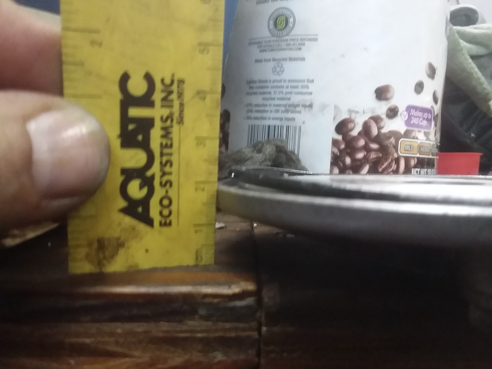

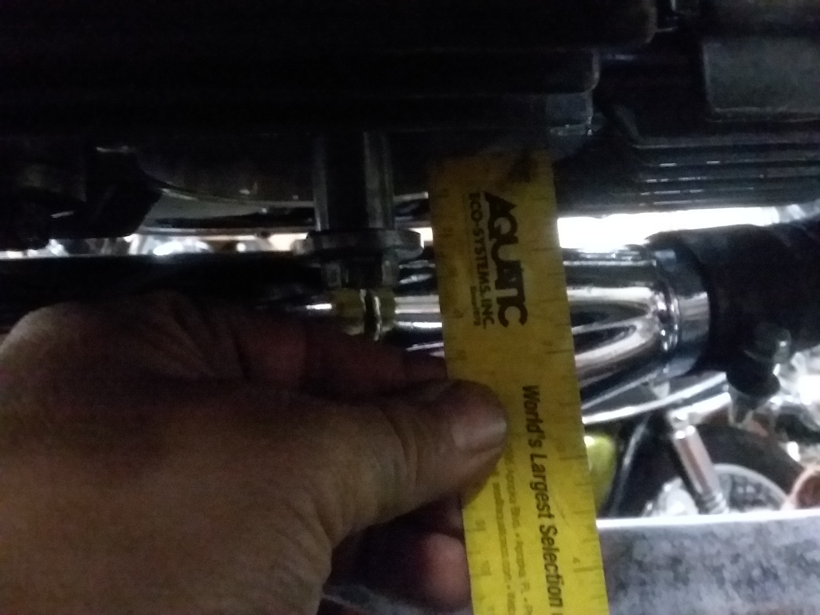

So, I have double and triple checked air flow through all accessible passages...all good. Close look at bolt screwed in to block all the way til it bottoms with no other parts, measure from oil pan surface to flange head surface of bolt, 20mm give or take, hard spot to get super accurate. Thickness of oil filter cover is exactly 20mm. Is this how things should be?
Re: 78 kz1000ltd weird back pressure in oil system?
13 Dec 2019 20:34
Check to see if the cover is flat with a straight edge.
