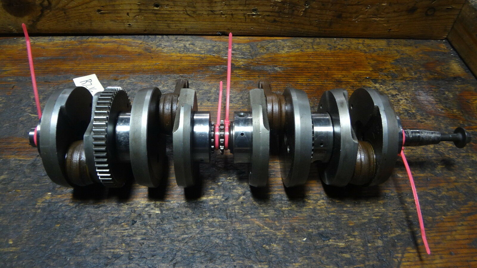

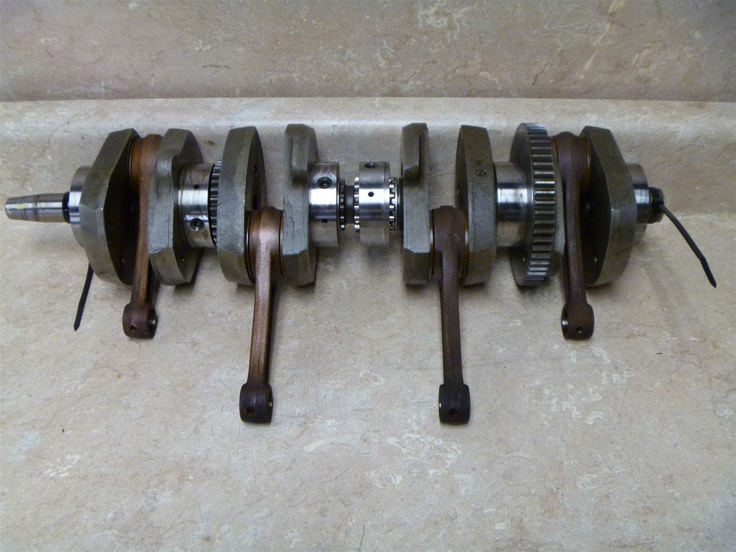

DOHC, thank you for the lead. I found a set of cases. . But with this post revived I'd like to ask about crankshafts. What years will fit in the '76 cases, I'm seeing ones but don't know about the tooth count. I've seen 15t and 17t. Is the cam sprocket on the crank? What affect would a different tooth count do.
Re: Complete but dissasymbled 1974 Z1900 engine
24 Dec 2019 16:29 - 24 Dec 2019 16:31
You need a 15 tooth. Early 903 cranks look like this.
Early KZ 1000 crank would work but are heavier.

Thanks Steve. I found one like the first picture but the wrist pin area is rusted. Can that be honed out without causing a problem? What is a good price to pay for the crank

24 Dec 2019 21:21Mikaw wrote: Thanks Steve. I found one like the first picture but the wrist pin area is rusted. Can that be honed out without causing a problem? What is a good price to pay for the crank
I think I paid $50 plus shipping for the crank. I was watching three. I studied the pics very carefully and knew it was a crap shoot. I figured with what I had and there was a bad bearing I could use parts off the one I had. I got lucky. I washed it really well in diesel before I installed it.
