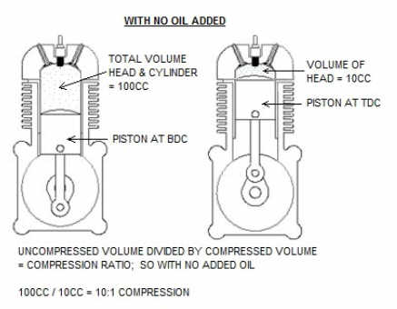

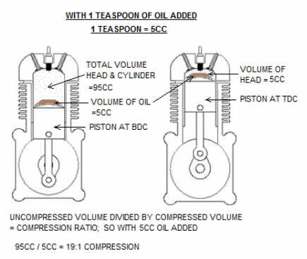

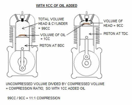

JoshMcMadMac wrote: "The pressure shot up and held with oil, it's the rings."
Perhaps, but not necessarily. Adding even a little oil to even the cylinder in a brand new engine will make the compression ratio go up unless the valves or some other area is leaking. See below for details. Ed

Ed is correct, adding oil to the bore is not a good test. I have had an engine with a huge gouge in the bore from the wrist pin backing out show 160 PSI only 5 PSI less than a healthy cylinder next to it. The only way to tell for sure where its leaking from is a leak-down test. In my experience if you are tearing down the top end its best to put new rings and valve seals anyway.
