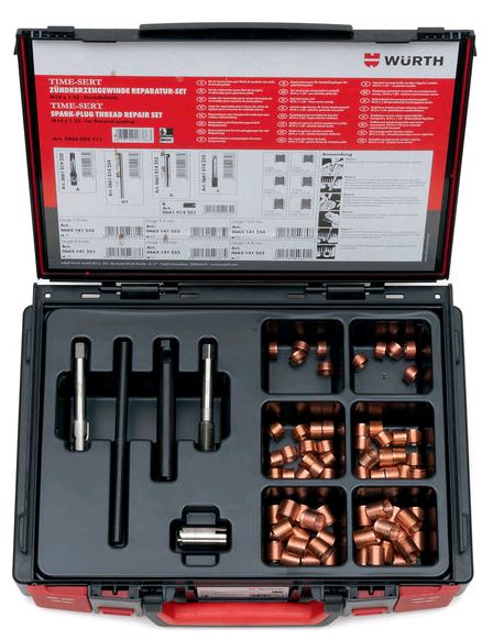

The Wurth kit was really expensive, but I have lucky and found a used one, where one insert only was used approx 70% discount. Will try sell it when I’m finish
I haven’t found useful information if a Timesert is better then good used original threads....
Is a good idea to take all 4 or not... before I sell the kit.
In my head the Timesert should me stronger?
One thing was if these was a new bike, but it is really old....
After I have installed Timesert I will torque up spark plug according to speck from NGR to the specific plug, 20-30nm correct?
So happy I don`t need to take of the top... will you grease when I make the threads and vacuum line the whole after, I also have a inspection camera I will check with before firing up.

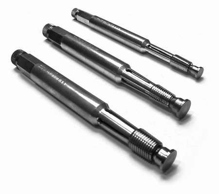

31 May 2019 06:52 - 01 Jun 2019 06:52Patton wrote: The initial threads may be cross-threaded (often resulting from some earlier ham-fisted plug installation) making it impossible to get a plug properly started into the hole.
Often, there's a lot of good undamaged thread remaining deeper inside the hole past the shallower cross-threaded area.
The challenge then becomes how to perfectly re-thread the shallow cross-threads to sync perfectly with the deeper good section.
It may be possible to re-cut the cross-threads by starting at the deep end with a reverse tap, also known as a back tap.
The reverse tap inserts all the way through the spark plug hole, and then the tool's deep end expands to begin tracking along the good threads from the deep end, and re-cuts the cross-threaded section as the tool proceeds upward and out of the hole.
It's akin to having the head off, and re-threading the hole in the normal manner starting with the good threads on the piston side of the plug hole.
A reverse tap accomplishes the same result, but without needing to remove the head.
Here's a pic of the reverse threading tool.
Successful reverse tapping depends on having sufficient remaining thread area inside the sperk plug hole.

31 May 2019 07:48
Thanks for the 411 on the reverse tap Patton. Surprisingly I have never heard of them or even seen one until now.
