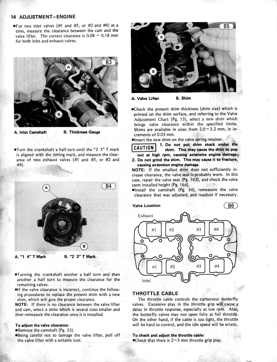

The best way to position the cams is with two adjacent valves both on the base circle, that way the adjacent valve to the one you are checking is not pushing the cam upward and skewing it in the journal clearance leading to an inaccurate measurement.
To position the cams do the following:
Exhaust valves:
Aim #1 exhaust lobe forward at the gasket surface and then measure both #1 & #2 exhaust valves. Then repeat with #4 facing forward and measure #4 & #3 exhaust.
Intake valves:
Aim #1 intake lobe straight up, 90* to the gasket surface and then measure both #1 & #2. Then repeat with #4 intake pointing up and measure # 4 & #3 intake.
If you have zero clearance that is bad; someone abused the bike and neglected maintenance. You are going to have to extract the shims and move down 3 or 4 sizes, install the cams back and repeat the measurement process to see if you can get a clearance measurement which allows calculation of what exact shims you need.
Lastly, be very careful when installing the valve cover because it has a rub block in it for the cam chain which presses down. You need to remove the cam chain tensioner wedge spring to allow the tensioner to move back when the cover is installed otherwise the cam chain will be over tensioned.

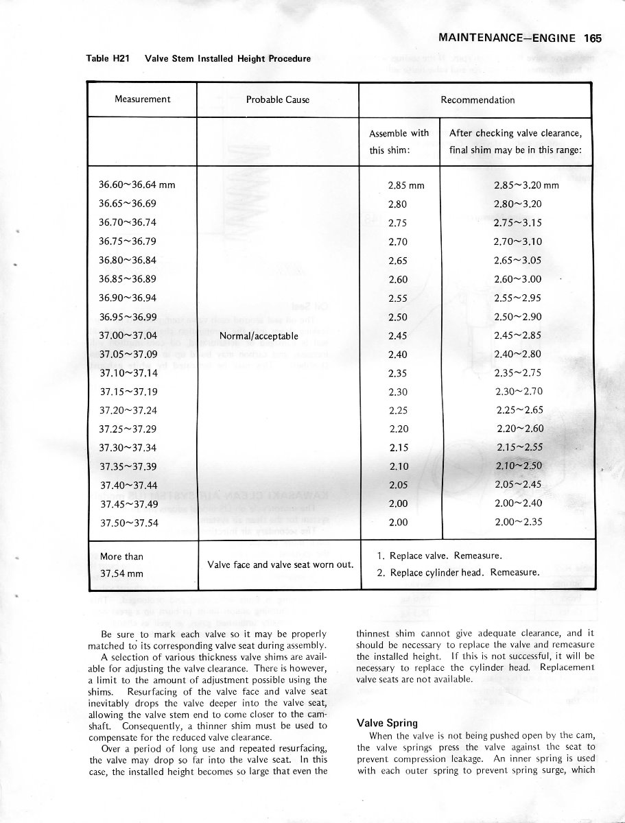

Re: Valve Adjustment Measurements
23 Mar 2019 14:27
Get the Manual for the valve adjustments
www.750turbo.com/forum/viewtopic.php?f=24&t=13320
DL the full Manual
www.750turbo.com/manuals/GPz750_Base%20Manual.pdf
DL the full Manual

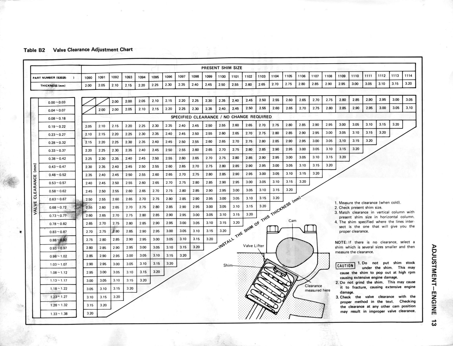

Thanks for the diagram Scirocco, I didnt have that in my Clymer but my measurements matched up with what the chart says! The Clymer manual has an example equation to figure it out so that helped.
I am now stuck on how the hell to get the 3 valves that had 0 clearance to go lower. I just got back from the Kawasaki dealer and got 2 of the 5 (270, 300) I needed. My calculation/guess on the 3 valves that had no clearance had me looking for a shim size that doesnt exist (lower than 185 which is the smallest I've been able to find online). The dealership had 200 at the smallest size yet the valves already had shims of 245, 250, and 255 so I doubt I would get the clearance I need by switching to a 200. Anyone have any ideas on how to fix this? Do I need to look valve springs now?
Thanks!
23 Mar 2019 16:39
Put the 200 in and measure. 245 to 200 is a lot. That's 9 steps down. If that is too large then tipping the valves is another way or larger valves.

23 Mar 2019 16:43lousankz wrote: Thanks for the diagram Scirocco, I didnt have that in my Clymer but my measurements matched up with what the chart says! The Clymer manual has an example equation to figure it out so that helped.
Thanks!
What shims are installed now? Again, try moving the valves with no clearance down 4 sizes and then check again. So if there is a 2.55 in there now try a 2.35. That should get you some clearance to measure.

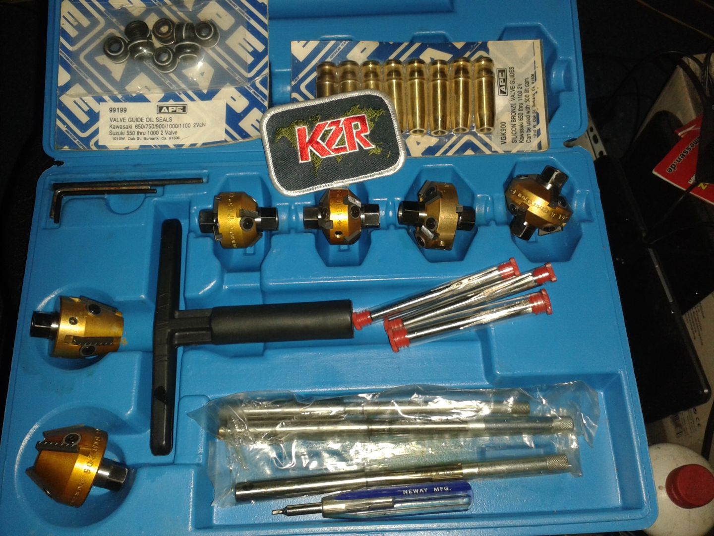

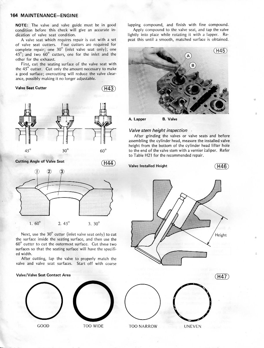

Are you sure you Need a lower thickness than 2,00 mm shim? No way ,some PO must have do a fu*k up cut to deep into the valve seat ring in the cyl. head!!!
If so only a valve stem top grid will fix it.
23 Mar 2019 18:11Nessism wrote:lousankz wrote: Thanks for the diagram Scirocco, I didnt have that in my Clymer but my measurements matched up with what the chart says! The Clymer manual has an example equation to figure it out so that helped.
Thanks!
Nessism - that’s is for reiterating. The advice makes a a lot more sense now that I have looked at the shims and measurement charts. I will step down a few notches on the 0 clearance ones and report back. Thanks!
