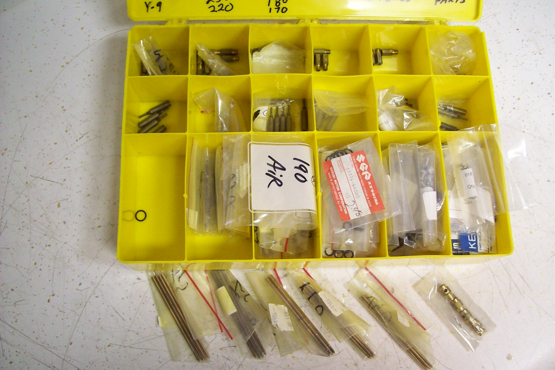

It is getting a little old about all the comments on why such items as Keihin CR or FCR carbs are more trouble than they are worth. Out of the box, the CR or FCR carbs will run halfway decent when you bolt them to your bike. In most cases they are about 60% of being in the ball park. Now to get that 40 or so percent out of your carbs is going to take some massive amount of switching of internal carb parts, and a certain amount of talent to understand what your motor and plugs are telling you!!! The Keihin Cr's and FCR's are infinitely adjustable. Dialing your carbs in is more than changing main jets, and raising or lowering the clips on your needles.
To get my first set of Cr's dialed in to the point they had no hesitations or flat spots, I changed everything in those carbs except the slides, and the carb bodies themselves!!! By my old notes, those carbs were off and on that bike over 20 times before I got them dialed in. There was a time or two where I went the wrong way and had to go back, and try a different direction on the jetting. The FCR's have even more tuneable parts then the older round slide CR's. That FactoryPro article will definitely head you in the right direction from what I read of it.
If you plan on buying a nice set of aftermarket carbs, and expect them to run right on out of the box( they won't), or don't want to or not have the ability to work with the carbs to get them running at 100% or so. I would suggest that you stay with your bikes stock CV carbs!!!!!
Like I said, I changed about every jetting part in my CR's to get them right in the ball park!!

I don't recall reading any of these comments stating as you say, but perception is also part of your own mindset when reading others comments. Those are racing carbs and as such costing ~$1400.00 .. new rack, ~$400.00 for the wideband O2 tool, then the expense of the jet kit you have pictured (300 bucks?) and how much work to dial in? :whistle:
