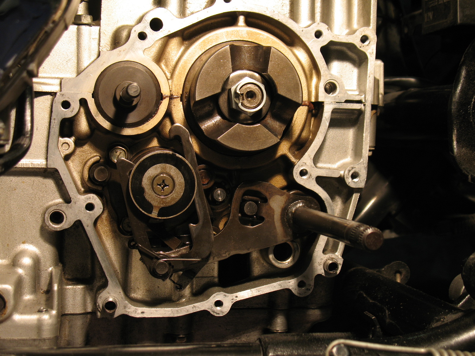

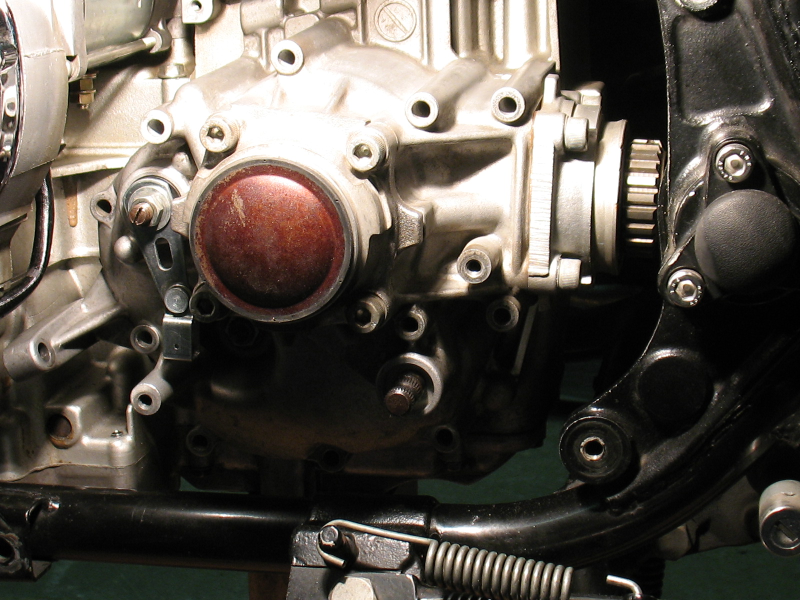

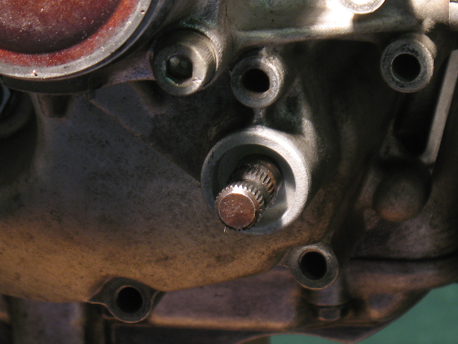

Here you go...
The KZ1100A1-A3 are all shaft drive :ohmy:
This is what the front bevel gear case actually looks like behind the case cover, shown with the shift-shaft seal removed using the technique(s) suggested.
A simple repair, but care must be exercised when installing the new seal over the teeth at the shaft-end, as to avoid damaging it. I may have wrapped a layer of masking tape over the end to provide a smooth protective surface to slide the seal over.
Pics were taken 02/23/15

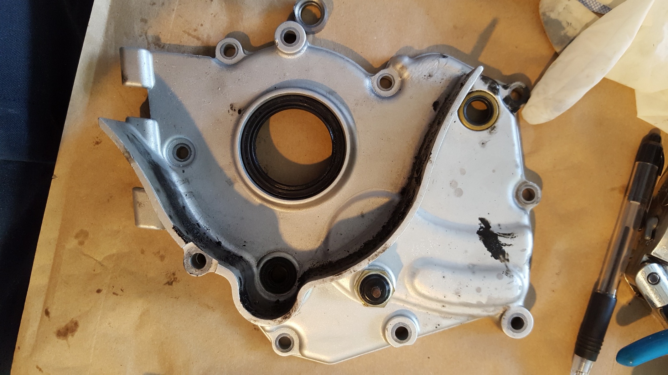

This is what is hidden behind the bevel gear case... :whistle:
Note~Removing thirty-five year old gasket material must be considered a labor of love, and that is all I can say about that. :evil:
