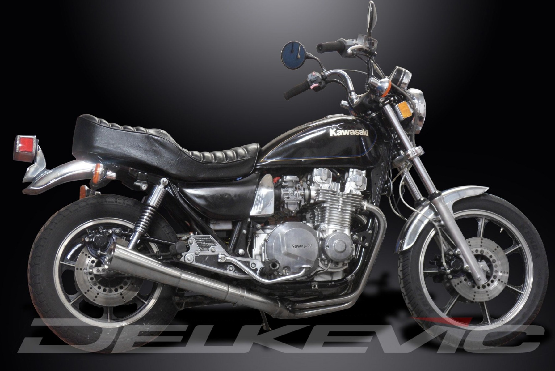

From the pics it looks like the lower pipes are routed directly beneath the center of the engine. If so, the header section may obstruct access for periodic service unless loosened or removed.

It does appear to run directly under the oil filter and drain plug, of which is already a PITA to change with the stock system. This is a copy / paste from the Z1 ad on this exhaust.
"Complete Stainless Steel Exhaust system for the KZ1000K LTD & KZ1000M CSR models. Comes with removable baffle. The oil filter can be changed without removing the pipe from the bike. This exhaust can be made to fit the J- P and R models with some modification to the rear mount bracket."

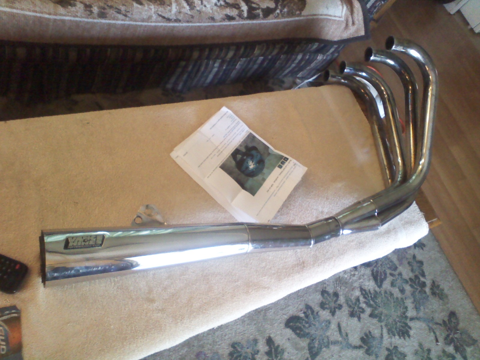

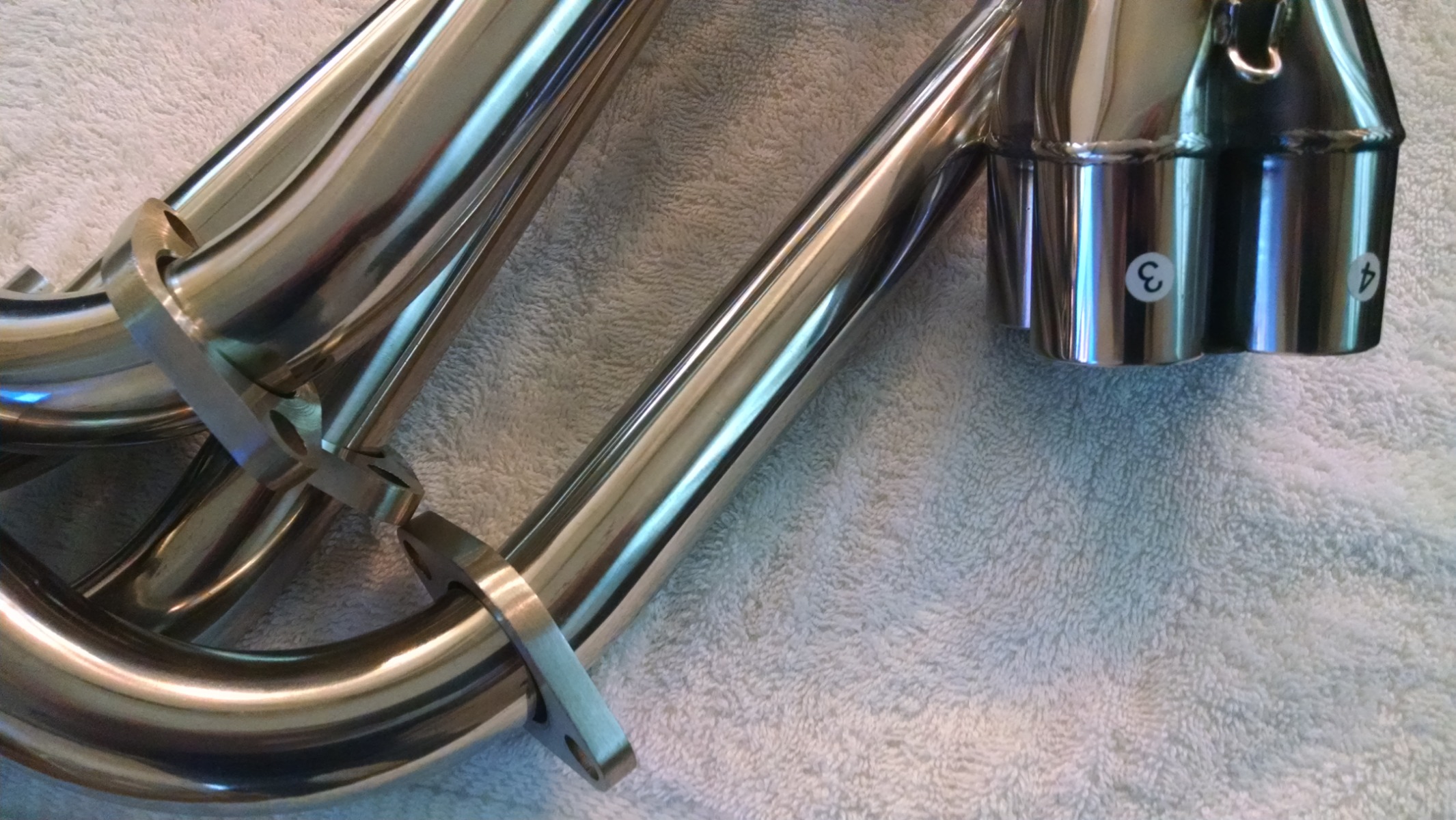

The package came today. All I can say so far is I am impressed. This exhaust is just plain NICE. It took me about an hour to unwrap, but is DEFINITELY a new in box item, as Sean described it. I did take a few pics. I don't want to rush the install because I want to clean up a few things when I start to install it. I will work on it tomorrow . Here are a few pics just to wet your whistle while unwrapping this present.

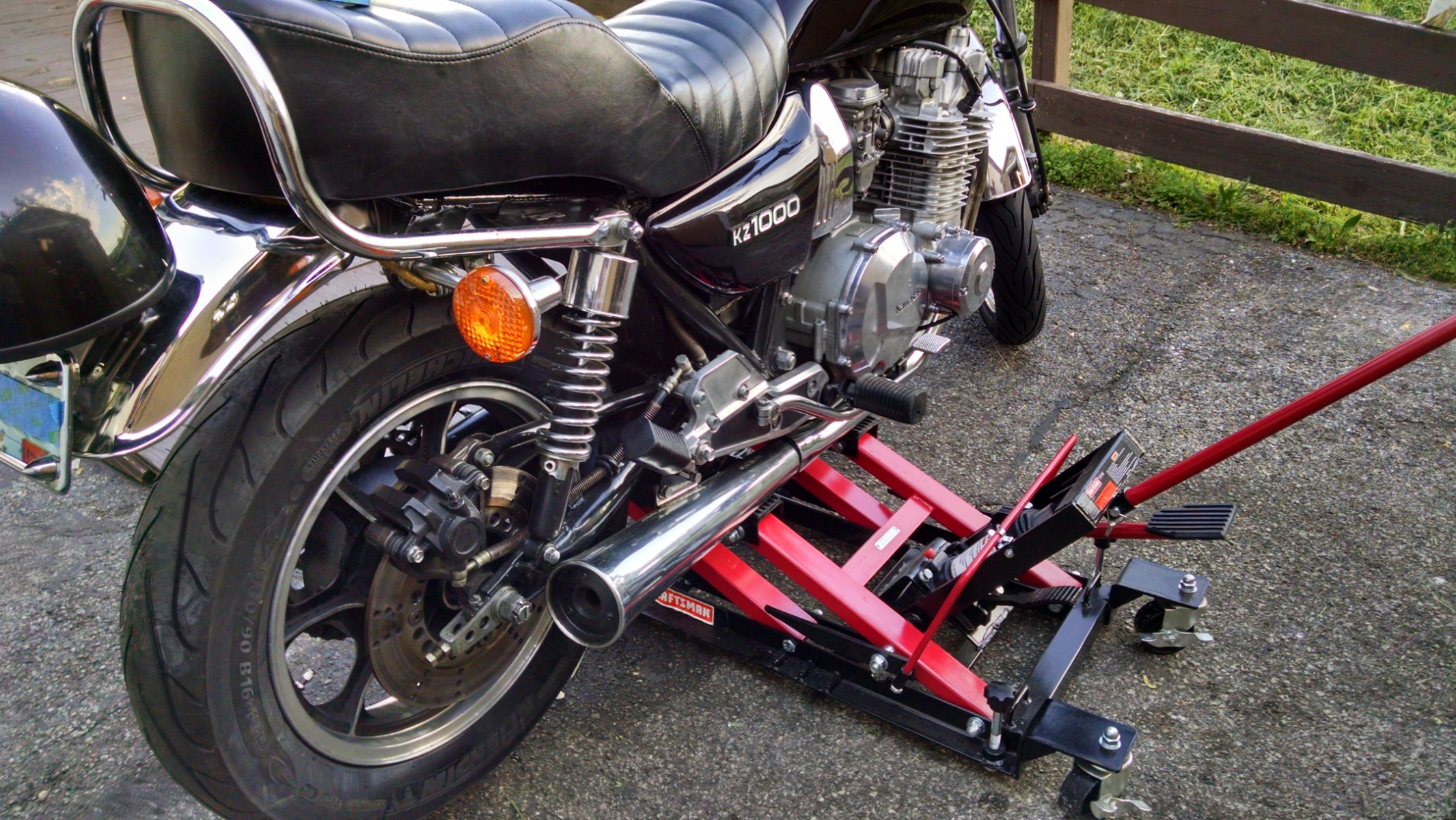

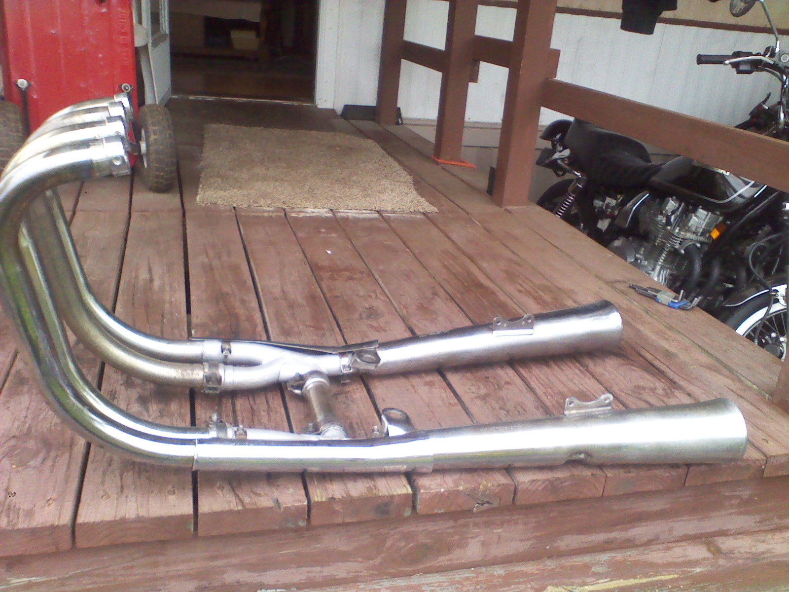

THIS is coming off> That is my 81 Kz1000 CSR in the background. Another caged animal.

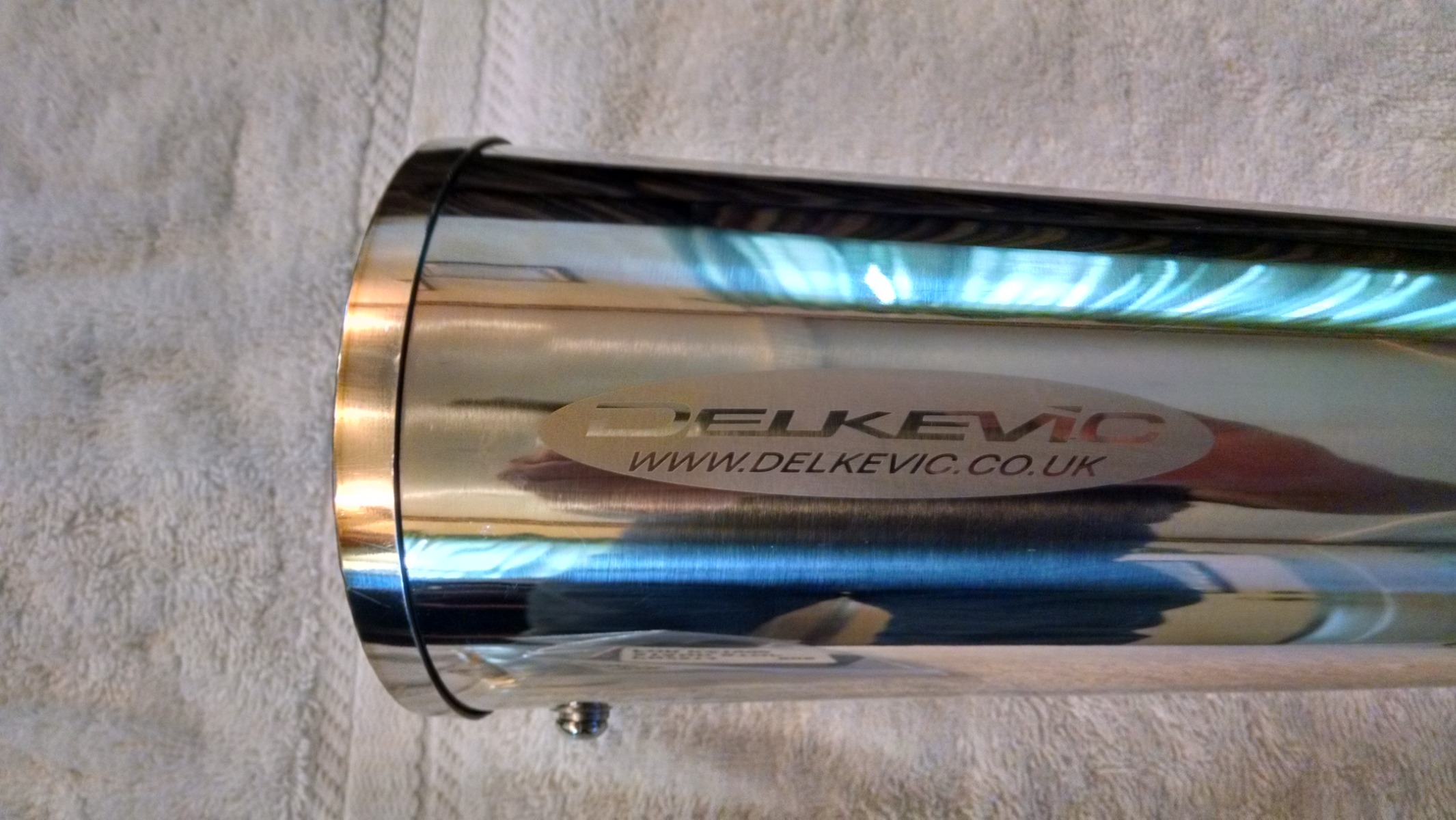

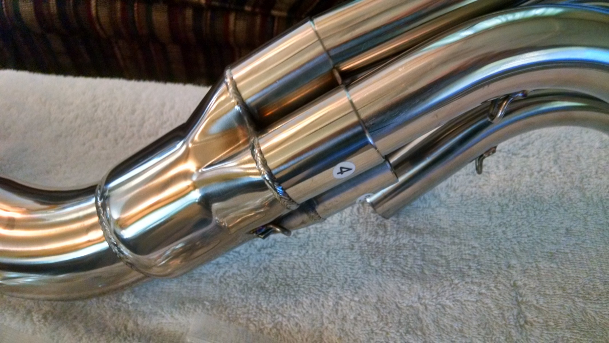

Check out the craftsmanship on these pipes.
This is a very high quality piece.

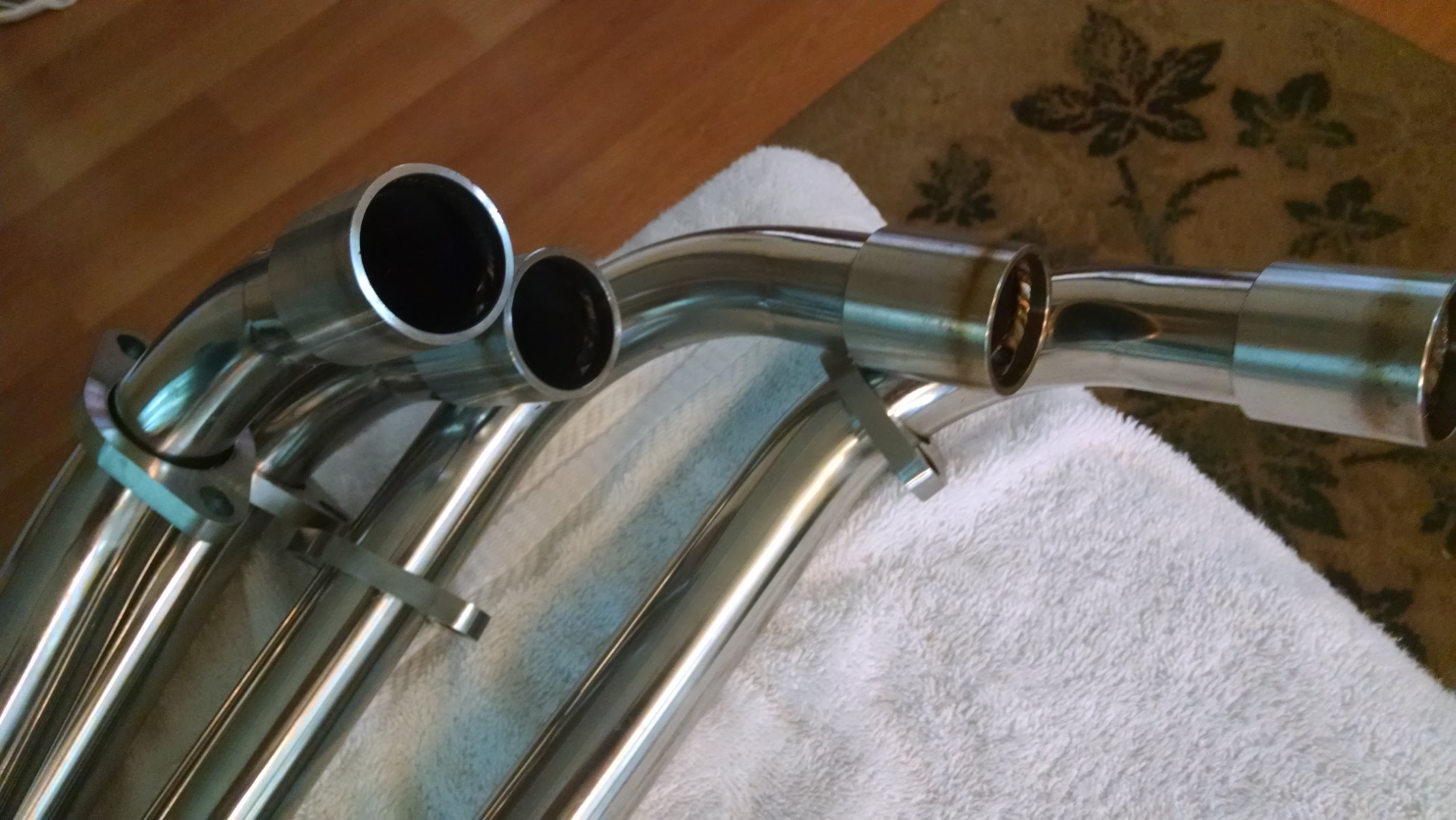

The welds look so perfect they almost have to be done by robot /automation.
Just stunning is the best I can use to describe it. I had a Vance and Hines for the bike that I sold while I never installed it. (consideration of my neighbors, now out the window). The V&H stuff is nice but wayyyy overpriced IMHO.

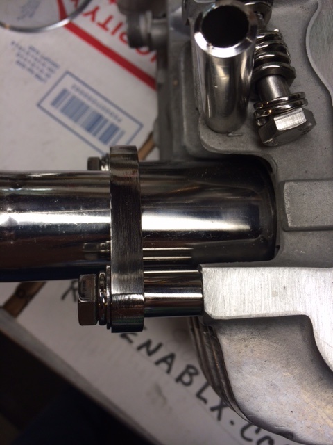

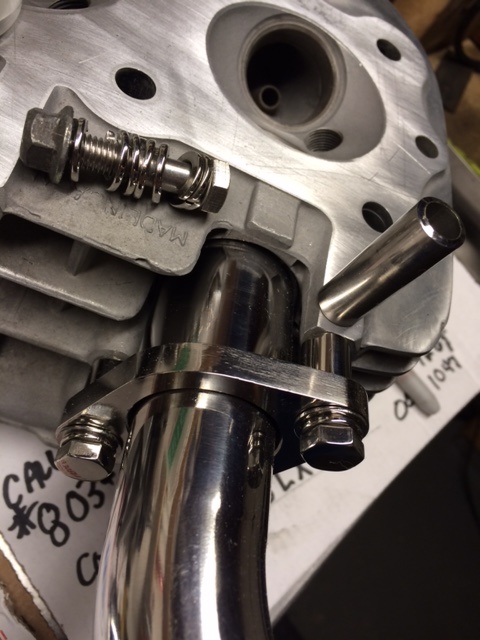

I cleaned mine up with some stainless bolts & washers instead of studs and 1/2" length spacers to hide threads.
