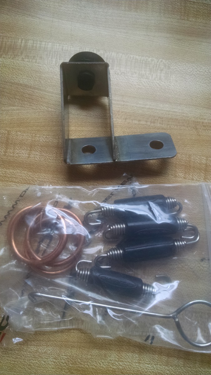

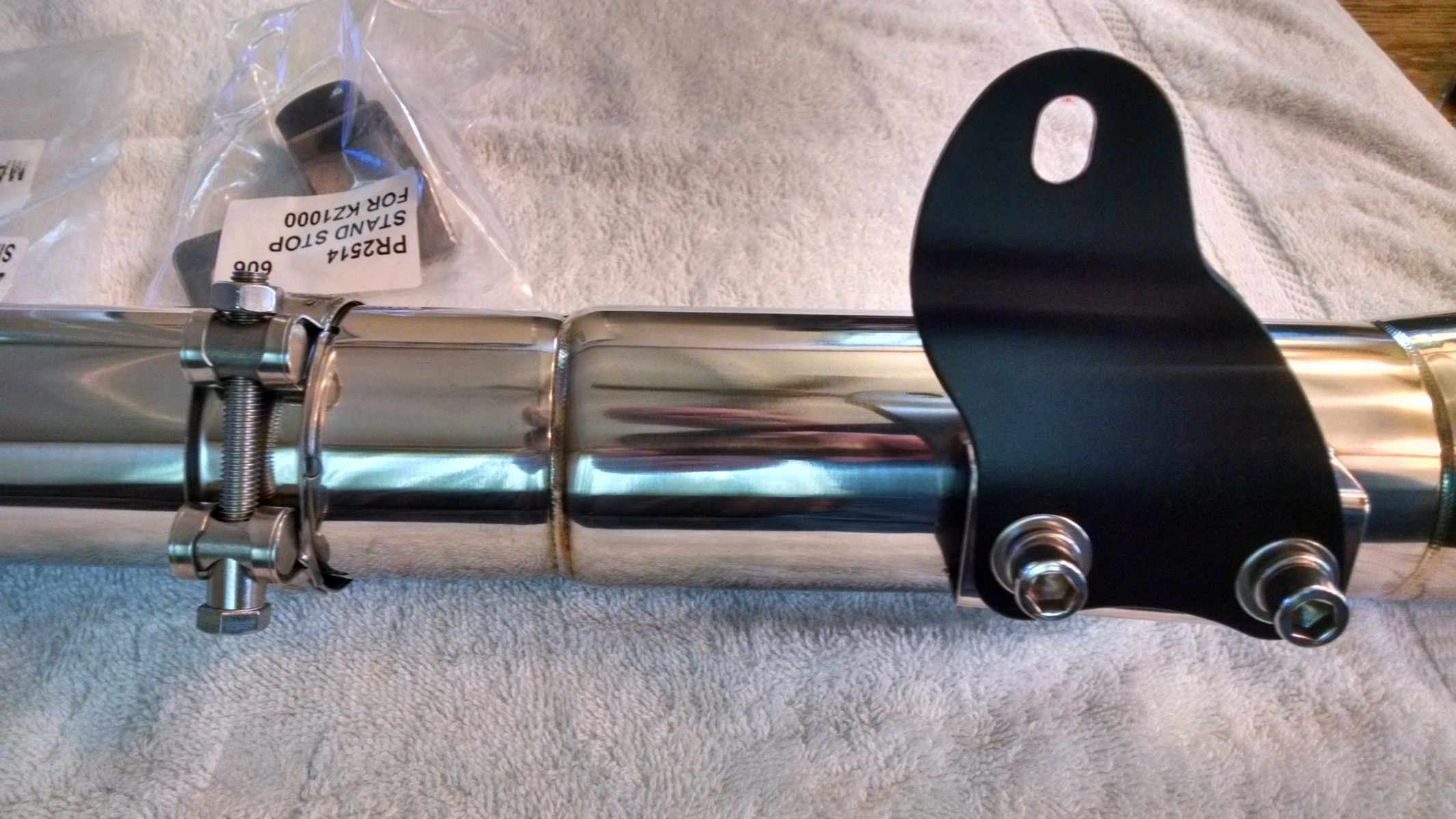

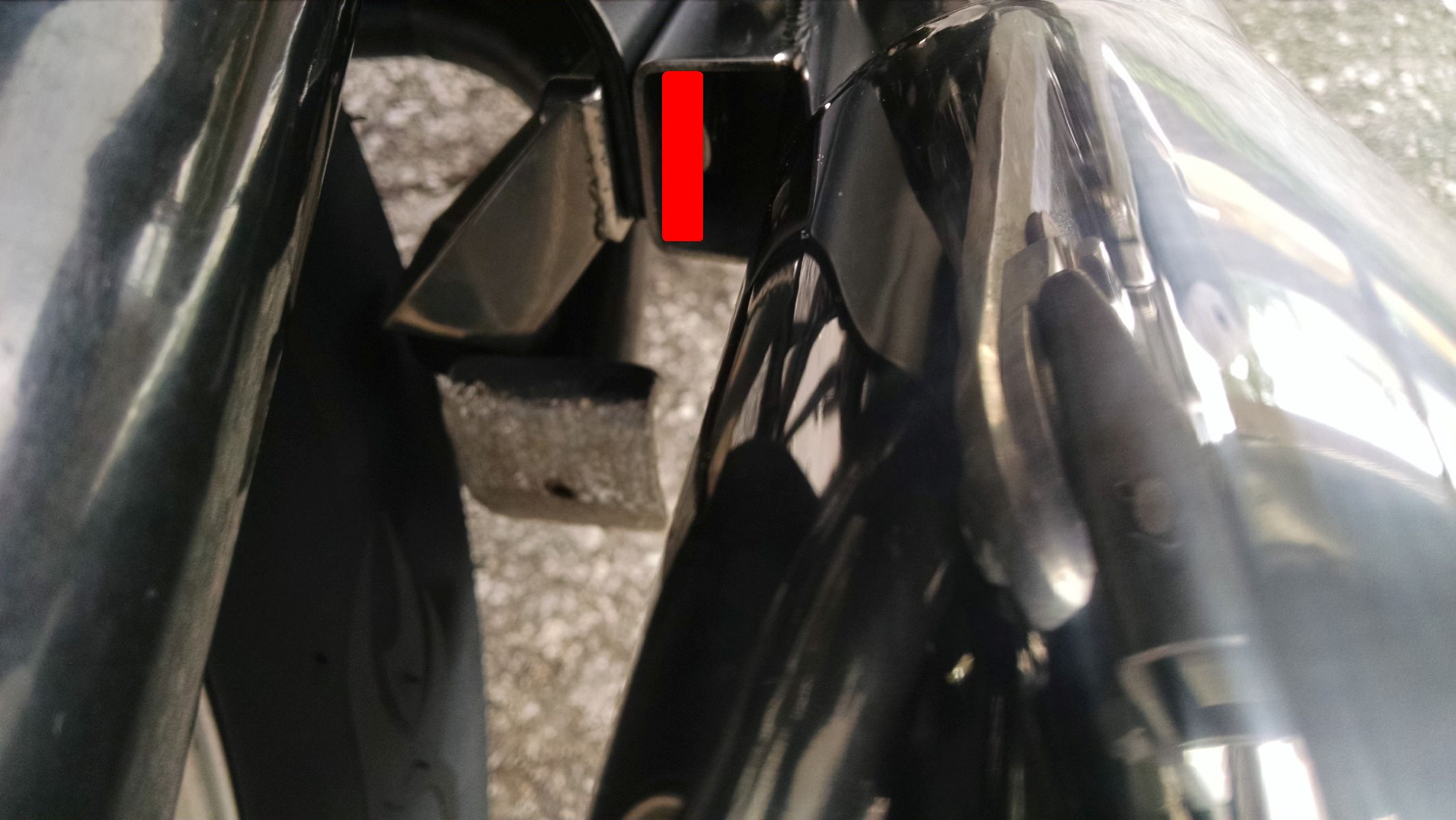

Have you try to bolting the stop for the center stand into the inside of the silencer bracket?
This will give you more distance to the rear tire and a better fitment to the center stand.

07 Oct 2018 15:08 - 07 Oct 2018 15:14I am all for moving it anywhere, but it sandwiches the silencer bracket to the silencer, I don't see any way to bolt it to the other side.
Note that the silencer bracket is installed backwards in this picture.
BTW, Delkevic has a bunch of pictures / installation / fitting guides online. The first link listed shows the baffles and internals to the silencer.:
delkevic.co.uk/fitting-guides.html

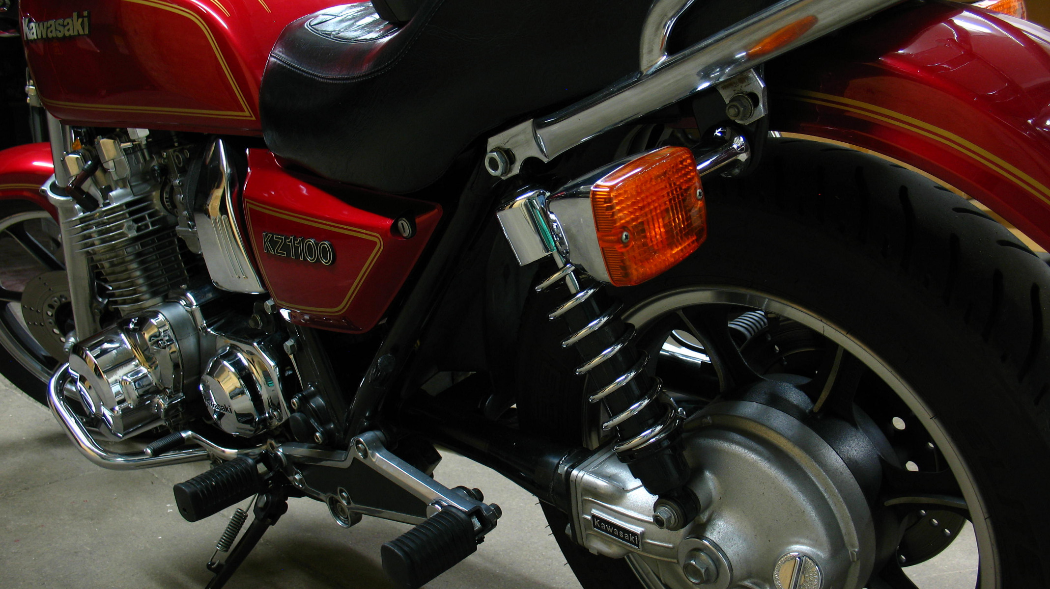

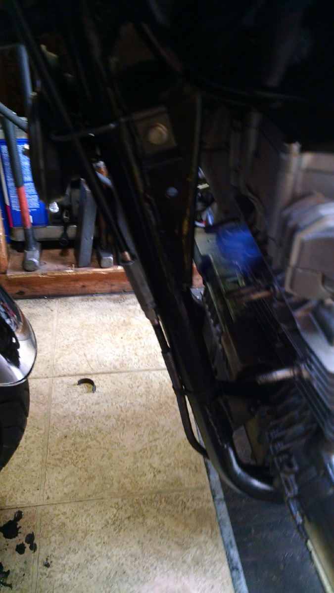

I didn't like the open hole in the left side of the bike at the rear muffler support, so I reinstalled the chrome bolt and rubber bushings by the LR foot peg. The big gaping open hole just didn't look right as you can see in the pic.

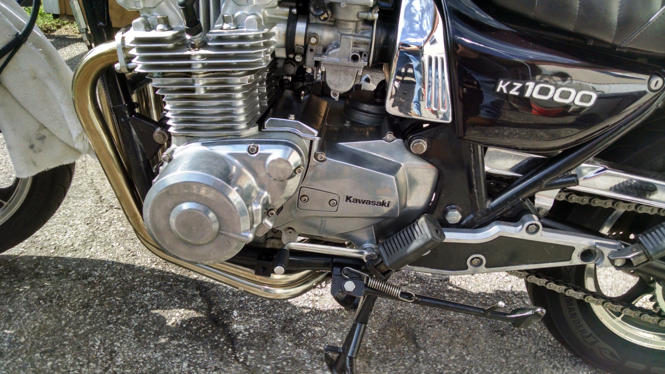

The V&H system utilizes the abandoned left muffler support bolt for the center-stand stop bracket included with the package. It is a bent flat steel piece that I keep on the bike, rotated up behind the muffler bracket until needed. Since it only takes a minute to sufficiently install the center-stand, I ride without the thing and just use it for winter storage and service.

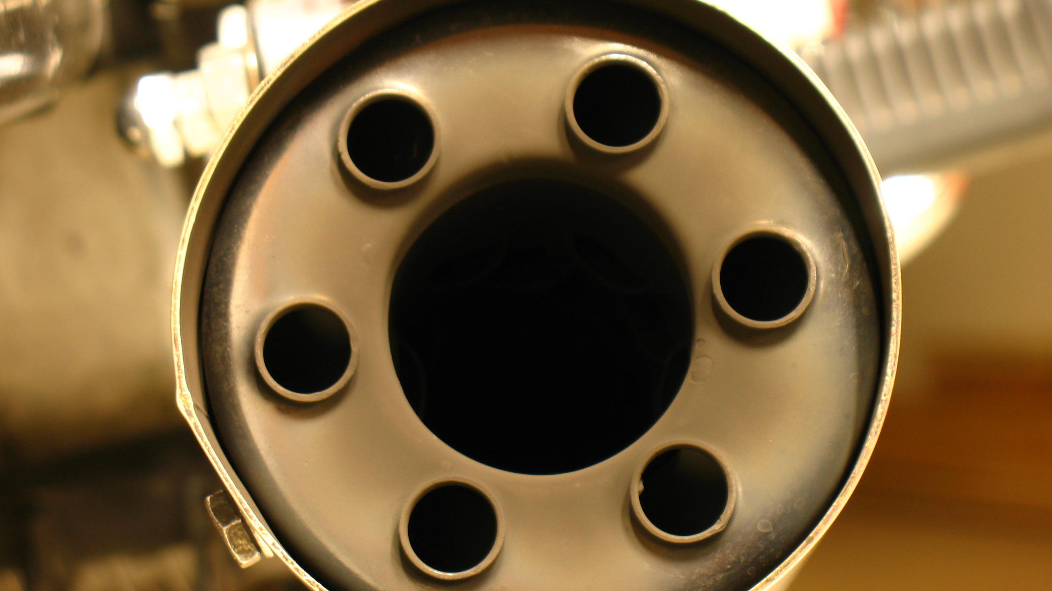

13 Oct 2018 12:20 - 13 Oct 2018 12:27old_kaw wrote: I found another baffle end pic on my phone. I knew I had taken more than just one baffle pic. There looks to be 3 dimples poking into the area where the center baffle is inserted that hold it centered opposite of the bolt end of the inner baffle, if that makes any sense? Check out the tiny weld around the rim of that megaphone.

I had considered using the open hole on the left side for the center stand stop, BUT.. I have one of those pesky roller chains on that side. I know it can be done, since the stock muffler had the stop under the chain, but with the rubber mount / bushings, I am going to bend up a different stop that's a little shorter, to bolt in the same place that it is now.

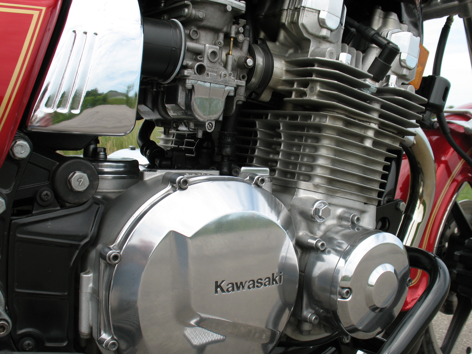

I can't get over how good your motor looks. Your whole bike looks fantastic, Dave! Did you chrome those engine covers, or did you just spend LOTS of time sanding and polishing them?

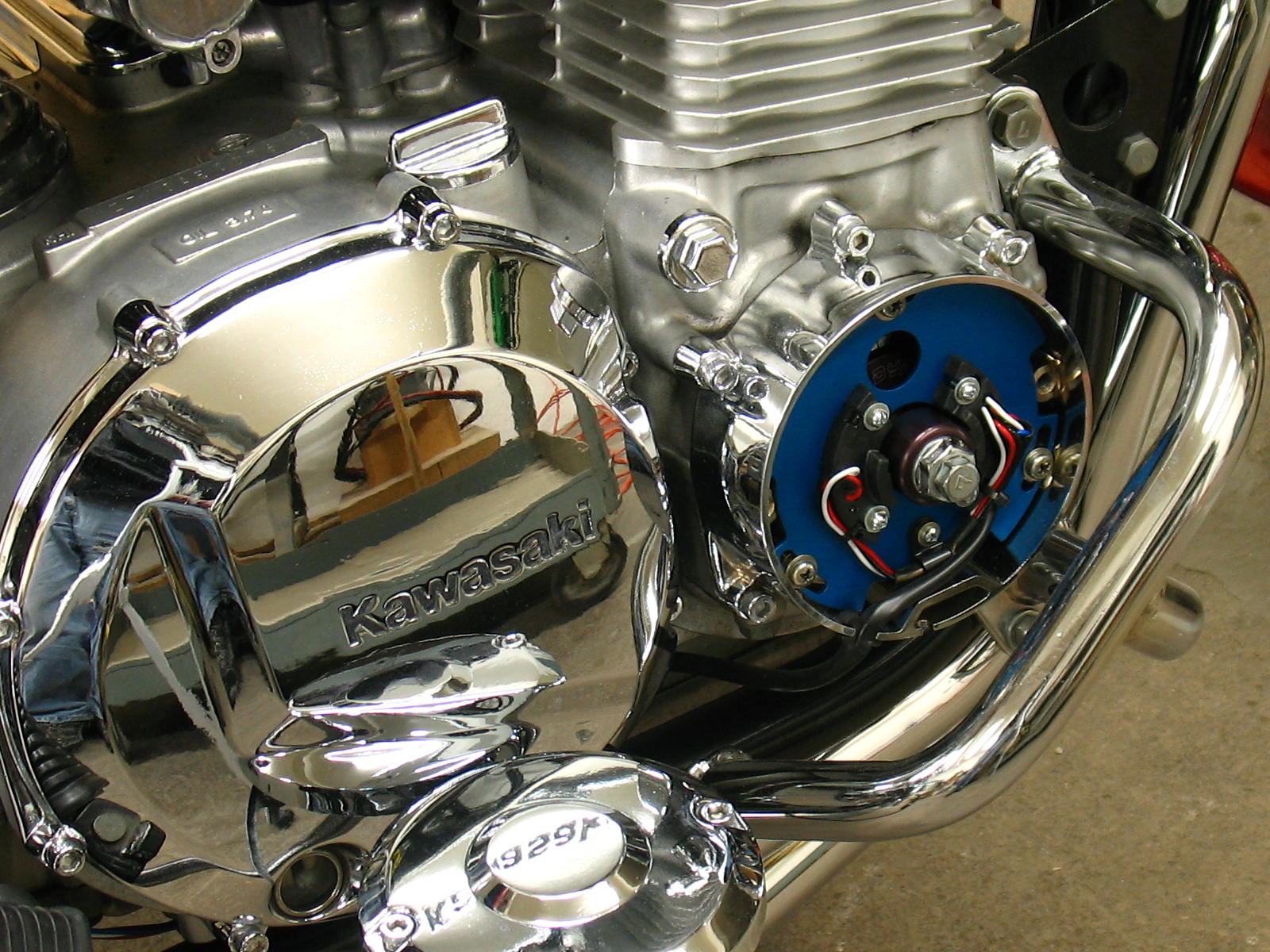

Regarding the chrome. All done after I found a chromed gear-case cover on ebay for $15 in 2012. It was just plain weird looking with that one piece of chrome, so I went ahead and had it done.
Found a guy in N. Carolina who did a pretty good job for a very reasonable price. Saved my arm from polisher's elbow... :whistle:
7/14/09
3/26/13
Made quite a difference, and I'd do it all again. Only problem is staying out of my pictures...:dry:
