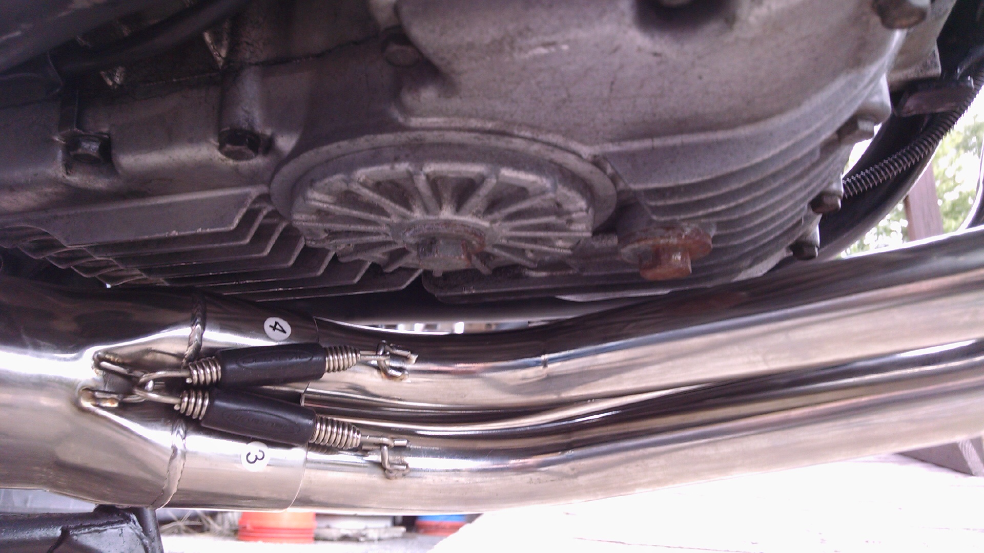

I like how the pipes fit tight up to the sump cover. That should help reduce the tendency of dragging the collector in low ground clearance situations.
When building my 750 I considered, but dismissed, the Delkevic header for my bike because the 650/750 pipe hangs down much lower than this 1000 pipe.

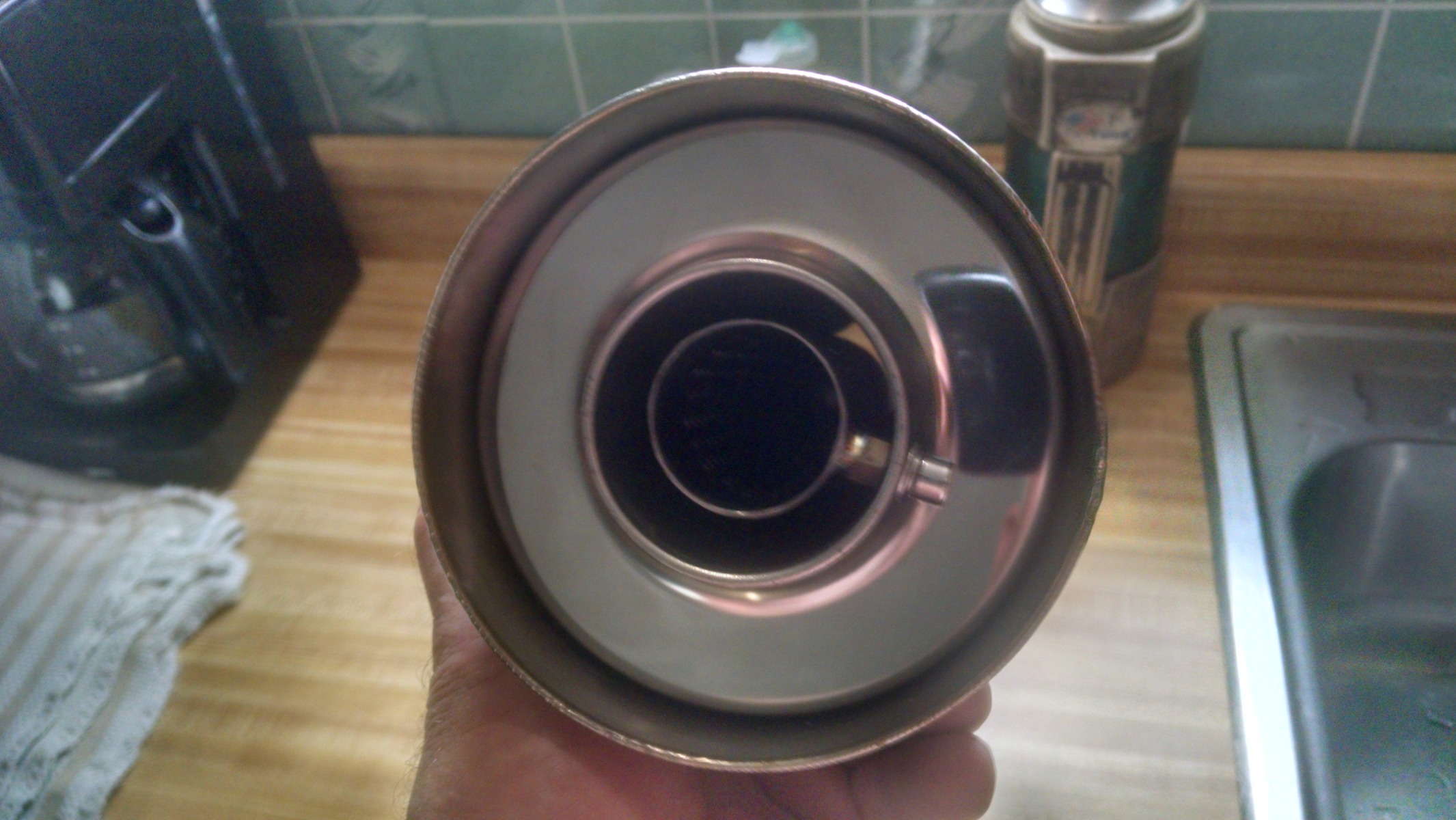

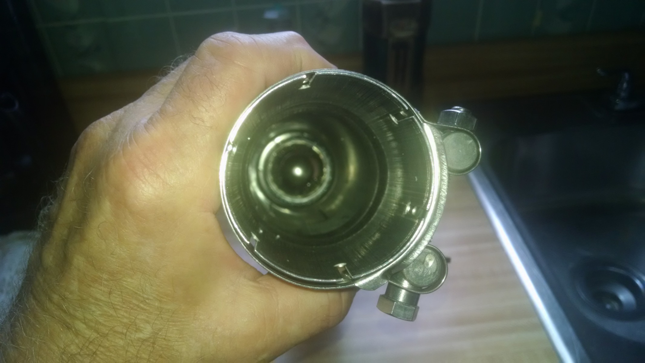

Here is a close up of the baffle end dave. It has an inner and outer baffle that can be removed progressively. The documentation list that no rejetteing is necessary if all baffles are left intact.
I tried several times to get a good pic looking into the silencer. This one was with the flash set to on, instead of auto.

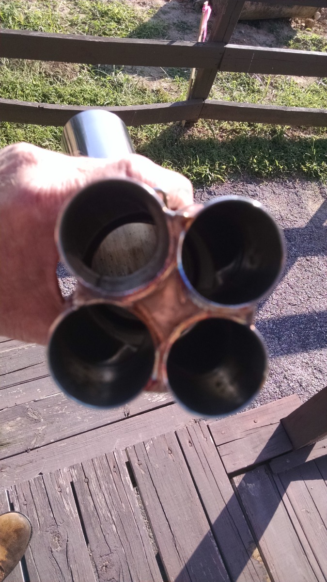

This is the pipes end of the collector. These welds are so tiny and articulate it is hard to capture it in a pic.

I found another baffle end pic on my phone. I knew I had taken more than just one baffle pic. There looks to be 3 dimples poking into the area where the center baffle is inserted that hold it centered opposite of the bolt end of the inner baffle, if that makes any sense? Check out the tiny weld around the rim of that megaphone.

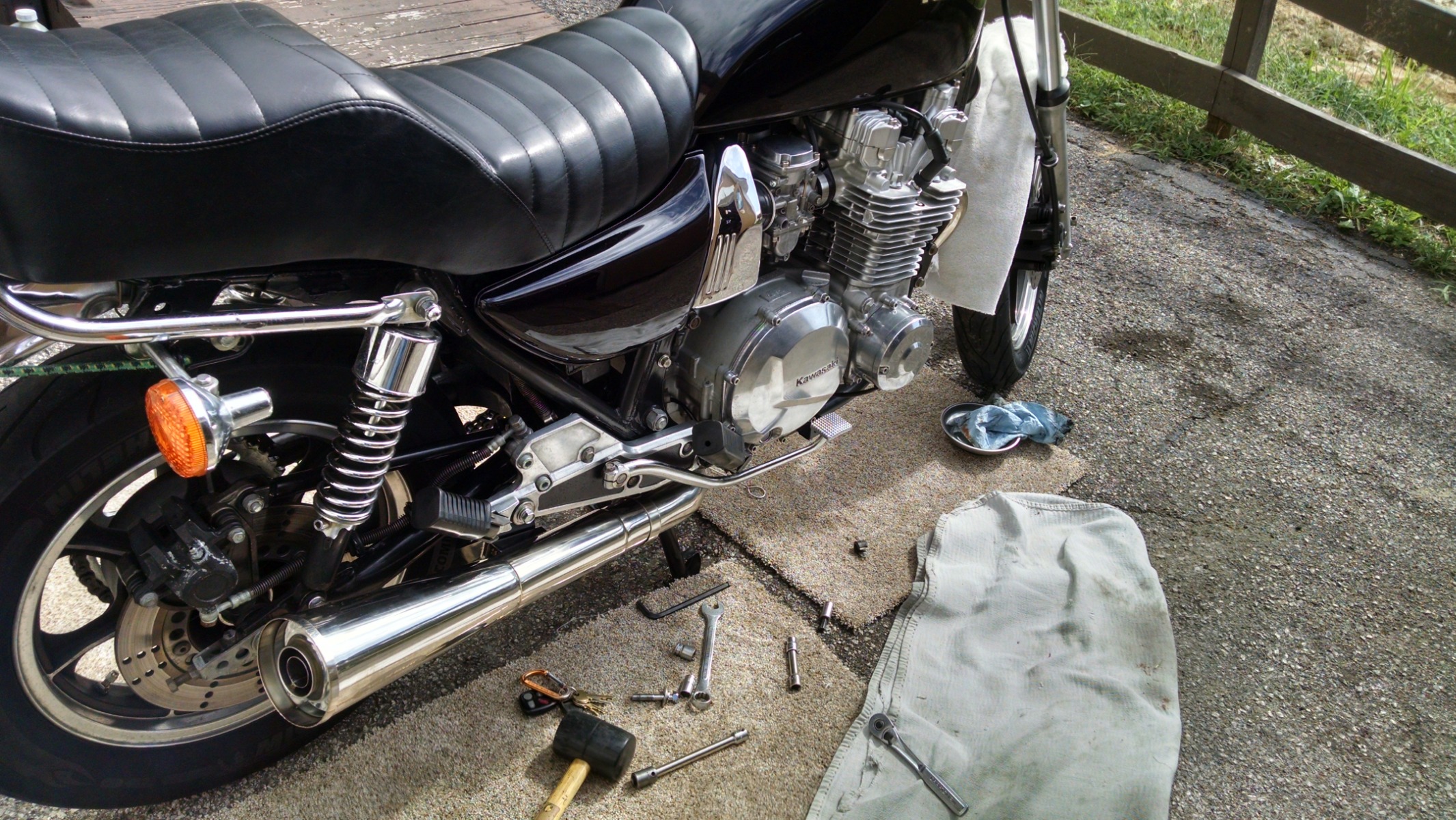

I got it installed today, Perry. There goes my stealth bike.. I seemed to pick up an "escort" within half a mile from home while on my maiden voyage. No more coming home quietly. It does have a deep "knarly / throaty " sound, turning my mild mannered, docile bike into the monster it always has been. (it was lurking under that quiet, muffled persona.)

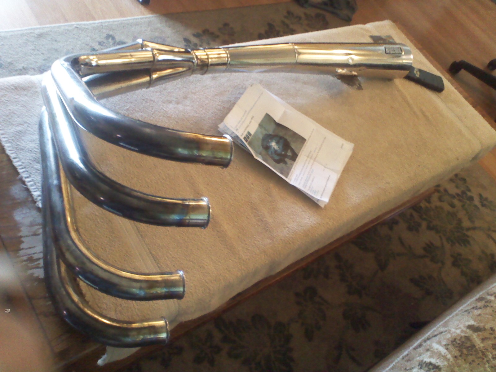

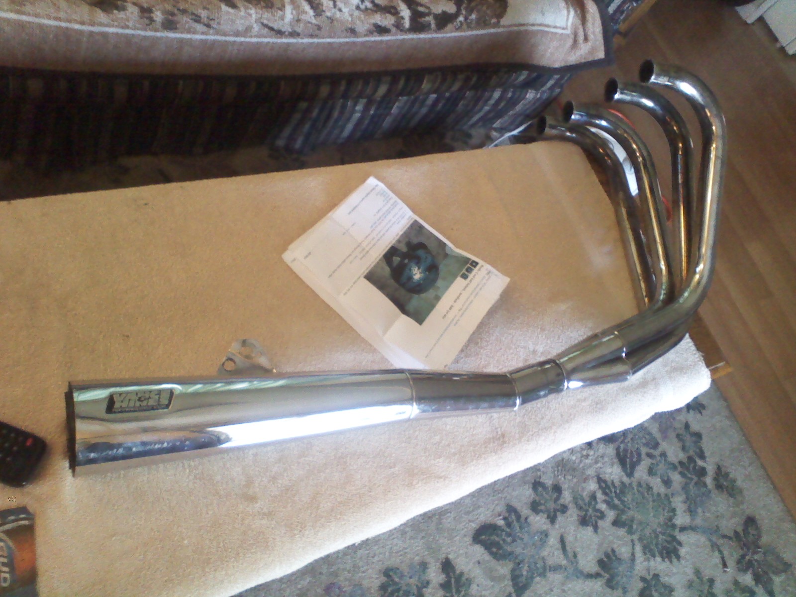

I went to a carpet store and picked up some carpet remnants from the dumpster a few weeks ago, to try and keep the pipes nice.. at least until I got it installed.

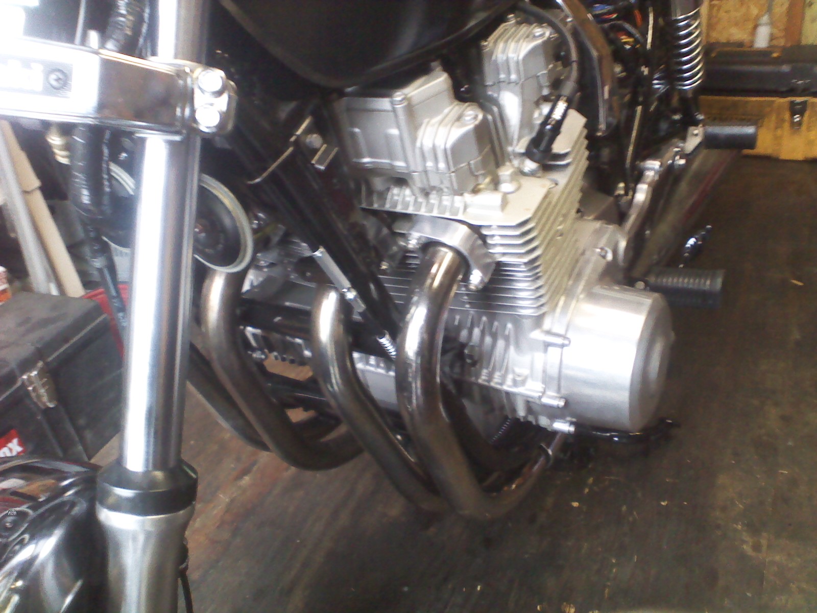

I removed the stock exhaust yesterday. I stuffed shop towels into the exhaust ports, sprayed on cheapo degreaser, then pressure washed the oil and crap off of the front of the engine and center stand. I let it dry in the shed last night with a fan blowing on it, since I couldn't give it the usual interstate 70 dry cycle.
All together, the install itself, after cleaning the bike up only took a couple of hours. It all went together / fit rather nicely. I reused my SS self lock nuts and flat washers on the flanges. They still look great after all these years on the bike. Note how the pipes are yellowing after only a few minutes of run time. Even with the yellowing they still look better than chrome / mild steel pipes turning blue.

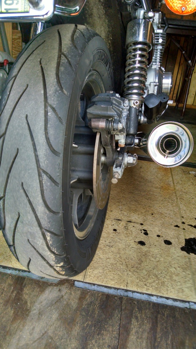

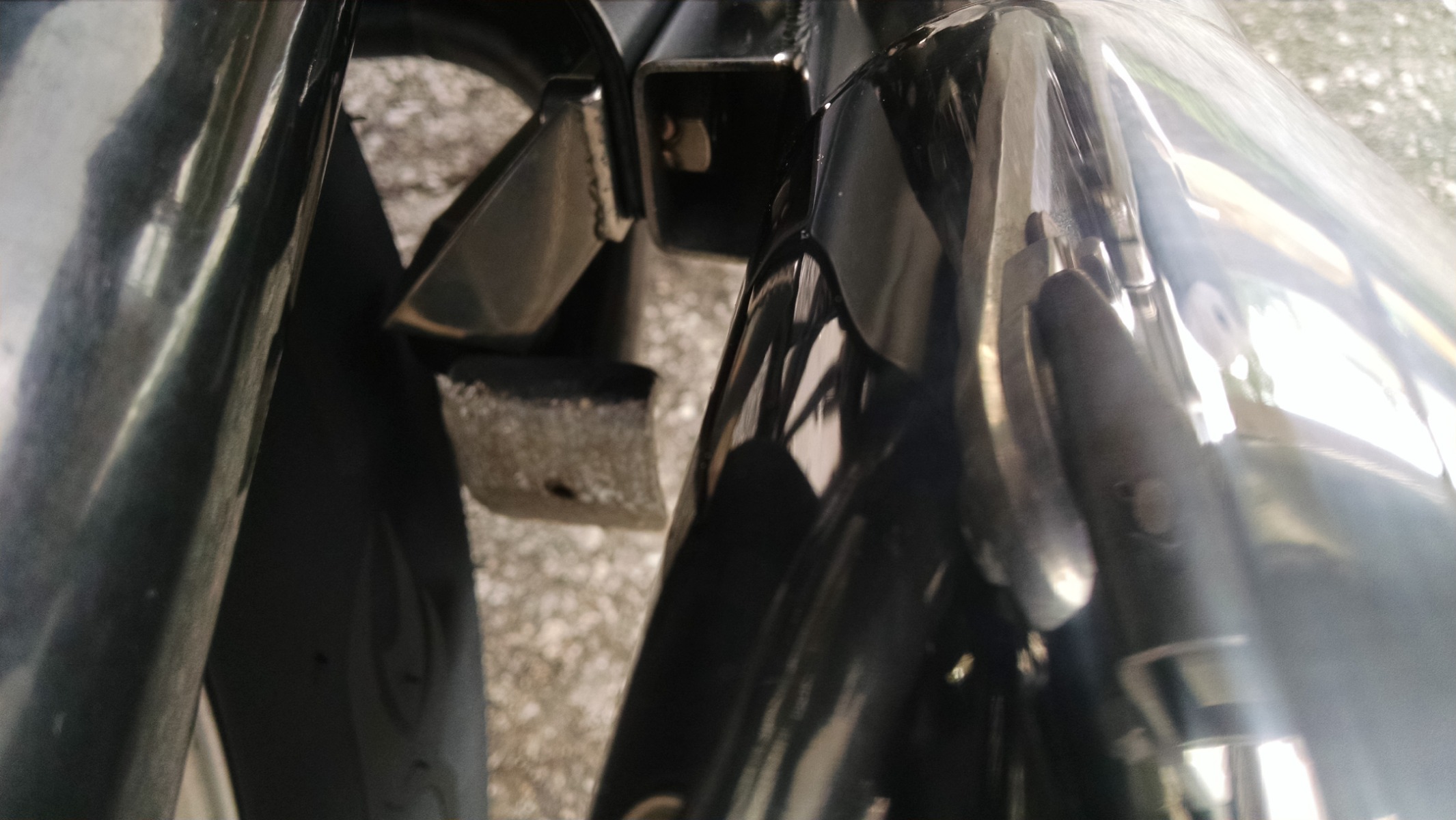

The stop for the center stand runs too close to the rear tire for my tastes. (aprox. 1/2") The pic looks like it is even closer, but it is not. I could have positioned it further away by bolting the silencer bracket to the outside of the muffler support, but that in turn would make the silencer stick out an additional ~1.5" from the bike. I may try to fabricate a different stop for the center stand.

I did get a video of the bike running, but don't see any way to post it without making a profile on YouTube. The rear view installed and running. As you can see, sticking out 1 1/2" more would not work.
